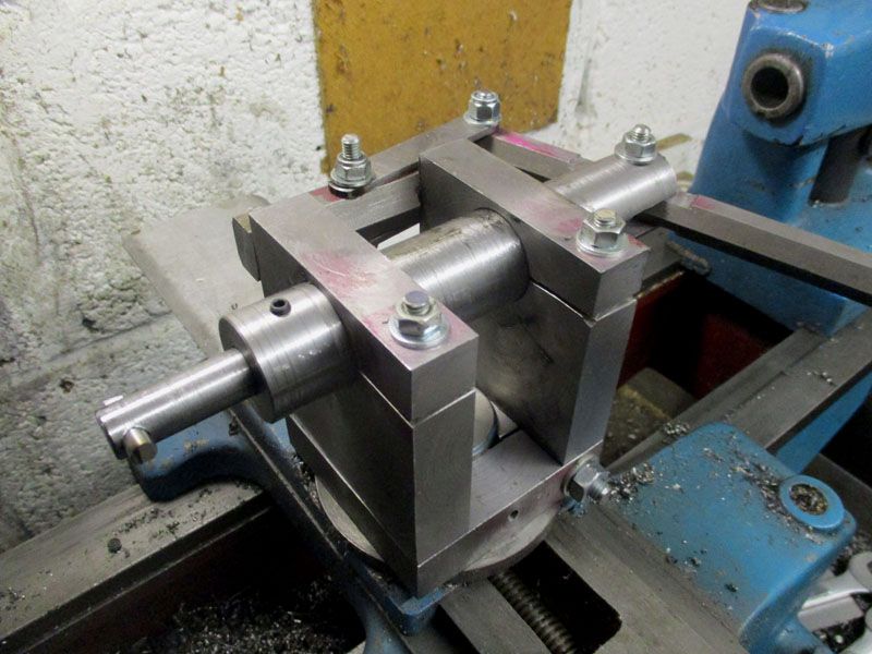

                                                #334240
                                                norman valentine
                                                  @normanvalentine78682
                                                  Earlier in this post I mentioned that I was making a slotting tool. It is now complete. I made it for my Raglan lathe and it mounts in place of the topslide. I found it to be very straightforward to use and on a test piece I was able to make 2 thou. deep cuts, without any sense of straining anything, and no dig-ins. When I tried slotting by racking the saddle backwards and forwards 1 thou was a strain and I had lots of dig-ins.
                                                  The actual cutter holder is interchangeable and can be made to suit the bore of the job in hand.img_0576.jpg
                                                  Edited By norman valentine on 28/12/2017 16:38:12
