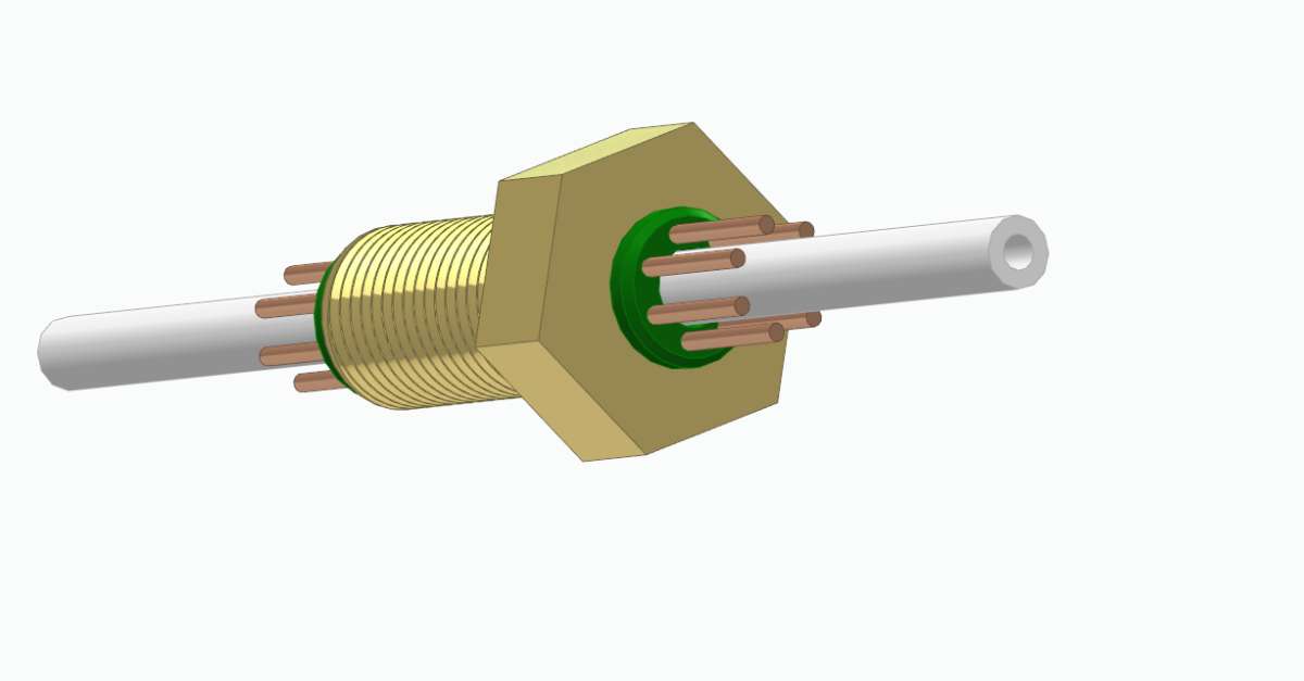

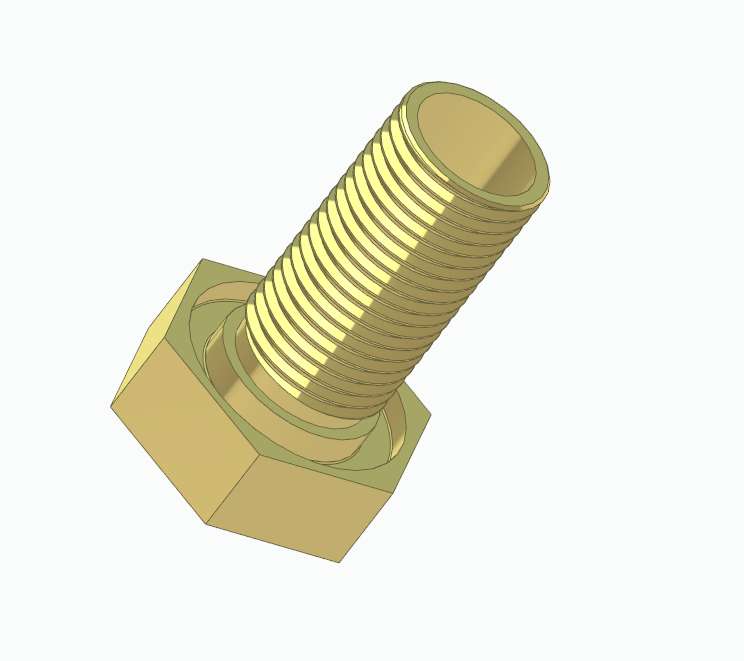

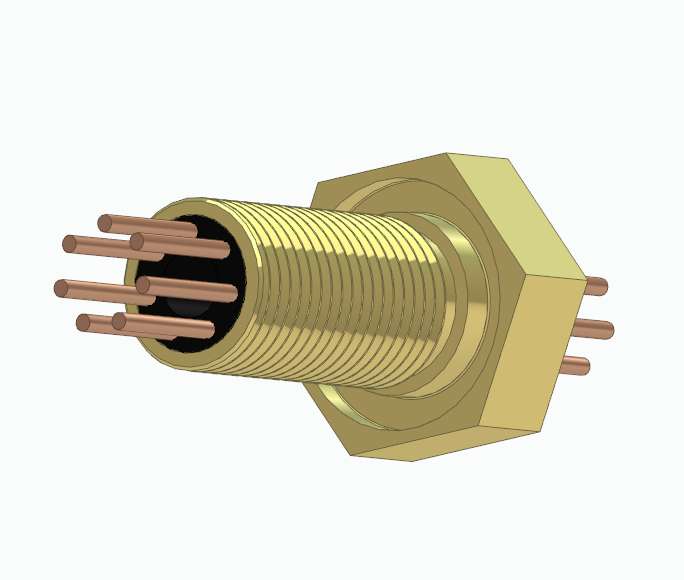

      This is my first stab at a bulkhead penetrator design for my pendulum clock.  The pendulum swings inside a vacuum chamber also containing some electronics.  Although unlikely in practice because my pump isn’t good enough, assume the vacuum is 0mb. (-14psi).  Leaks must be minimised because tiny pressure changes serious affect time-keeping, and this hopes to be a first class precision clock.
      The penetrator will be screwed into an M10 x 1.0 hole in a cast-iron base. The bolt head is outside at atmospheric pressure (1bar, +14psi)
      The Brass bolt-body, 25mm long, head 12mm Across Flats.  Note the slot for a Nitrile O-Ring:
      Screenshot 2025-11-17 215110

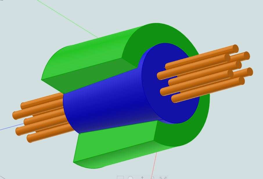

      The centre hole to be filled with Epoxy or other sealing compound, with 7 uninsulated copper wires spaced around a 4mm exhaust pipe:
      Screenshot 2025-11-17 215239

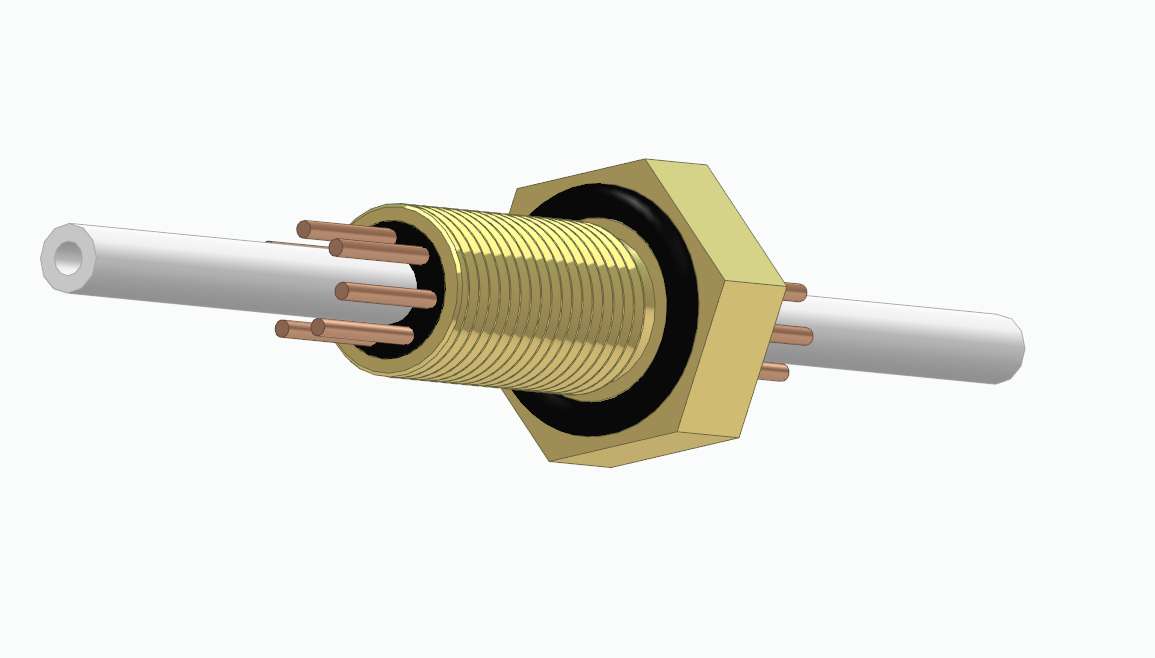

      Showing the exhaust pipe, which is 4mm o/d, 2mm i/d PTFE.  The 4mm diameter connects to a commercial fitting.
      Screenshot 2025-11-17 215352
      The copper wires will be bent inside and outside to facilitate connecting up.  To prevent short circuits they will be sleeved by insulating rings (shown in green):
      Screenshot 2025-11-17 215449
      Rear view:
      Screenshot 2025-11-17 215724
      Questions;
      1. Is this design sound, or how can it be improved.
      2. Is epoxy suitable for the potting, or something else.
      3. I propose to use plumbers sealant on the thread.  Is that sensible?
      4. The o-ring groove is a new to me challenge:
        1. Width 2.25mm on a 12.60mm radius, depth 1.60 to 1.65mm
        2. Bottom edges rounded
        3. Finish Ra 1.6um or better
        4. Target squeeze 0.4mm compression. This done by leaving the centre of the bolt proud by 0.4mm.  Is that how it’s done?
      5. How would you:
        1. make the o-ring groove, especially the finish
        2. fill the centre with no bubbles gloop without disturbing the pipe and 7 surrounding wires.
      6. Any objection to using enamelled magnet wire rather than bare copper?
      7. Ideally the wire section would be square.  Anyone know of a source.
      Thanks in anticipation,

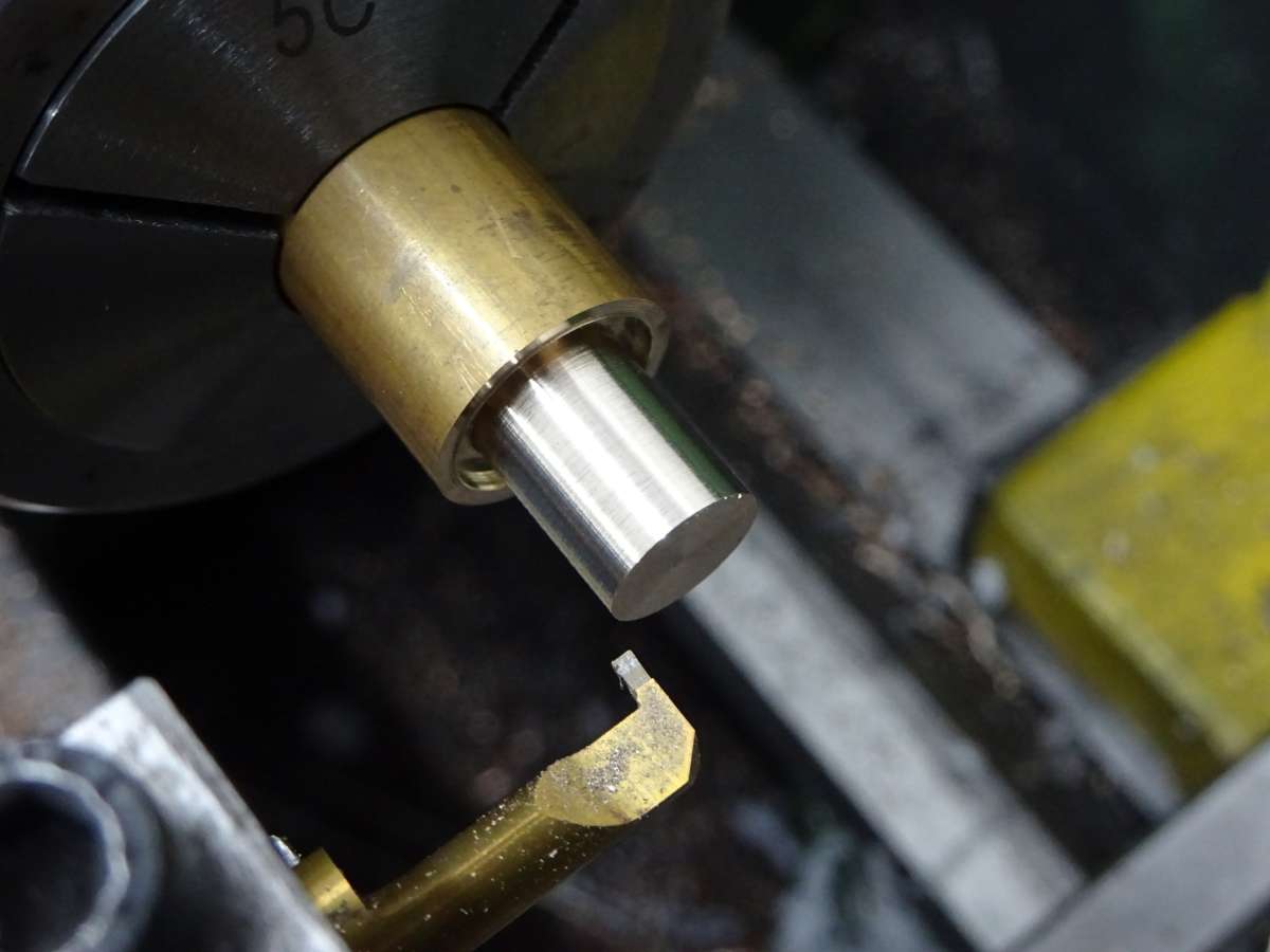

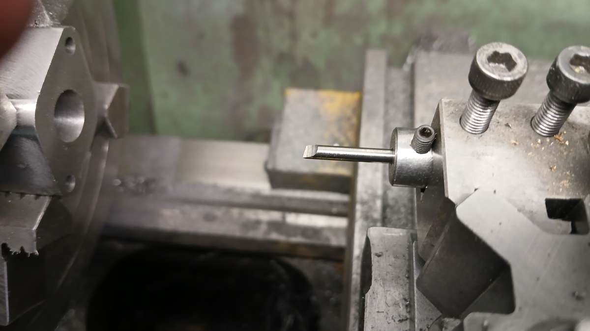

                  If you are worried about making the O-ring groove on the bolt, consider putting the recess in the mating part and just aiming for a good finish on the bolt sealing face. Or use a Dowty washer?

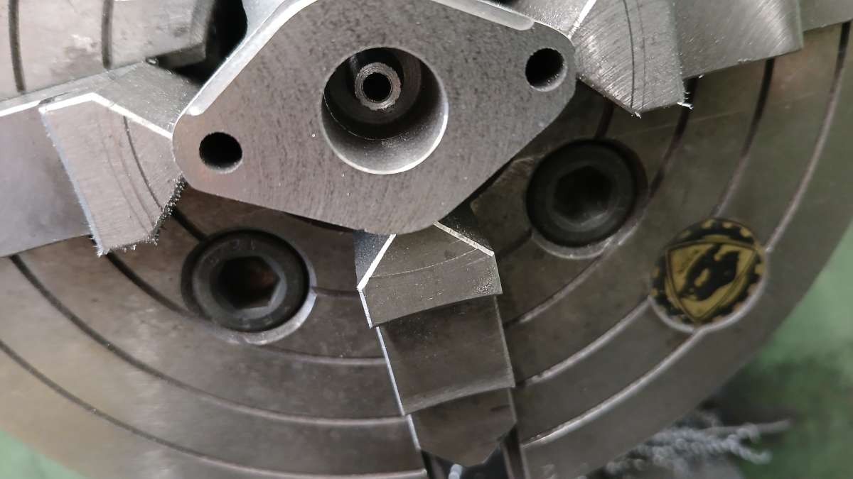

                    Cut a recess around the M10 hole for the O ring as it will be a lot easier. Keep a plain 10mm shank about 2mm long so the ring is not against a thread.
                    Otherwide gring a tool to cut the recess in the bolt, probably a cranked one as straight would be a bit long. Or bore a 10mm clearance hole in some Silver steel and make a hollow cutter like  a Rotabroach type.
                    DSC02644

                    Your sizes are wrong as 12mm AF won’t leave room for an or ring around the M10 thread

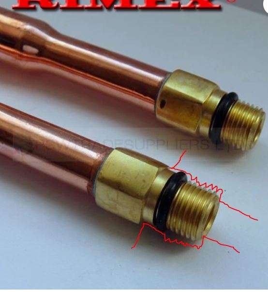

                      This sort of setup for the O ring where the seal is radial would be easier to machine as if you can’t turn and bore a decent finish then the job is a non starter.

                          As noted by others PTFE is about the worst choice for the tube. Nothing will stick to it and it will collapse under pressure. Use metal.
                          Old fashoned sealing wax is much better than exoxy for vacuum sealing.  If worried about strength use a plug of wax at the vacuum side backed up with epoxy.
                          You need to put a step or taper in the inner diameter to ensure the sealant can’t be sucked through and pressure increases sealing.
                              The size and shape of the mating part is awkward.  The bolt sits in a recess under a cast-iron block, the base, that’s much too big for my lathe’s chucks.  It’s a faceplate job, and reaching the surface requires a fully extended cutter. As the surface is sloped and very hard, the cutters will chatter.  I’m intimidated.    In contrast, easy enough to mill the recess with a carbide cutter, but not the groove.  Simpler, I think, to groove the bolt head because the part can be held in a 3-jaw.

                              3D print something like your green spacers to hold the wires while potting, if you apply a little tension they will remain straight.
                              Yes!!!
                              That’s the plan.
                              Excellent! I hadn’t thought of cranking or a Rotabroach.   Thanks for the photos too – very clear.
                              Typo, actually 16mm AF.

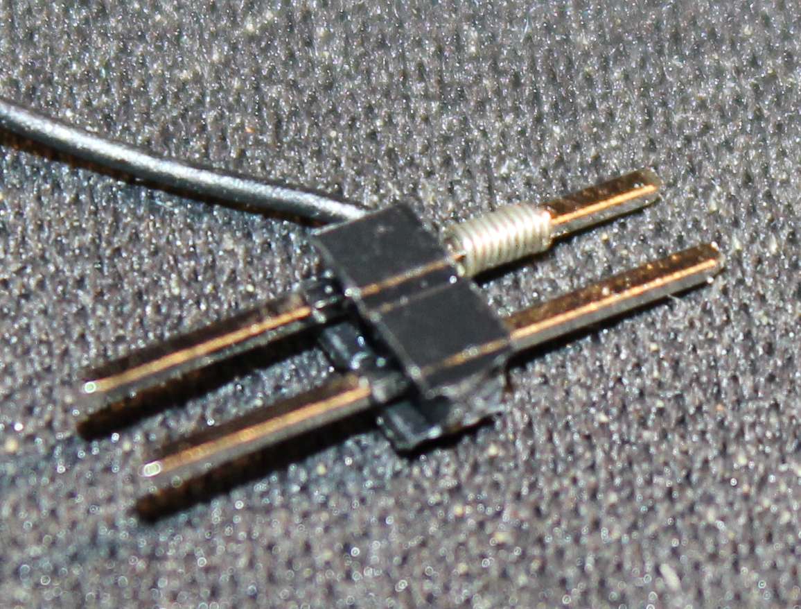

                              If anyone is interested, square wire is preferred to round cos’ I is a wire-wrap fanboy.  Avoids soldering, simple tool, though not suitable for everything.
                              Apparently wrapping the wire around a square pin increases contact pressure enough to create tiny cold-welds on the corners, improving reliability.

                                                At the moment the design calls for a solid PTFE pipe passing through potting compound.  Why PTFE? Only because I have some and it fits a stud connector I already have, and it can be routed as ordinary flexible tube.

                                                      Squish the blue bit into the green bit with a nut or plate.
