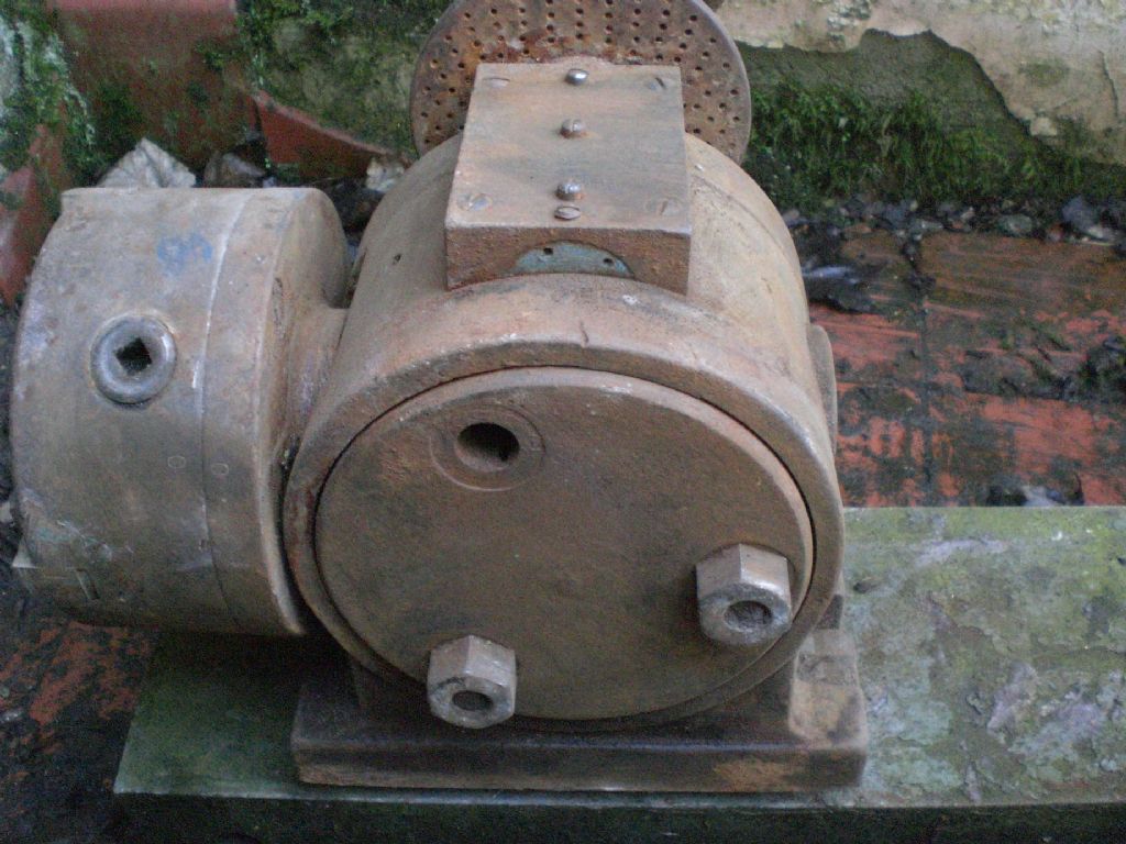

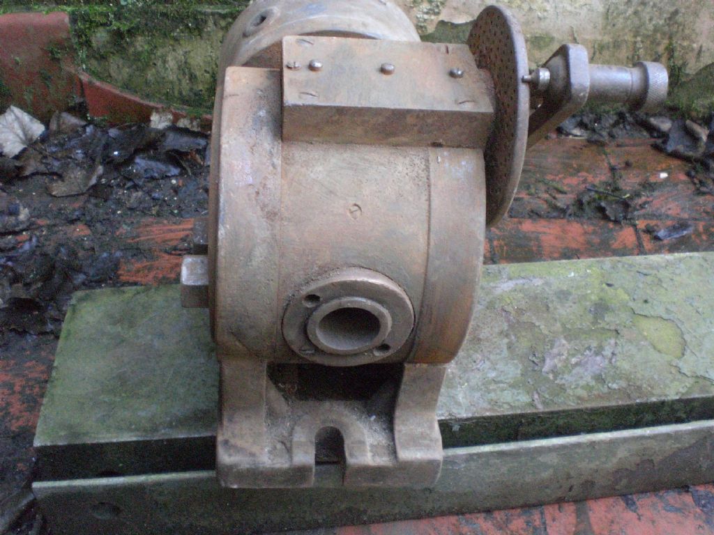

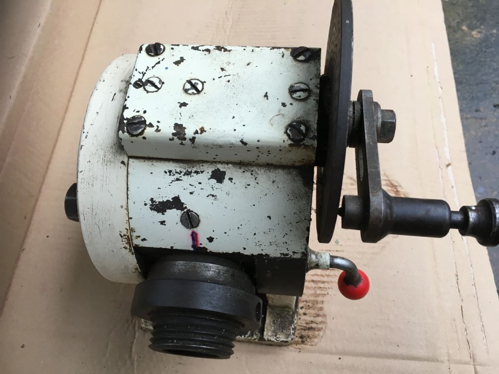

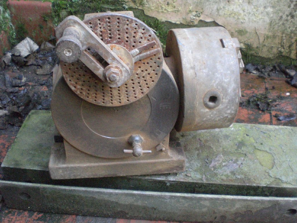

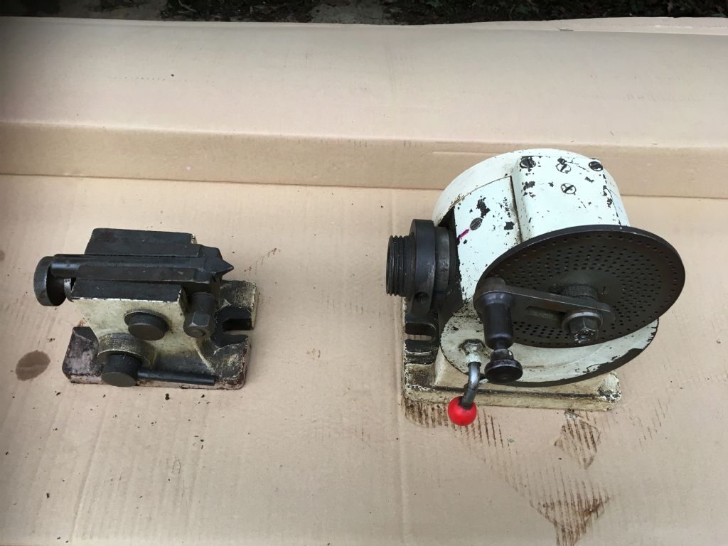

      img_0878.jpgimg_0875.jpgHello does anyone know what make this Dividing Head is? Thanks.dscn0705.jpg

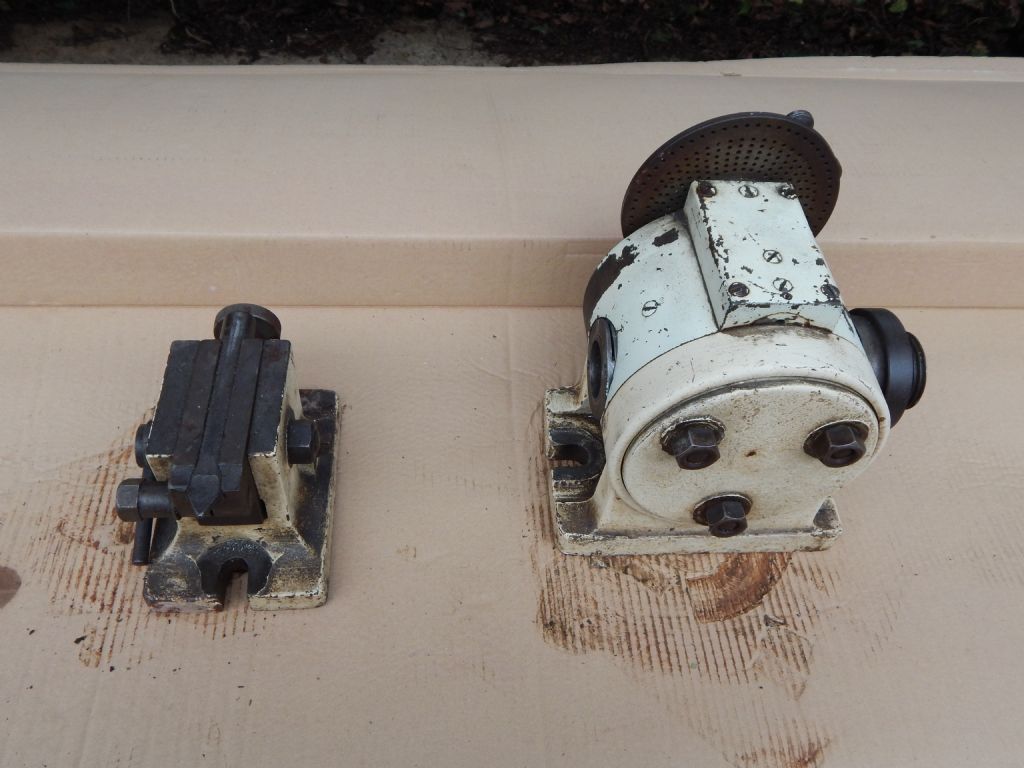

          Good news that you have a Tailstock with it.
          Do you know the ratio?
          If it is 90:1 the division charts for the Vertex HV6 will probably be useful. But unless recent, they do contain errors and omissions. Corrected charts are available on here. Ask Neil how to access them.
          Howard
          #446016
          noel shelley
            @noelshelley55608
            Hi John, whilst the makers name may be interesting, if you want to use it, it is simple to find out the ratio and then any good engineering hand book will give you the charts. If You want to know more come back to me. I will get a book out. Noel

              Shame the quadrant seems to be missing

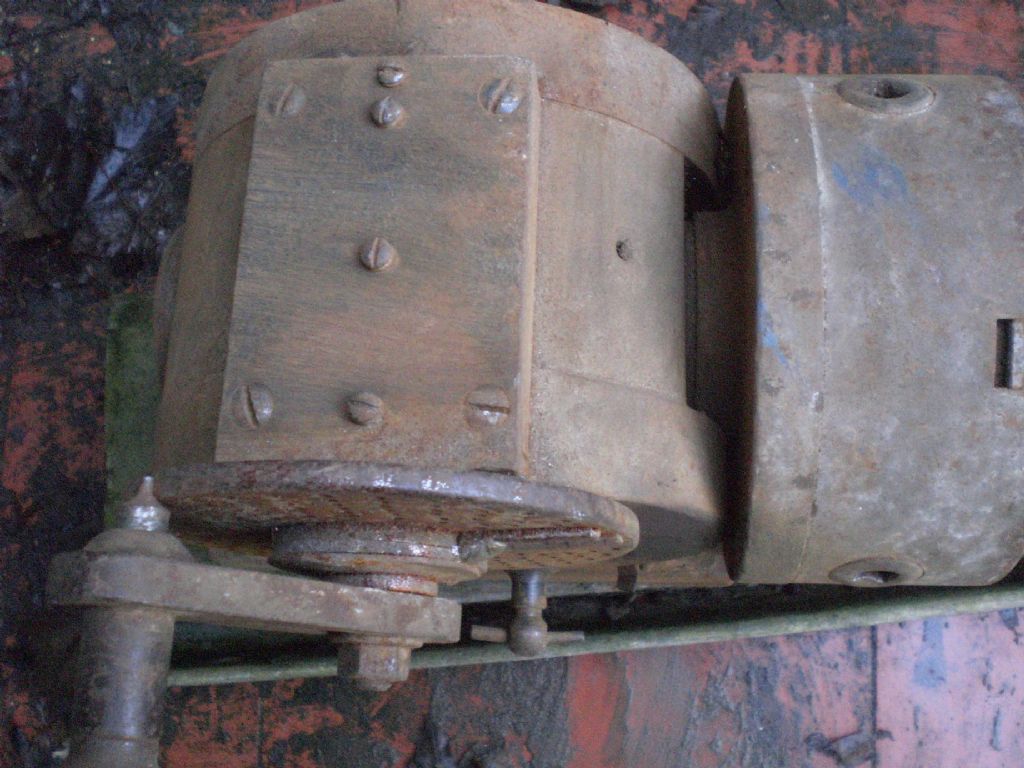

              Nicholas Farr
                @nicholasfarr14254

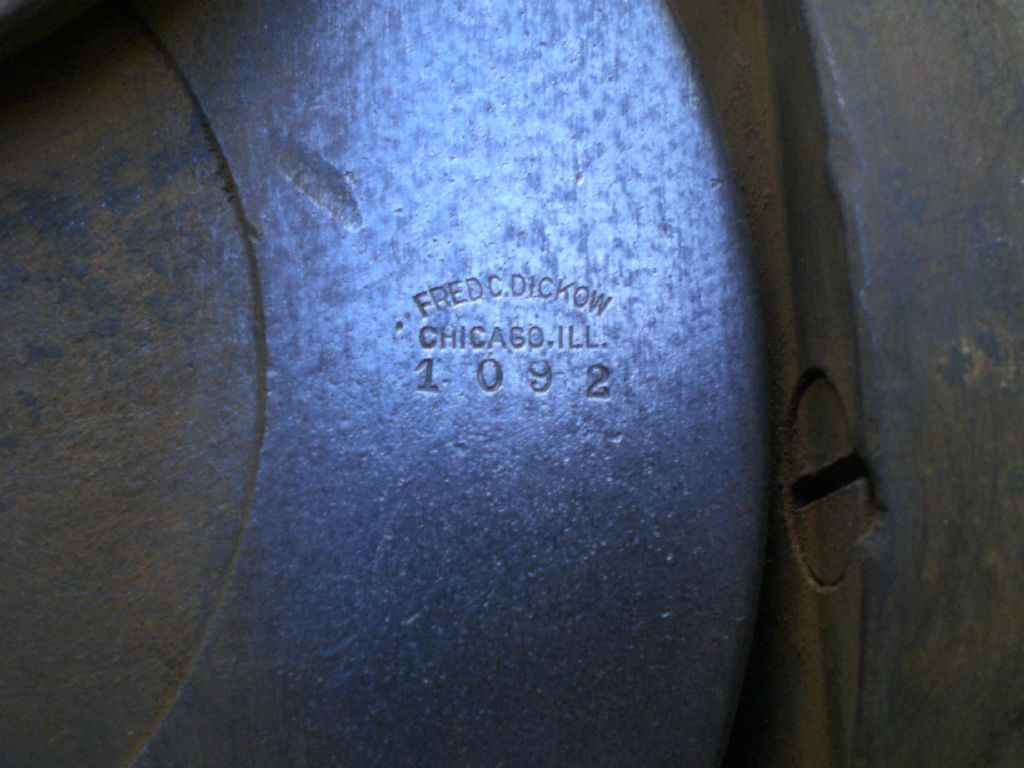

                Hi John, I have one that looks very much the same, apart from being a bit rusty, that is. Mine has the name of Fred C Dickow, Chicago ILL. with the number 1092
                Hope this helps.
