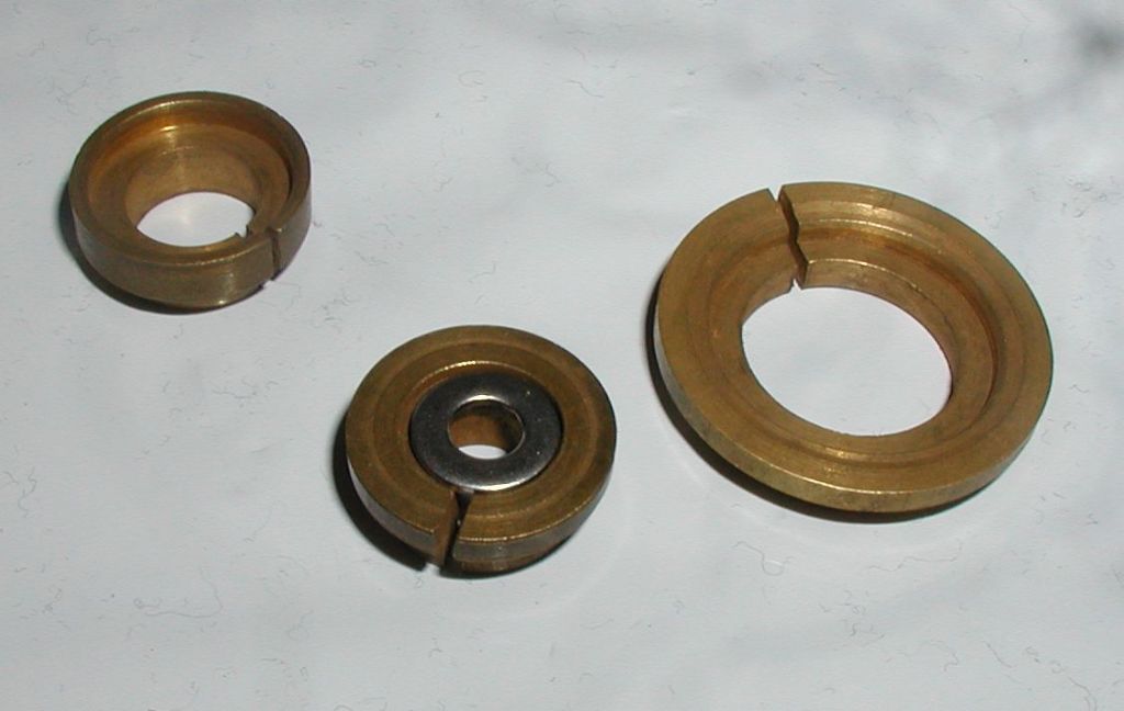

            Make a small split bush drilled 4mm and with a shallow recess to suit the washer OD, this will grip the washer and keep it true.

              Hi Steve, Jason has discribed the photo below that I have just uploaded, i.e. a split bush with a recess to fit into your collet chuck or three jaw.
              Regards Nick.

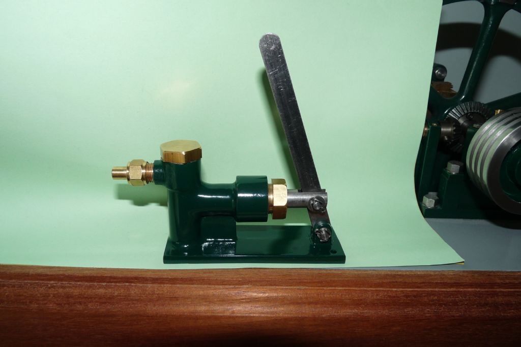

                  Stuart Water Pump
                  Thanks for the responses, this is what the washers are for. If you pick this image up from the album and zoom right in, I think it shows a plain 4mm washer as lacking a bit of finesse (see top washer) compared with the lower washer, which is 3mm drilled out to 4mm.
                  I think the easiest way to do this then, is simply to make a washer from stainless bar.
                  Thanks for the help.
