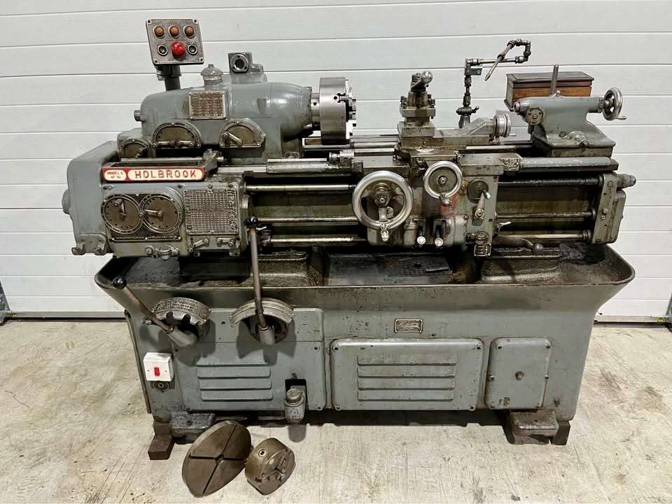

      Good Afternoon,
      I am buying a 3-phase Holbrook C-10, and shall be running it from a 240v 50Hz domestic supply.
      The current plan is a Transwave MT-3-DD, to create the 3-phase to run the machine.
      My question is can I introduce a variable frequency in to ‘the loop’??
      The Holbrook, particularly in the higher speed ranges has quite a large jump; 1492 to 3000rpm, which I would like to be able to add some additional speed flexibility in to – if it’s possible??
      I can re-wire a 13amp plug, but my electronic expertise beyond that is non-existent… although I am picking up a little..
      Many thanks in advance for any advice/help… 😊🇬🇧👍Image

            Robert Atkinson 2
              @robertatkinson2
              No, you cannot use a Transwave rotary converter and a VFD together. To do so is a bit pointless even if you could.
              The transwave is designed to drive inductive (motor loads). The VFD input is a rectifier or solid state power factor correction circuit.
              You should get a single to 3 phase VFD. If the motor can’t b connected for 240V (Delta) you will need a step up version to get full power.
              Note the Transwave MT-3-DD needs 25 amps input current so you would probably have to get a dedicated 32 circuit run into your workshop if you decide to use one.
              Robert.

                flatline
                Best to join the Holbrook group on Groups io for experienced advice on powering the C10 from a 240 volt supply.
                The excellent 2 hp (nominal) 3 speed motor fitted as standard is a notorious current hog during start up and run up. It’s suggested that considerable oversizing of a Transwave unit is needed for good results, apparently the MT4 4 kw / 5.5 hp Transwave rotary converter can struggle to bring things up to speed so a MT5 5.5 kw / 7.5 hp is the safer option.
                If you do go for a Transwave unit make sure that you have a good “stiff” utility supply and decent size cabling with well made connectors. I’ve encountered set-ups where Transwave units have struggled due to limitations on the utility side. Mostly out in the county where supply is via overhead from pole mounted transformers but my own, somewhat urban area, supply was on the iffy side. The guys inspecting it were not impressed with what had been done to make my house connection. A redundant apparently still connected, open ended, lead sheathed cable ending in the vicinity of my soak away was considered somewhat dubious.
                I seriously doubt that an affordable VFD would be able to cope with that motor. Whether as native variable speed drive or modified for plug and play 440 v nominal three phase as done by Drives Direct. The high part speed current demands would likely collapse the internal DC bus.
                Changing the motor for something more supply friendly is generally considered impractical due to the tight integration with the three speed gearbox. I believe it has been done by replacing the whole unit with a conventional VFD driven motor to get the appropriate speed ranges and single speed countershaft to get the dive lines in the right place. Besides the mechanical changes the wiring and control surfaced had to be gutted and re-made.
                Clive

                  Robert Atkinson 2
                    @robertatkinson2
                    I was not aware that the existing motor is multi-speed. From Clive’s comments it looks like it has issues.
                    Given the cost of a large rotary converter and the required supply I strongly suggest you consider a new modern 2HP motor and a VFD.
                    Robert.
