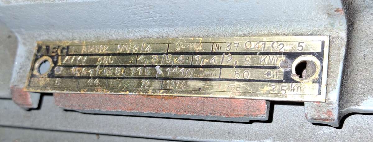

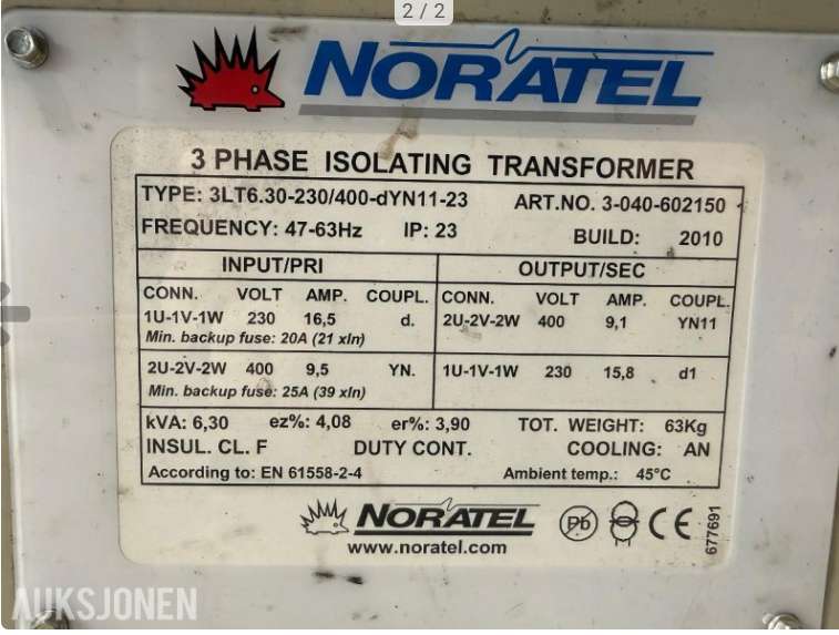

      My 380V lathe shares an 220X415V inverter with my 400V mill. The are not operated at the same time… ever.
      I see that there are 220 X 400V 3 phase transformers for sale on the local web.
      Is there any reason not to use a transformer for 400V 3 phase in my shop? There have been many threads on this site regarding inverters but few on transformers for step up.
      I attach photos of a transformer nameplate and the lathe motor nameplate.
      Thanks in advance

                        If you have 3 230V to neutral phases you have a 400V 3 phase supply. Your motor should run off this directly.  The Phase to phase voltage is 1.73 (square root of number of phases, 3 in this case).
                        The transformer is Star to Delta so used to run a 230V delta motor from your 400V star supply  or provide 3 independent 230V isolated supplies.

                                  Having understood what you have. Why on earth do you think that the 3 phase transformers would not work to give you a 415 volt 3 phase output. It is a no brainer.

                                    Yes, the transformer will do the job perfectly. With sufficient capacity it’ll run the lathe and the mill at the same time. (If you can run between the machines fast enough 😀 )

                                        Oh dear… Well a bit late, but I’d say in answer to the question, “is there any reason not to use a transformer…”:
                                        Both the lathe and mill would surely benefit from being hardwired to their own VFD. So I’d spend my money on another VFD and some pots/switches, to take advantage of all the features of VFDs – soft start, braking, reverse, speed control, low speed torque boost…
                                        My lathe and mills are all run on VFDs, and even if I could get real three phase in, I wouldn’t change that.
                                        Even better, if your motors are easily configurable, set them up to run on 230V and buy two standard AT1 VFDs. As I understand it, the step-up VFDs like you have are often normal ones modified with a voltage doubler at the input, so perhaps pushing the design a bit.
