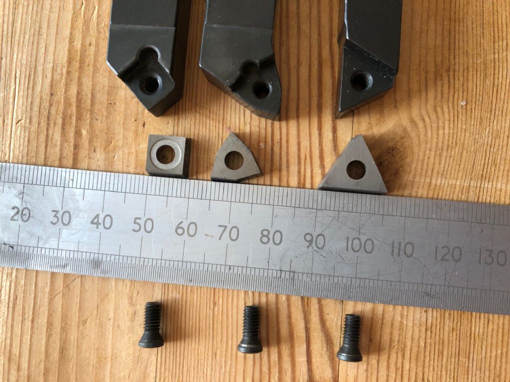

      Hi All, new to the forum and indeed the world of turning & Milling.
      Entering retirement after a lifetime of electrical engineering I decided to get myself a lathe to pass the time and give me something to learn. Being a keen Car mechanic I think if Id had one 30 years ago it may have paid for itself by now, but as it is it's early days to say how much use it will be. Ive been holding out for second hand unit for over a year but with a lack of anything that fitted expectations, but more importantly my shed, I bit the bullet and bought a new Warco WM290V and have had it a month now.
      Had a few teething issues with it which I'll probably cover in detail in a different review for the benefit of others either thinking of getting one or having similar issues but in short, the change gear table on the machine was different to that in the manual in several areas, there is a reference line missing from the cross slide and it quickly developed a fault where the drive would stop and start in both fwd and reverse. I fixed that myself and advised Warco of a design weakness which they are feeding back to the manufacturer. Drives and control was my field. Warco have been very supportive of my findings but with the Coronavirus prevalent in China, getting answers back may be protracted.
      Let's get to the point of this post though.
      Along with the Lathe I ordered a milling slide, collet chuck/adapter plate, and several indexable tools. (some were thrown in as a sweetener)
      Being an oaf and learning at a rate of knots I've managed to blunt or chip some of the inserts. Feeling that Warco have had enough of my pension I thought I'd look elsewhere to replace the tips and therein lies my question. The tools have numbers marked on them and I had hoped that there would be an easy way to match tips to the tool but no so. Not that I can't find anyhow. There are some guides on t'internet but they don't seem to correspond with my markings. Is this something that is easily navigated or am I tied to Warco as a tip supplier? Not that I have too much of a problem with that but it would be nice to a) have options, and b) to understand how it all works.
      Hope someone can guide me.

        #454919
          There are a few odd sets that have unusual inserts but in the majority of cases most holders are generic and take commonly available inserts. If you can post a link to which Warco ones you have, the holder numbers or a photo then we should be able to come up with something suitable.

            Dave Brannigan
              @davebrannigan15528
              Thanks for the quick replies gents.
              I’ve created an album with some pics in there per Jason’s suggestion.
              All the inserts in the set of 5 are interchangeable. In the set of nine two there are 5 different tips, ie some share. I’ve captured all the numbers on the tools.
              if anyone could explain how to translate these numbers into tools I’d appreciate that so I can self service in future.
              I tried making some tiny brass parts and failed miserably with the indexable tools. In fact they don’t even feel that sharp in the finger tip. I used an old hss tool I came across and it cut so much better. Big learning curve to conquer, but I’ll get there, especially with the help of guys like you. So thank you.

                  #454933
                    Welcome to the wonderful and deeply confusing world of carbide inserts! Good news, you're not trapped with Warco. Bad news, I've not found an easy way to navigate inserts from first principles.
                    I may have the same set as you, and somewhere wrote down what the inserts are. Guess what I can't find!
                    Anyway, try searching for the first 4 or 5 letters of the holder id. For example SWUCR is a right-handed SWUC, which is a boring bar, and a search shows they take WCGT inserts, of which there are many variants depending on the type of cutting to be done. Carbide inserts are bewildering because industry select them from catalogues to maximise productivity, and there are hundreds of variations – various shapes, point angles, chip-breakers, positive, negative & neutral rake etc. Because industry like to remove metal quickly for minimum electricity bills, inserts tend to be blunter than is ideal for amateur use, so it pays to look for sharper types.
                    Assuming the inserts in your Warco are the same as mine, they perform best on chunky steel parts, not delicate items. They work best at high-rpm, deep cuts, and fast feed-rate. They don't work particularly well on brass or aluminium. Other insert types are better for non-ferrous. Also, the holder and insert should be sized to the job – giant inserts not good for fine work.
                    Warco don't carry a wide range of inserts; have a look at ArcEuroTrade – the range they sell is better suited to 'our' machines. I've found buying the smaller inserts and holders advertised for sale to hobbyists by ArcEuro & others removes a lot of confusion. Nothing wrong with the Warco set if big lumps of steel are your thing.
                    PS As the inserts in my 6 year old set have 3 or 4 sturdy points each, I've not had to buy any replacements yet. But It's not the set I use most of the time.

                      #454942
                      Emgee
                        @emgee
                        Have a look at these insert shapes to determine the type of insert your holders use, then measure the cutting edges to confirm which size. The first 2 letters show which shape and the last 2 numbers state tip radius.

                                #454961
                                  As I said at the start some sets can have unusual inserts and you have just such a set, the parting and threading inserts are not common so you will have to stick with getting them from Warco or a few other hobby suppliers that do them. Or just get holders for the commonly available inserts to replace these tools.
                                  The ones that are interchangable will have a code beginning with "W" but would need sizes and a closer photo to have a stab at the rest. Possibly a WNMG but there are other similar inserts, WCMT would be a similar shape but better for non ferrous but I suspect your issue is quality of teh carbide insert not it's specific shape with these ones..
                                  Parting tool is possibly a CK3
                                  Threading tools possibly JCL-15-120

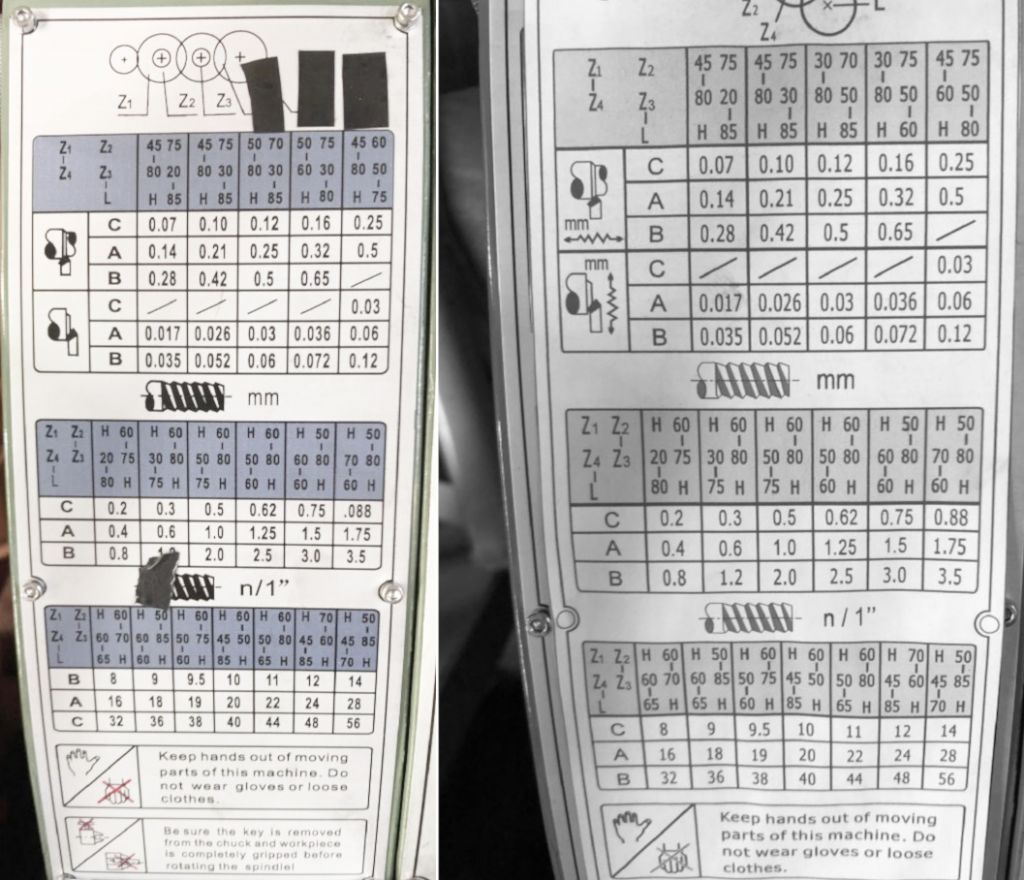

                                          In answer to Sillyoldduffer' I've also uploaded some pics of the machine change gear plate and the manual which I printed and have taped it to the machine for now. Not great but hopefully better than what was there where data accuracy is concerned?
                                          Note that in the imperial threading table the gear selector rows reads BAC where all the other tables read CAB. By chance the first thread I tried cutting was 11tpi and it just want working out. I explained to warco who said the gear selector should be set to C not B as per the manual. Sure enough that fixed it but why then does the plate on the machine say B. That led me to want to check all the data on the plate and all those with a bit of black electrical tape above them show different gears to those in the manual too. Compare the photos!
                                          Rather than have me install all the ratios and check them for accuracy I asked Warco to tell me what is right and to supply a new plate with the corrections incorporated. They in turn referred it back to the Chinese manufacturers. Could be a long wait. If anyone else has one maybe you could lean on them. I wonder how many other models suffer this. The manual is a copy paste of the 280 in the most part.
                                          Had I not tried cutting an 11TPI thread as my first one I may never have discovered this error!

                                              #455030
                                                Posted by Dave Brannigan on 02/03/2020 11:21:21:
                                                … uploaded some pics of the machine change gear plate and the manual which I printed and have taped it to the machine for now. Not great but hopefully better than what was there where data accuracy is concerned?
                                                Someone in China had a bad day – the Gremlins got to that gear plate good and proper! Here they are side-by-side:
                                                The plate on the lathe (left on picture) is odd. The pasted table from the manual is better, but it's not identical to the one on my WM280, which has gears for 9,18 & 36 tpi as per Dave's left table. My maths is dreadful, but I think 50 85 60 60 is correct (17.99 tpi), while 50 85 60 65 produces 19.49 tpi.
                                                Any 290 owners out there who have tested all the combinations? I'm almost 100% metric and haven't used the TPIs much. My metric 280 could be Imperially wrong too!
                                                Dave.
                                                #455059
                                                Dave Brannigan
                                                  @davebrannigan15528
                                                  Could someone please tell me how to embed a photo in the actual post as its getting to grind having to create an album each time I want to show something. Maybe I'm missing something?
                                                  Anyhow, the Pitch of my leadscrew is 3mm and the clutch – a spring loaded cam type clutch is mounted on the left of the shaft as it enters the gearbox. Please See album photo. Not sure if this is a recent feature for a 190 but it is listed as a feature on the Warco site as "Overload clutch to feed shaft".
                                                  When it overloads it just jumps 1/4 turn then carries on driving until it overloads again. Simple and effective but I wondered if my spring was weak. I guess the other factors in which I'm a novice need looking into before blaming the tool!
                                                  Been carpet fitting today so no time to read everything but I'll get to it eventually. I thought retirement was meant to be restful!
                                                  #455061

                                                    #455064
                                                      left looks to be SCMT
                                                      Middle the WNMG I mentioned this morning though it may nor be N as it looks like the edge has clearance
                                                      Right TCMT
