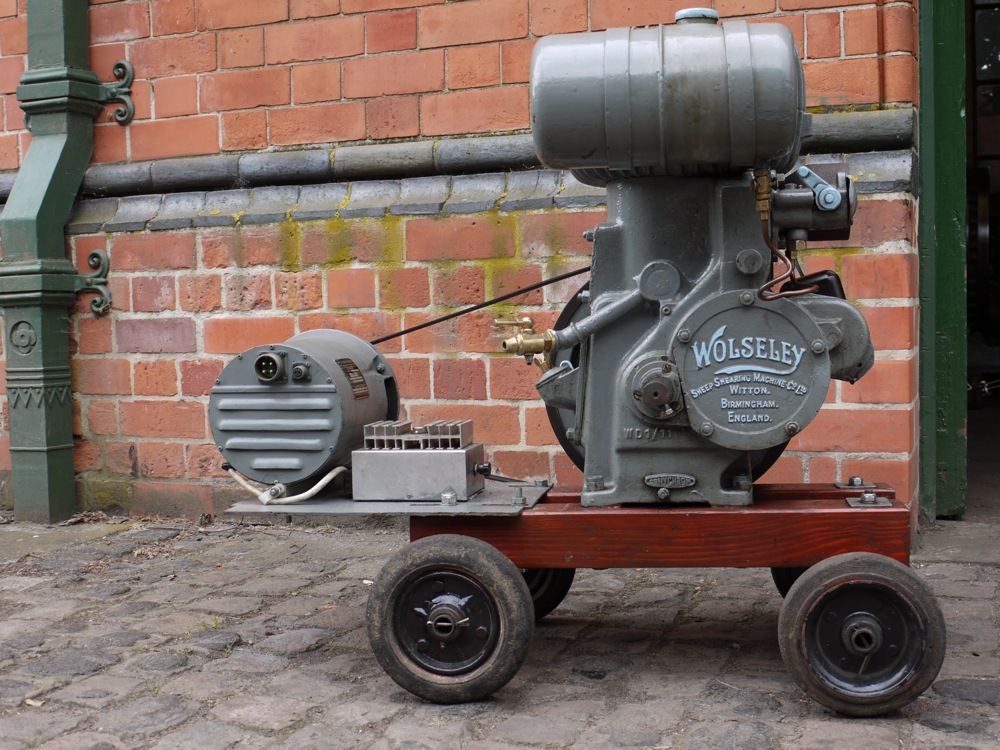

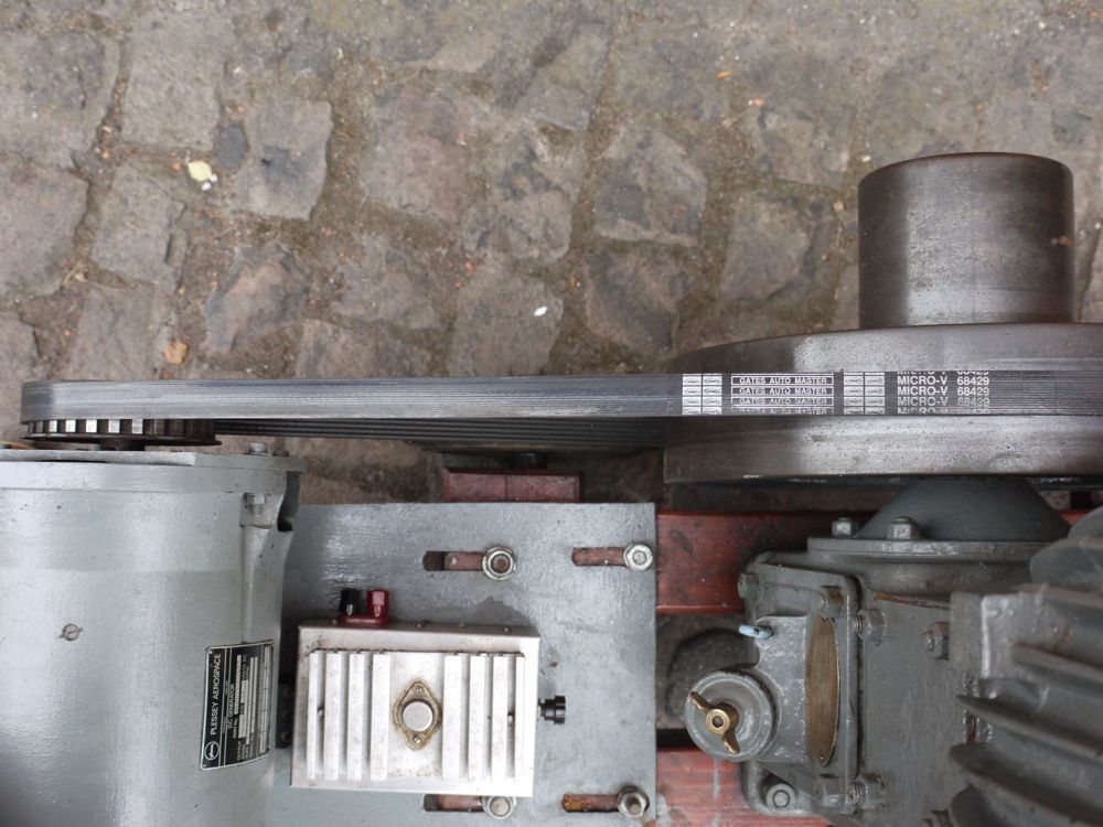

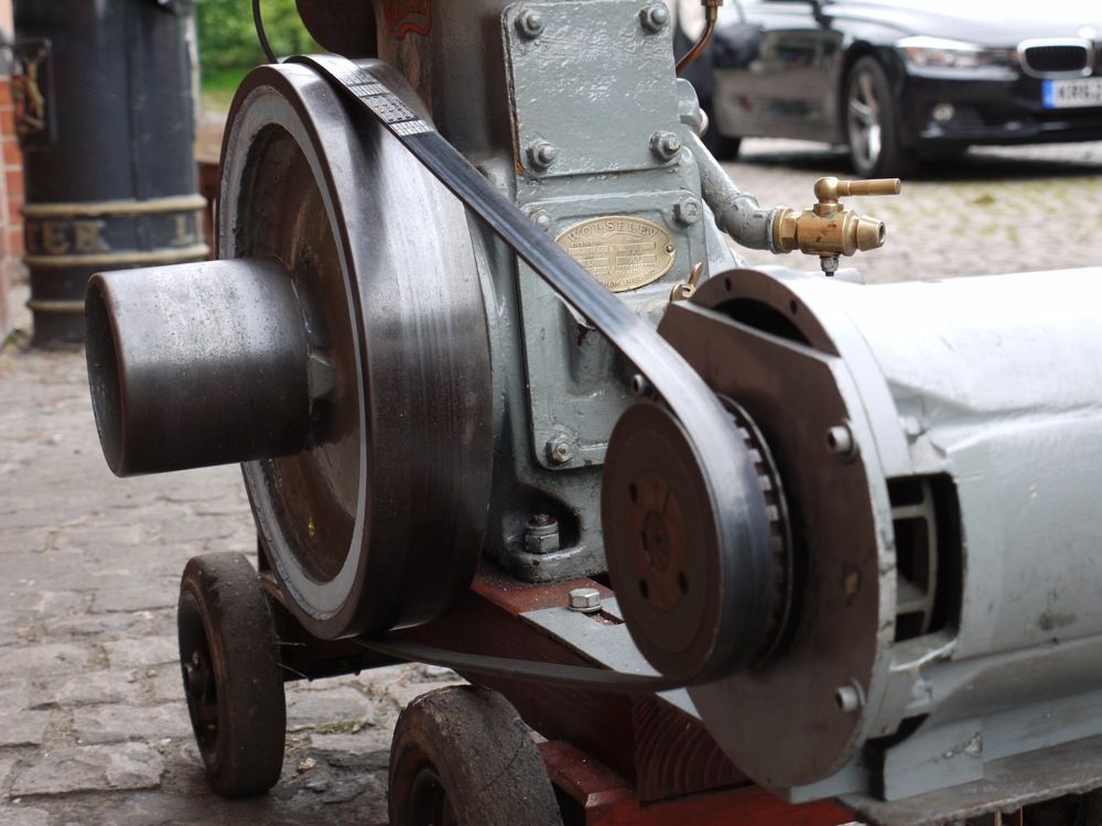

          #155510
            Francis,
            On Sunday, I saw the proof of this concept
            Have a look at the drive on this …
            It belongs to Denis, one of the volunteers at Papplewick Pumping Station, and he assures me that it works fine.
            Crowned flat-belt pulley on the engine; Timing belt pulley on the 2kW generator.
