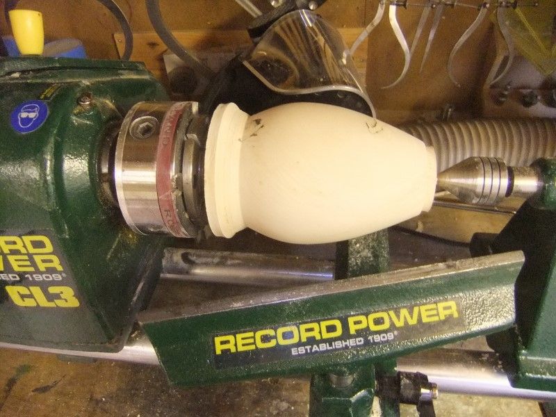

                Just out of interest the Record Power wood lathes also had this type of oil function at the beginning of the day three drops of oil is required and is enough for running all day on and off if however continuous work is done they recommend a further few drops it can be seen just to the left of the chuck.
