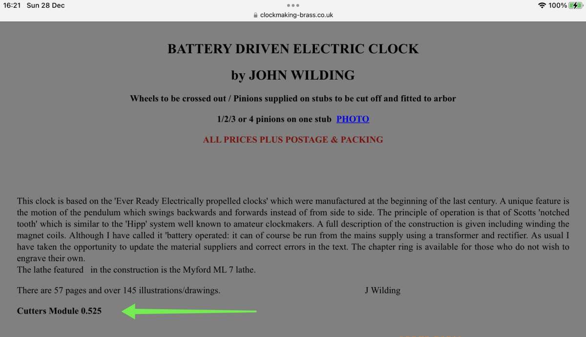

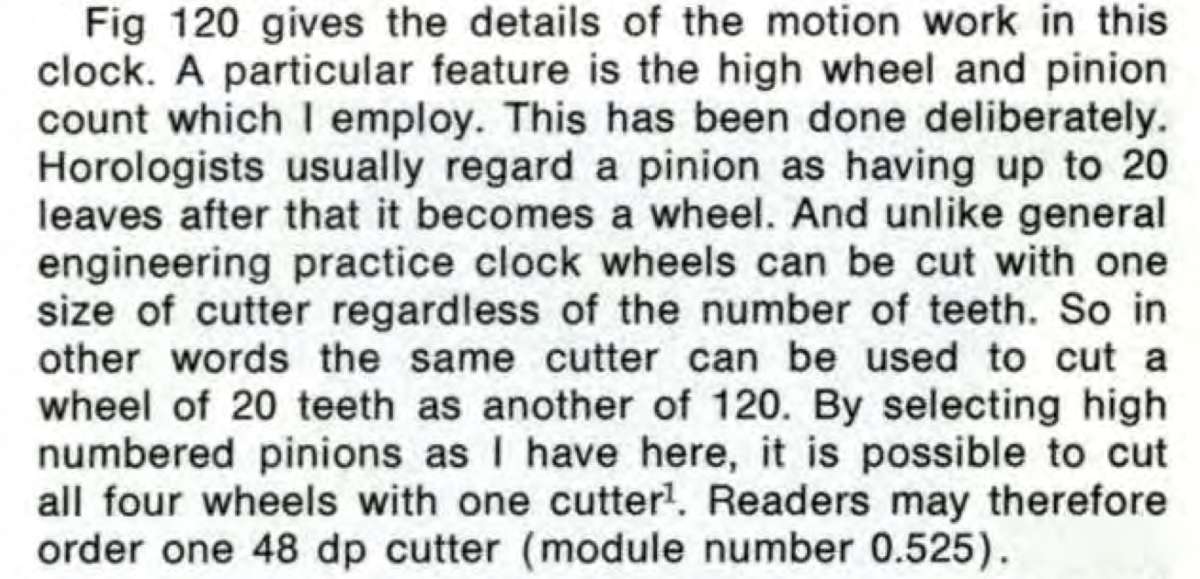

              John Wilding said that one size of wheel cutter is suitable but there are several sizes in a set. He used 48dp but doesn’t say which of the tooth counts is most suitable. I’m inclined to go for a higher number but am undecided as to how to make my mind up.

                  On modeng2000 Said:
                  […] but there are several sizes in a set. He used 48dp but doesn’t say which of the tooth counts is most suitable. I’m inclined to go for a higher number but am undecided as to how to make my mind up.
                  Only for Involute
                  This is only a guess, since I have not read the book: I think you might want 0.525 module Cycloidal
                  Wheel Cutter

                  #830301
                    Q.E.D.
                    From the originalarticles, and therfore presumably the book :
                    IMG_1321

                          Thank you all, I understand one tooth size being used throughout the clock, this was the same for the Jubilee clock by John Wilding.
                          However my concern is which of the cutters in the range would be best, there are eight to choose from. Is it that any of them would suffice? Also I’m aware that involute cutters are not really for clocks but they do seem to be acceptable in this application.
                          So should I choose a cutter for a high tooth count or doesn’t it matter?

                              Cycloidal teeth are supposed to be better in the going train which usually has high step up ratios (though evidence is scarce). This clock just has motion work stepping down the ratchet wheel to the hands, for which involute are better anyway.  The implication of what he writes is that a cutter for 48 teeth and 48 DP is suitable. It’s quite easy to make single tooth cutters, I’ll post a link.

                                    There  is no decision to make, unless you are modifying the design !
                                    Wilding uses a 0.525 Module, Cycloidal cutter … and so should you.

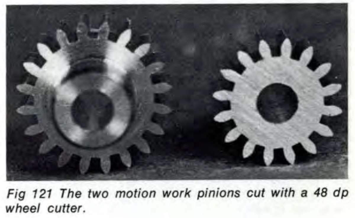

                                    #830342
                                      Go Compare … with the tooth-shape of any version of a 48DP Involute that you care to choose.
                                      IMG_1323
                                      Feel free to re-design the clock my all means …
                                          IMG_1323
                                          Michael.
                                          I think that I’d be redesigning the teeth of those two examples in your picture to make them a little less ‘drunk’. 😉
                                          Martin.

                                            Not my picture, of course … but John Wilding’s
                                            I thought the photo-credit was there by implication.
                                            #830502
                                            Bazyle
                                              @bazyle
                                              The tooth distortion is photographic parallax not a defect.
