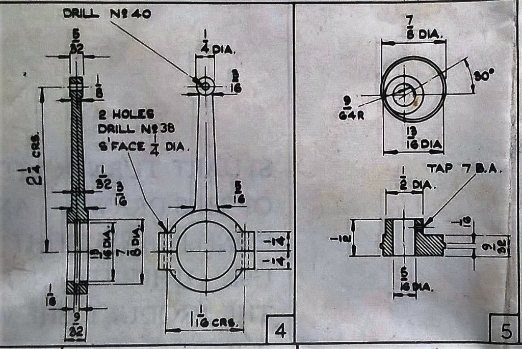

      I have been given a Stuart 7A vertical engine to complete. I am trying to establish the throw on the eccentric sheave it is missing off the engine and need to replace.

                I have just checked the dimensions on the Stuart 7A I have, there is a drawing but the dimensions are different to the ones on your drawing. This an old 7A I think from the 60,s I have added a picture of the eccentric sheave there appears to be no off set dimension. I am having to make a new eccentric and trying to .establish the throw. Excuse me if I am missing something simple here.

                            No need to ask Michael you can see the dimension in his first photo – 9/64th.
                            George is that the right drawing you posted earlier as it only has a 3" flywheel, the 7A should have a 3.5" flywheel which would also explain the larger 9/64 throw and longer eccentric rod on others models. Looks like your drawing is for a 10A

                              Mea culpa… My drawing is for a 10A, seems like I went word blind for a while there, after checking my kit box it had 10 A on it although I was convinced it was a 7A… have already posted Steven on the error… considering I'm much closer to 70 than 60 an error or two is bound to arise, so I reckon I'm not doing too bad on the whole.

                                Thank you for all the assistance especially to George I have sent you a reply email. I now see the throw is 9/64th I was not sure what that dimension on the drawing was. I normally would have expected the throw to be shown from the centre line but there you go that's just me.
