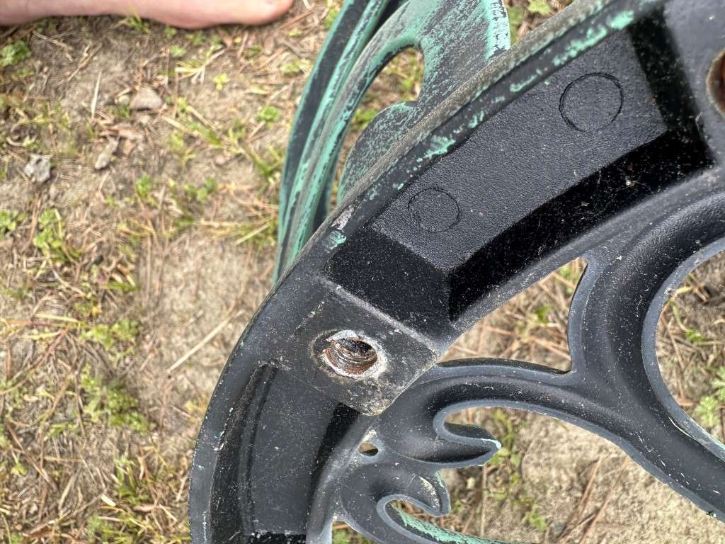

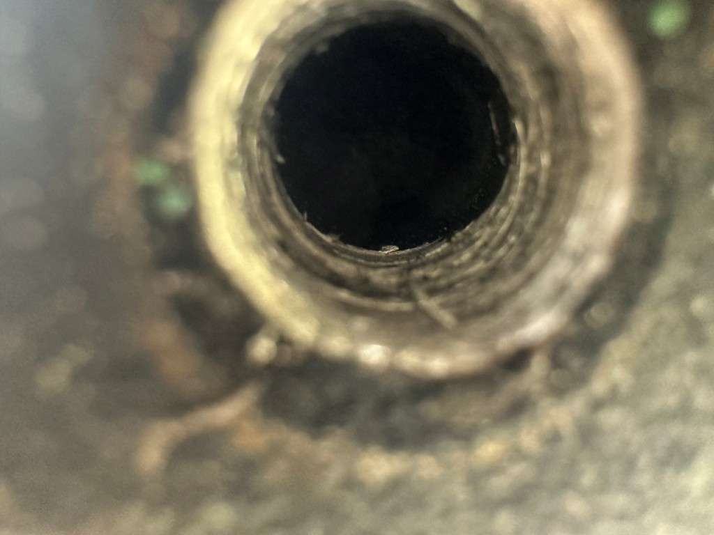

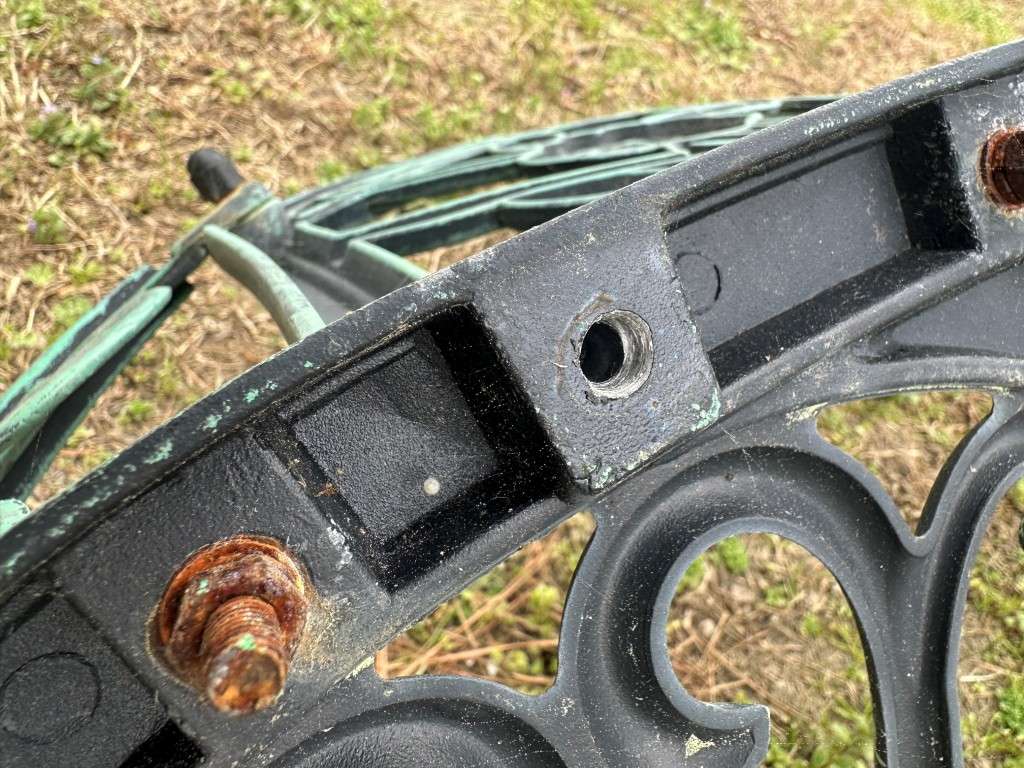

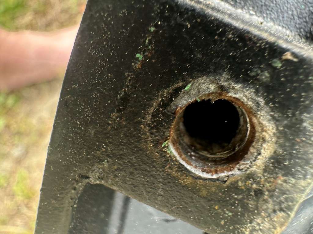

          It is a sealed area, though it wouldn’t take much for it to become unsealed and adapt for a bolt or the like.
          Now, what really surprised me was the depth of the metal. I took an auto brake pad measuring tool out there and i was exactly right! 8mm. That doesn’t happen very often-
          And… about the closest this thing came to being an airplane was when it flew when Daisy had taken it for a run.
          I’ll probably go with long studs so they top out at the upper part of the inside space, figuring that little extra should give it a little extra support.

            Helicoil or double threaded bush and bobs your!!!

              Good to see what we’re dealing with, Bruce. It looks like the manufacturer cheaped out on fasteners that weren’t exterior grade. It might be worth replacing them with stainless. Use some grease or anti-seize when assembling to prevent galvanic corrosion between the aluminium and steel. And then perhaps paint over the finished assembly.
              A wire thread insert or bushing, as Bernard suggests, should put things right with the damaged hole.

                  I’ve used this type of thing – thread reducers:
                  Thread_adapters
                  You can use a standard tap of a larger size then just loctite the reducer in, to get a new thread of the wanted size. No special taps or kits required. Not appropriate for every situation, but a simple fix for some problems such as the OPs.
                  (They are also useful in smaller sizes when you need a small very deep thread in metal that does not clear easily – eg. you can use an M6 tap rather than M4, and then a reducer).

                    The area around the stripped hole looks plenty deep enough to drill close to breaking through and then accept a common 1 1/2 D length coil. You could practice by drilling and tapping a spare bit of metal right through. Then fit the coil, and you can then wind it right through and reuse it. If the coil you fit ends up with some still sticking out of the blind hole, you can cut off the surplace with a Dremel. Dont forget to use a little lubricant when drilling and tapping. A common fault with beginners is to push down on the fitting tool,very little force is needed, too much and the tang will break off prematurely.

                      OK, so it’s held for two days now!
