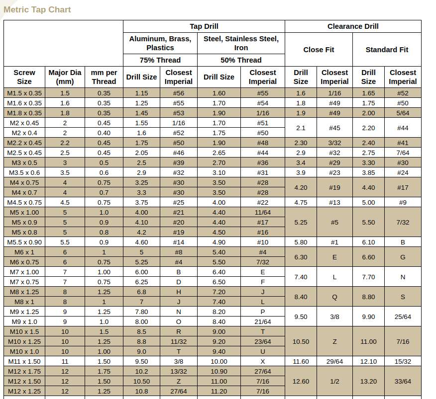

                If going the next fastener up route, study a Tap Drill Chart to make sure there’s enough meat to take the new thread, and to establish the tap drill diameter.
                metrictap
                Note the chart highlights some sizes and not others.  The highlighted sizes are preferred, i.e. easy to find, whilst those in clear exist, but may be tricky/expensive to source.  Generally simpler to stick to preferred sizes.
                The chart also refers to tap drills selected for either 75% or 50% engagement.  You might prefer to increase engagement with a slightly smaller tap drill.  Makes it harder to tap the hole and fit the bolt without cross-threading it, but increases the strength.
                For Aluminium select a coarse thread rather than fine. (M10x1.5 rather than M10x1.0 etc)
                Tapping is more skilled than it appears.  Many Aluminium alloys used to make furniture and castings are gummy, requiring extra care. Vital to keep the tap aligned with the hole and the nature of the job makes it likely a hand operated tap will wander until at least 4 straight turns start steering the tap.  Self-steering in soft Aluminium is unreliable so I’d take positive action to keep the tap straight, not relying on my wobbly hand and dubious eyeball.   Traditionally done with a bell-shaped jig, now more common to hold the tap absolutely straight in a pillar drill, milling machine or lathe.  Lubricate, reverse every couple of turns to break swarf, and remove swarf from the hole frequently.   For a little extra strength, start with an easy cutting taper tap and finish the thread with a plug tap.

                                      The drill chart above seems to have some errors, unless I am mistaken which is quite possible, in the 50% engagement column the first 3 sizes are greater than the thread max diameter, I didn’t check the other stated sizes.
                                      Emgee
