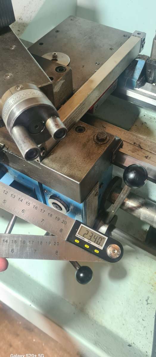

                                Mark Hall
                                  @markhall37441
                                  Surprising just how often this can be a issue with not only the dial marker moving over time but also different lathes have different set positions , I only found out mine moved after encountering threading issuses, it’s one of the newer boxford lathes the 330IS versions, only a 24 year old boxford lathe but it had moved, I used the same threading tool/ inserts i used on my previous boxford a 10.20 ( same x10 range) same tool height guage but with precision guage block as they had different swings ,same steel but it was tearing, after checking it with a digital protractor i found it was off but only by a few mm but that was enough for the edge to rub as it was threading causing problems, once I set the compound to 29° using the digital protector it solved the issue, threads came out smoothe again. Its a great tool to have & they are cheap, I use the digital levellers too, some are very precise indeed good enough for precise set ups on the mill

                                  Bazyle
                                    @bazyle
                                    I didn’t see this thread in 2011 as I don’t think I was a member back then. My Boxford cross slide is aftermarket T-slot so engraved at 90 degrees, and my complete spare saddle (new style  – 60’s?) is unmarked. If I find the original slide (1952) I will check.
                                    However the clue must be in the offset of 15degrees and its relationship to 60degree UNC and Metric threads. No mention was made of the direction of offset but it should have become clear as soon as the OP tried an offset screwcutting job.
                                    Either Boxford intended these models for export or were expecting the UK to wholeheartedly adopt metric. It would also make sense that since so often used for training they expected the students never to be told Whitworth existed.
