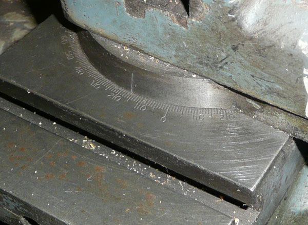

      Hi everyone,
      new to the forum and straight away looking for help.
      Just bought a Boxford lathe, the angle graduations on the top of the cross slide are a bit odd in that they are offset by about 18 degrees.
      All lathes I’ve seen previously have the zero at 90 degrees to the bed, on this one the zero is set about 18 degrees anti-clockwise.
      So if you set the compound slide with a square to the cross slide it reads 18 degrees.
      Does anybody know why this might be, could it have been made for a specific job?
      Thanks,
      S.

          OK no responses.
          I’ve looked again and it’s 15 degrees not 18 as I said, innacuracy of initial reading due to having to lean over a load of stuff at an angle to see it.
          Does anybody know where I may get an answer.
          I’ll ring Boxford in the morning to see if they know, any other suggestions..

              If I understand correctly, that would give a greater range in one direction than the other wouldn’t it?
              Perhaps that had something to do with it.

                Any chance the ring with the calibrations on it has moved as unlike a lot of lathes the boxford has the angles on a separate ring fixed to the cross slide rather than just a mark and the angles on the side of the topslide.
                J
                Edited By JasonB on 06/03/2011 17:23:59

                  How about what may well be a silly answer. I don’t suppose that either the fiducial mark, or the scale are adjustable are they?
                  On the otherhand, is there another fiducial mark elsewhere?
                  Just a thought.

                    As JasonB said the degree ring has come loose and moved. On my Boxford the ring was just stuck in (thin double sided tape). Years of oil and cutting fluid just released it. Cleaned it all up and used a drop of Loctite to re-fix it.

                      My Boxford MkII AUD has the same 15 degree offset of the scale but the fiducial mark (there is only one) on the topslide is so positioned that setting to 0 gives topslide movement parallel (approximately) to the lathe axis. If it is a mistake it is a common one. My lathe came from a fellow club member who bought it new so it has not been messed about with as far as I know.
                      I notice that the MkIII on lathes.co.uk does not show this feature,
                      Cheers, Andy

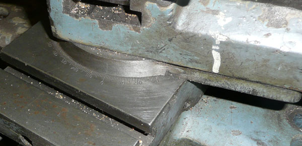

                        As you can see from the top image the scale is marked into the cross slide so there is no separate ring.
                        The bottom image is set to the zero position and as you can see the compound slide is clearly not in line with the bed, if you take the cross slide Tee slots as parallel to the bed, which they are.

                          Just been thinking, it is an AUD 2 and as Andy says maybe the fiducial mark should be at an angle also, which may mean that the compound slide has at some point been replaced with an incorrect one.
                          Possible solution is to get the correct angle by doing some ‘test turning’ and then make the proper mark on the compound slide.

                                  Been thinking about this this morning and rather than take a cut on a bar, I can just use a dti in the toolpost on a good parallel bar between centres, that would be the quicker way of doing it and means I don’t have to do any of the cutting-measuring, cutting-measuring, cutting-measuring………………
