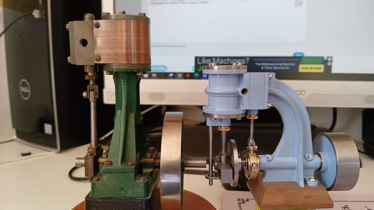

      A few months ago one of the members of MEM forum posted about the restoration of an original Stevens’s Model Dockyard “Direct Acting Marine Screw Engine” which caught my eye. I do have a reprint of their 1919 catalogue but the image of the engine is not really clear enough to see what is going on but his photos were enough for me to have a go at recreating one of these engines. I went for the No1 size which at 3/4 x 3/4 or in my case 19mm x 19mm is a similar cylinder size to the Stuart “10” range.

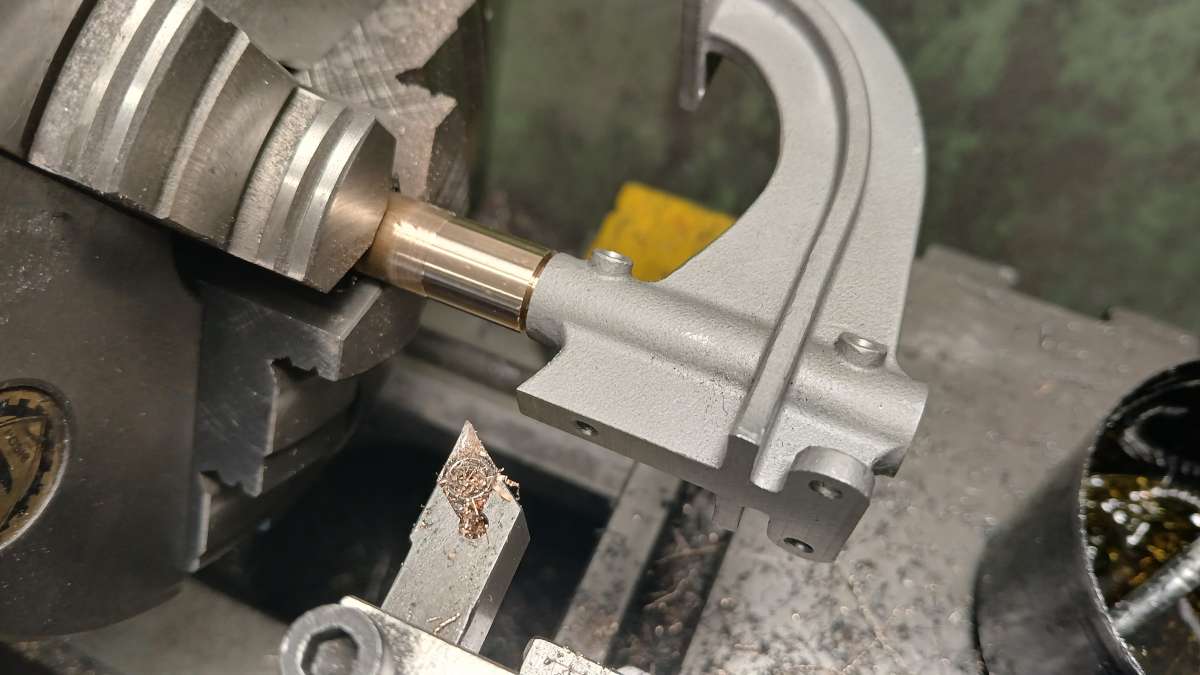

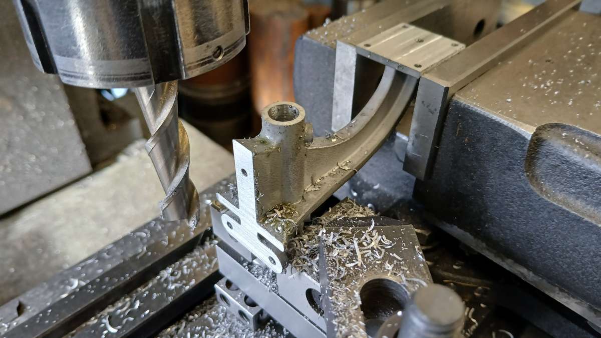

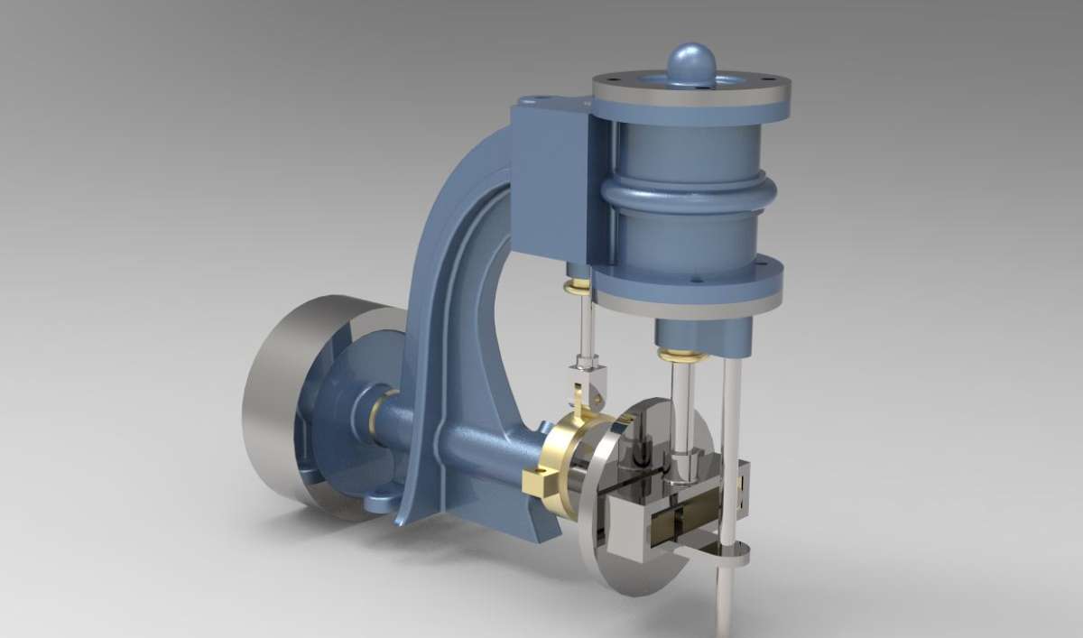

      As usual I drew it up in metric using Alibre with the intension to use a 3D aluminium print for the main frame with the rest cut from solid.
      render
      There was not much to do to the 3D printed frame as I included most of the hole sin the file that wa ssent for printing. I just had to open up an dream the hole for the crankshaft bushes and mill off a small machining allowance on the foot and valve chest “cover”
      20260412_091404

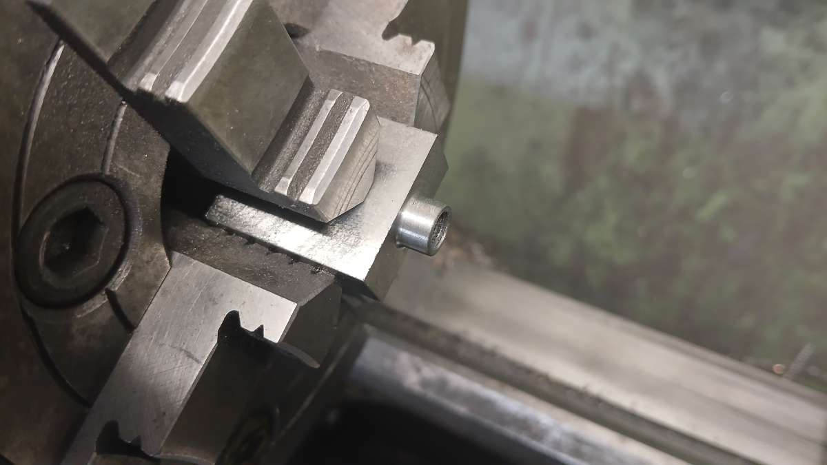

      The main bearings were turned from bronze and the reamed hole used to gauge their size.

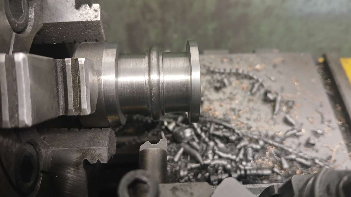

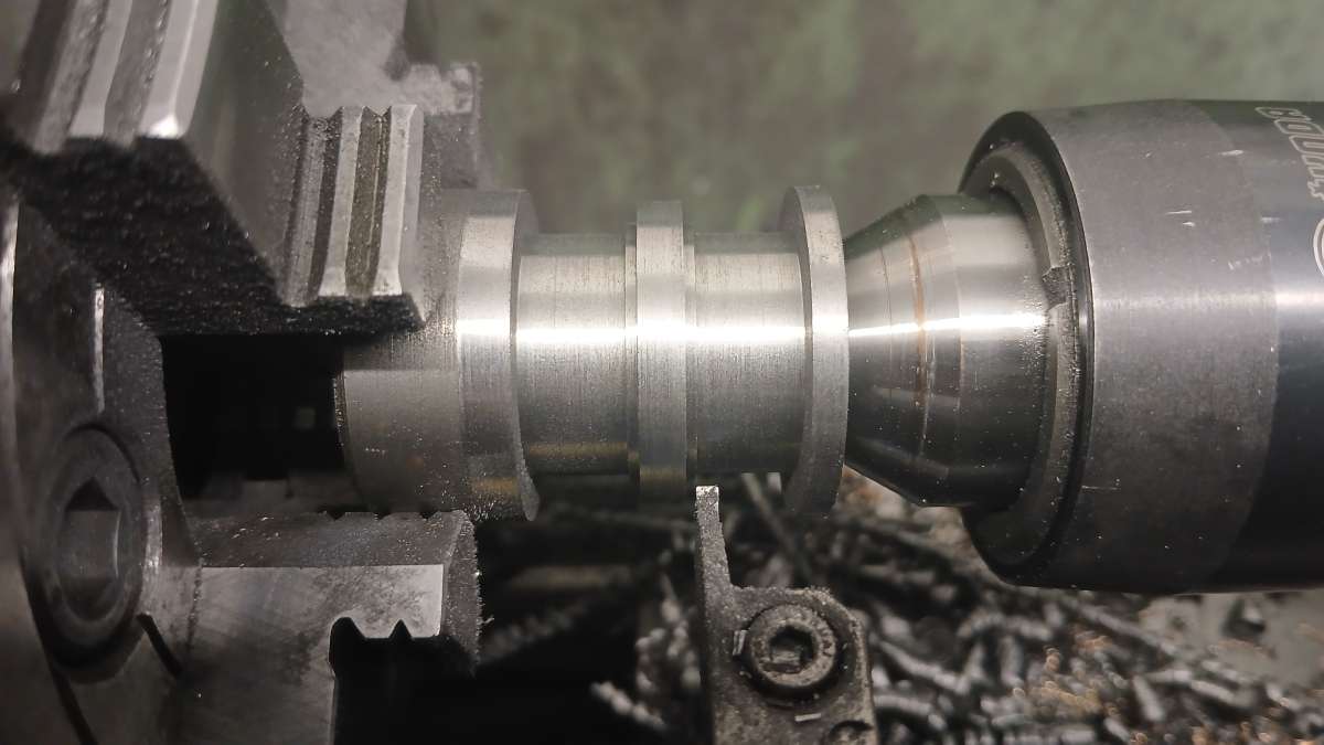

      The cylinder was roughed out from some cast iron bar
      20260416_135203
      Before finishing the decorative bead with a form tool
      20260416_140137

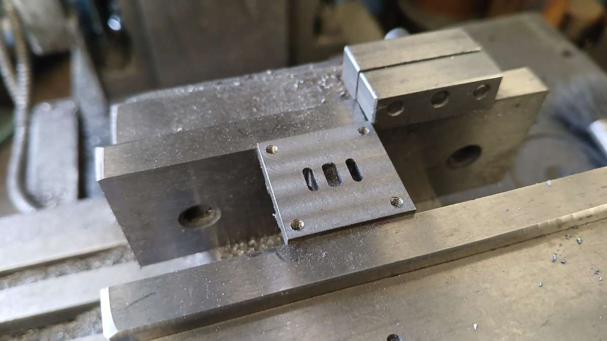

      A flat section was milled to accept the separate port block
      20260418_134731
      All the holes and passages were machined into the port block prior to bonding into place with JB Weld
      20260419_140355

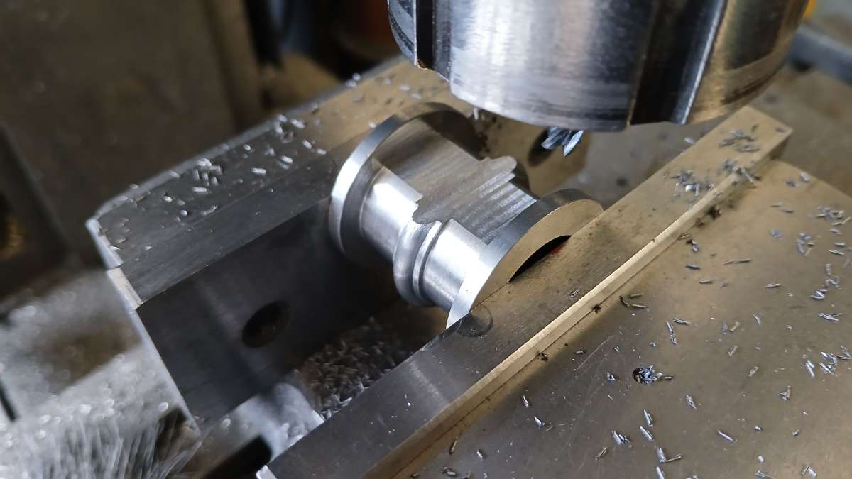

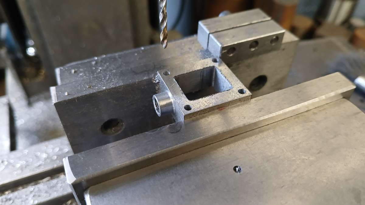

      The valve chest was just turning and milling from a rectangle of castiron
      20260416_142516
      20260418_133512

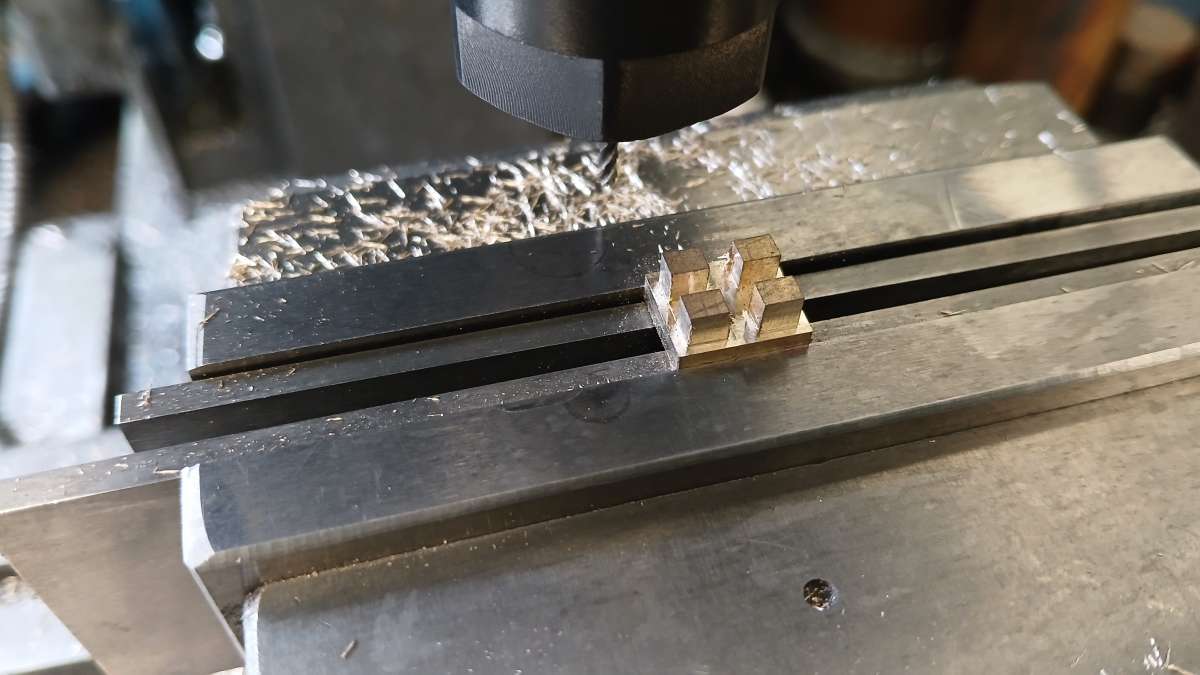

      Valve milled from a bit of bronze block
      20260510_090644

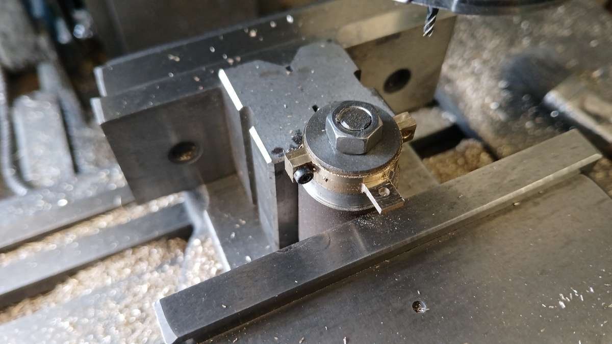

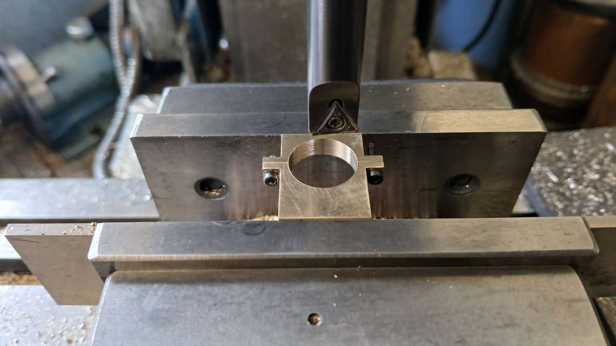

        The eccentric strap was machined from some flat brass repurposed from a shower door hinge
        20260512_135304
        The outside was mostly done with the rotary table before the vice to finish off the lug for the clevis.
        20260514_134719

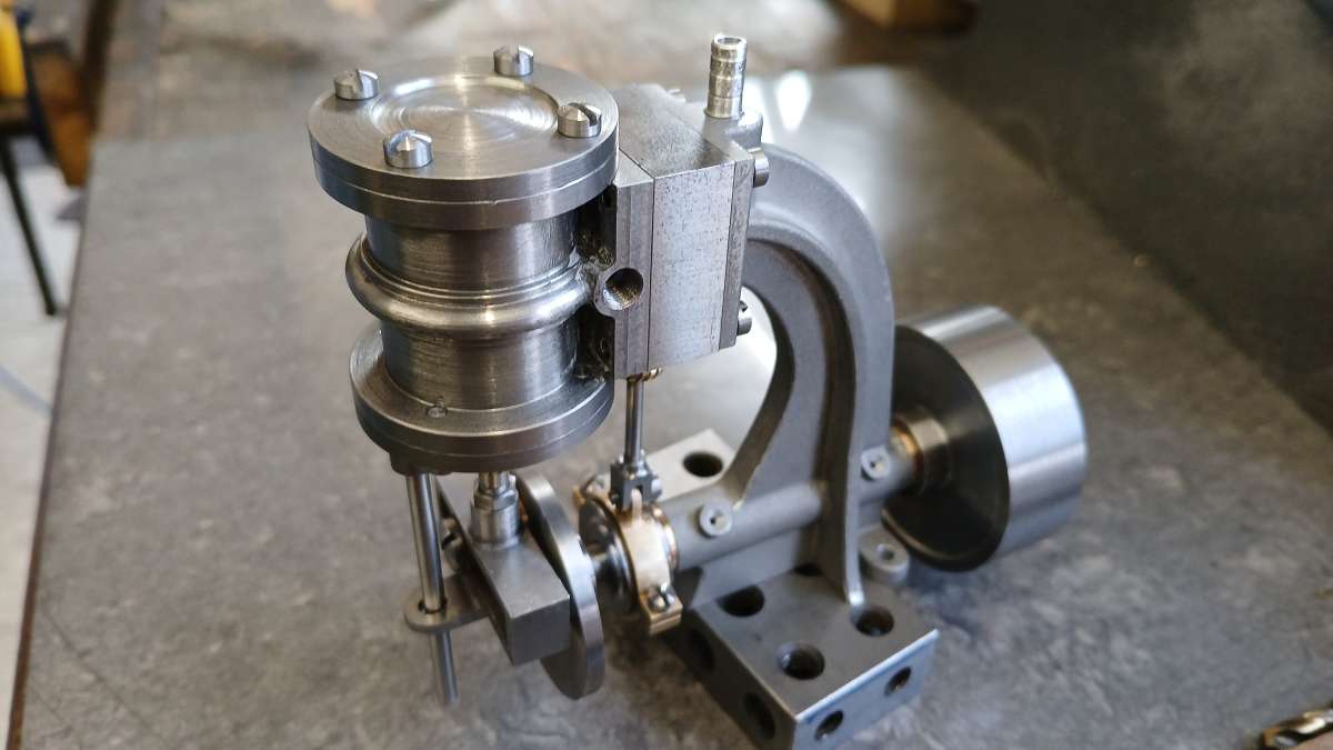

        I did not take any other construction photos as it is all much the same as other engines. Trial assembly ready for a quick test run..

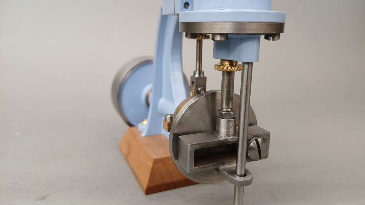

          It’s certainly an elegant and rather unusual design!
          Obviously it works but I thought in general the Scotch Crank is better driven from the shaft than from the piston?

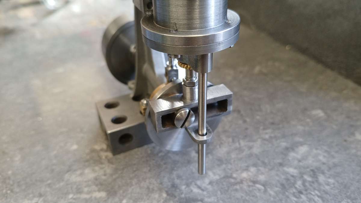

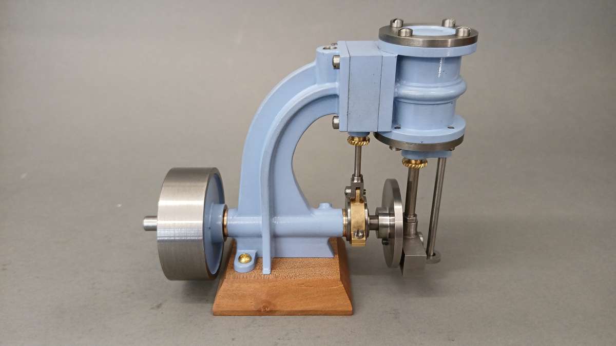

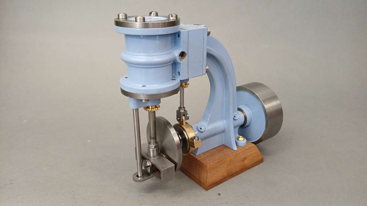

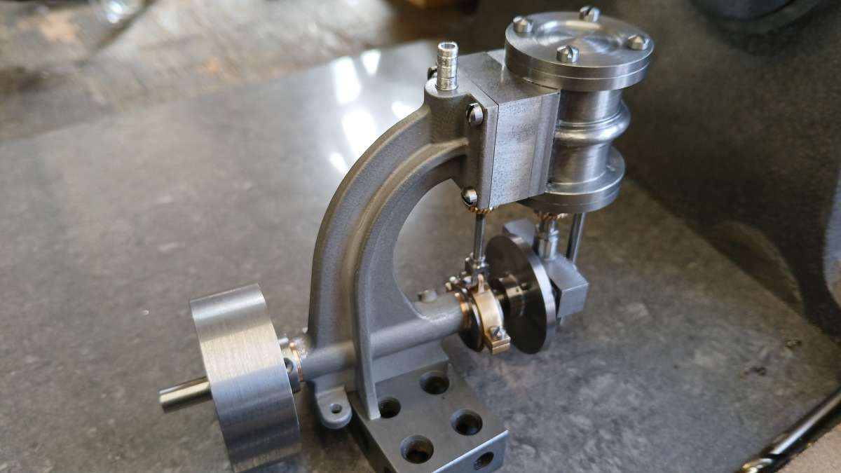

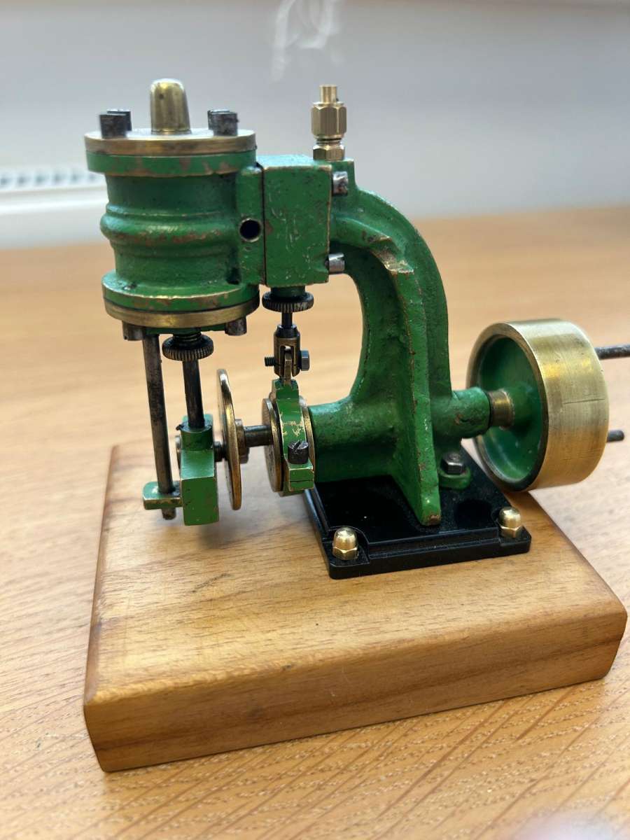

                Nigel, as far as I am aware the Scotchyoke is driven by the piston rod as it’s main aim is to eliminate the need for a crosshead and conrod thus giving a more compact engine. As I said it is the same bore & stroke as a Stuart 10 but comes out considerably shorter, ideal if you want to get it all below deck or just keep the ctr of mass low in a hull.
                20260526_091034
                Alecs, next time I’ll order the sand blasted finish rather than the smoother bead blasted and then kick it around the workshop for half an hour.
                Well as you can see from the above image it has now had a coat of paint and been mounted on a small base just to stop the flywheel touching.
                20260525_120441
                20260525_120654
                20260525_120737
                Quite happy with how it runs. It is not the easiest engine to set up as the port face is on the cylinder which means you can’t set the valve to that as it is not solidly connected to the engine once the valve chest is open. I settled for checking that it had equal movement within the valve chest and did a rough 90 +30deg setting for th eeccentric. Just needed one adjustment to that to reduce the lead slightly and off it went.

                  PS That scotch crank and driveshaft arrangement looks seriously slender and overhung if you wanted to take pore out of the engine. Very surprised the bottom end of the stabiliser rod isn’t fixed to something.
