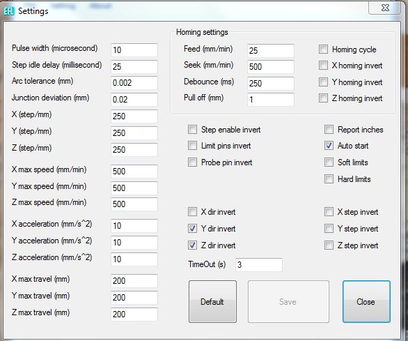

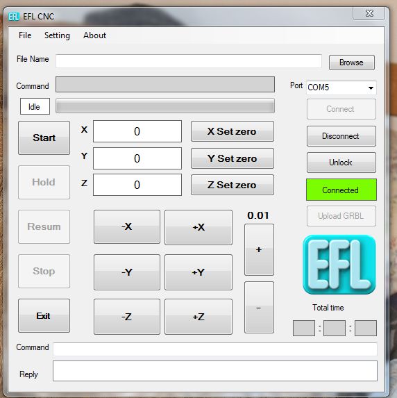

      Trying to drive the X axis on my mini mill with a stepper nema 17 (200) steps /rev this is hooked to a easydriver -arduino uno – usb- EFL program.
      Need help with these settings comes std with step/mm 250 at these settings asking for a X1 and checking the DR way off.
      Tried this (stepper) 200*8 (micro steps)*20 (lead screw) = 32000
      Tried that in step/mm and the stepper just makes a noise that's like a high pitched squeak.
      Thanks all

            The arduino has been "flashed" with GRBL
            sounds like I know what I'm talking about just a little parrot talk
            Testing on the mill. had too up the voltage to 24v
            Thanks again

                  Posted by VC on 01/03/2016 08:55:21:
                  That suggests 1 full turn of stepper motor gives 0.05mm movement of the axis. Are you sure that is correct?
                  I agree with others that NEMA 17 is likely to be a bit on the small side, unless geared down quite a lot.
                  Also check that traverse speed and acceleration aren't set too high – set to minimum for initial testing. It's very easy to ask the steppers to do more than they can manage in accelerating the carriage and overcoming friction.

                              What pitch is lead screw ? and are steppers direct drive to screw?
                              My guess without knowing the mechanical arrangement is that when multiplying by 20, you should have instead divided by leadscrew pitch.

                                Try writing a little program to run on the aruino that just sets the direction signal and sends 200 pulses to the setepper driver. There would be less unknown factors that way.
                                This looks like a template for what you need to do.

                                  This isn’t hard.
                                  200 (steps per rev)
                                  8 (micro steps)
                                  Thusly 1600 steps per revolution.
                                  20 mm lead also per rev
                                  Thus 1600 steps will advance 20 mm
                                  So. 80 steps per mm

                                    Does you mini mill really have a leadscrew with 20mm lead per rev?
                                    I would have thought something like a 5mm lead would have been more likely for a ball screw, or a 1mm lead for a conventional screw/nut leadscrew.
                                    #227808
                                    John Haine
                                      @johnhaine32865
                                      I think the lead must be 2mm per Rev, not 20! So 800 steps per mm. I think this is trying too hard, the stepper may not generate much torque until you have fed it a number of steps. A step of 1.25 microns isn't practically very useful IMHO.
