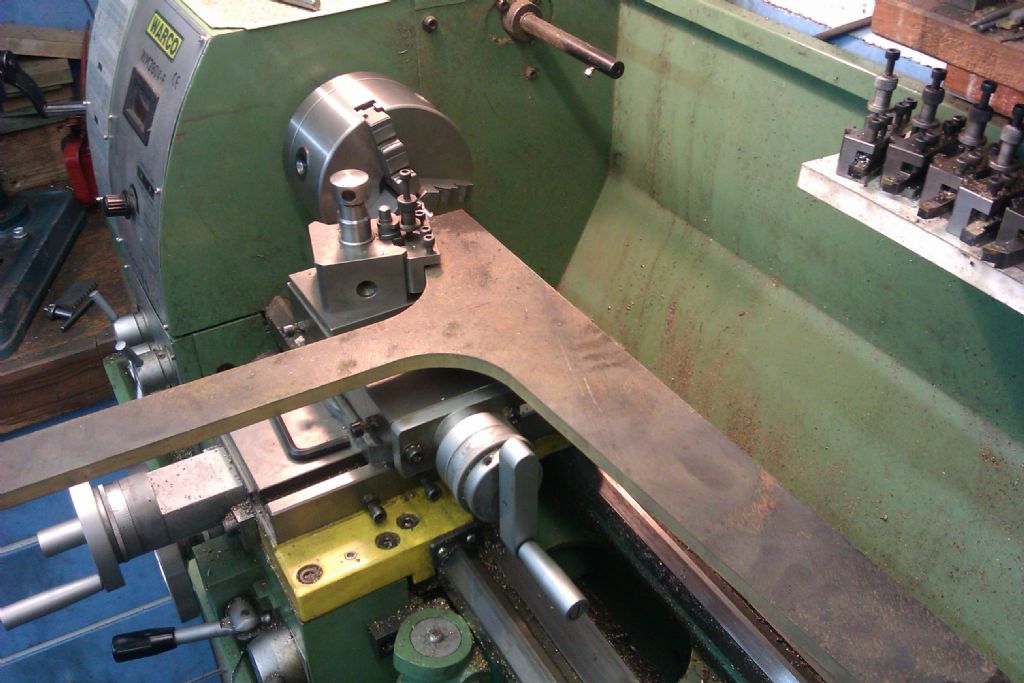

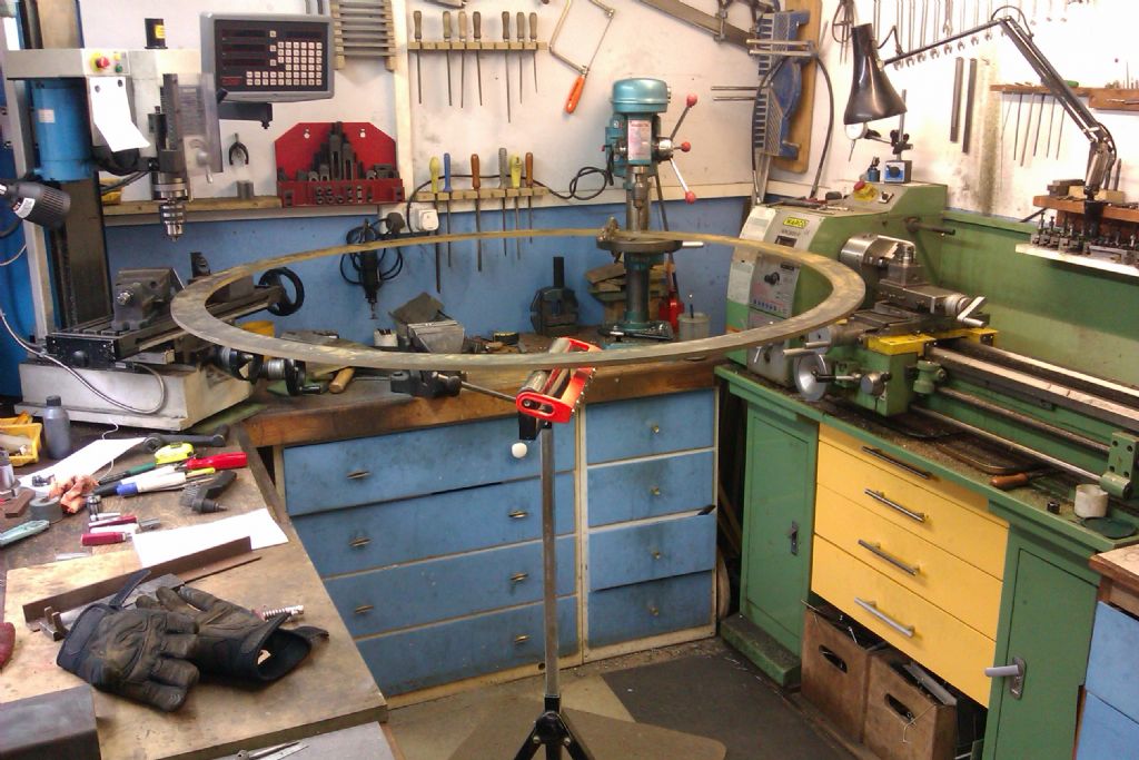

                          Yes as Andrew says its more a case of things that are two big for the mill can be done on the lathe
                          This casting is 10" long or 10" tall on the X3 as it would have needed to be mounted vertically, add in the boring head and tool and the area being cut is a long way from teh table so not that rigid, plus the lathe gives power feed.
                          And flycut at the same setting
                          Or when I made this table the waterjet legs were about 600×720 and could not be milled for nylon protector blocks a sthe X3 head does not tilt so they were done with the lathe.
                          Even drilling the top ring was a bit tight in my shedsmile o
                          And before you all slap my wrist I only needed a rough slot so thats why teh cutter is in the 3 Jaw, I was not worried if it moved
