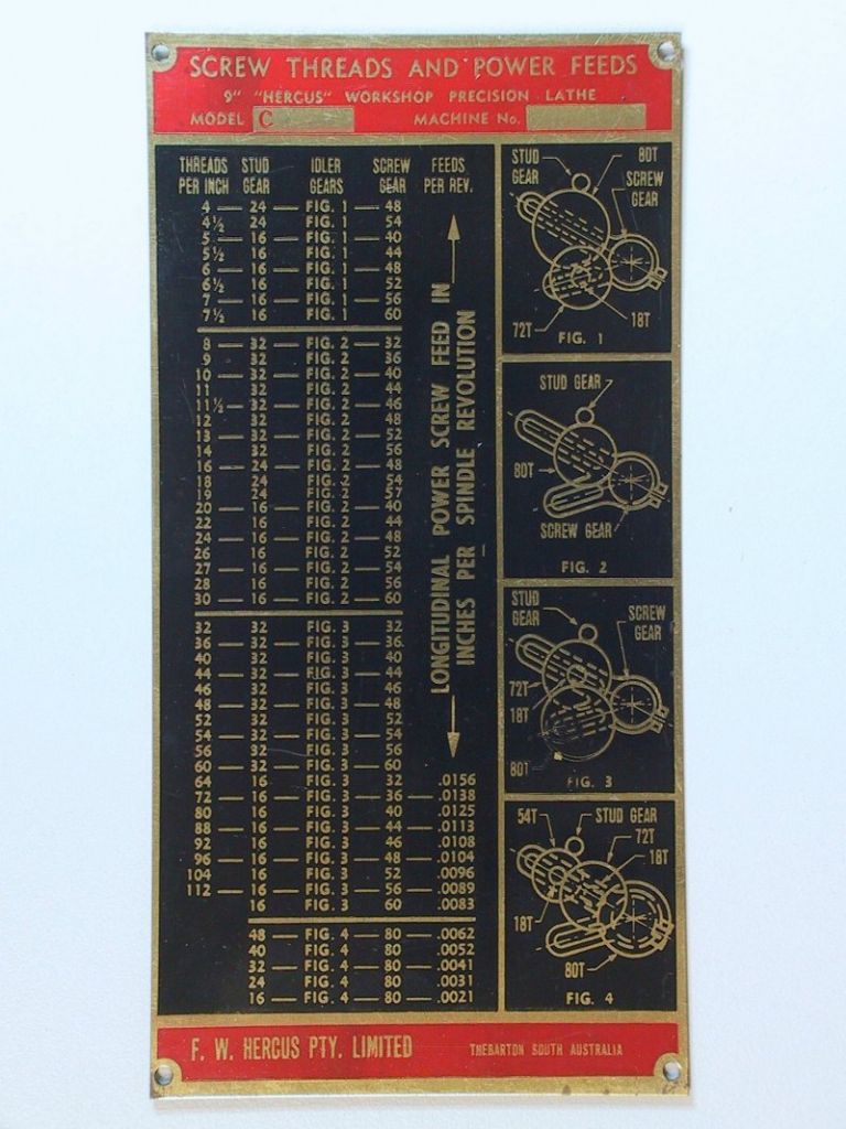

      I have a 1939 9" Workshop Model C. On the change gears cover is a screw cutting chart. Unfortunately due to the restrictions in the layout of my workshop I cannot read the screw cutting chart without opening up a severe rupture of the macro median transverse thingy in my back. I want to print out a chart so I can refer to it on my bench.The problem is that this chart does not seem to exist. I have scoured Google,Webbs,Lathes.com, but no trace.
      The chart is headed SCREW THREADS POWER FEEDS
      ENGLISH LEAD SCREW
      and at the bottom below all the gear specs…
      Cat No 15-ZBC Chart No7
      Can anyone point me in the right direction to print this chart. Thankyou

          Try this link, well down the page, it looks like the chart for the B and C are the same .

              Hi Roger,
              The Australian Hercus lathe is a copy of the Southbend. Thread chart attached.
              Paul

                I have made a excel-spreadsheet with both metric and Imperial treads for the SB 9 lathe.
                It`s in Norwegian,but its easy to translate.
                Hovewer i cant find a way to post it in the forum, but send me a message and i will mail it to you.
