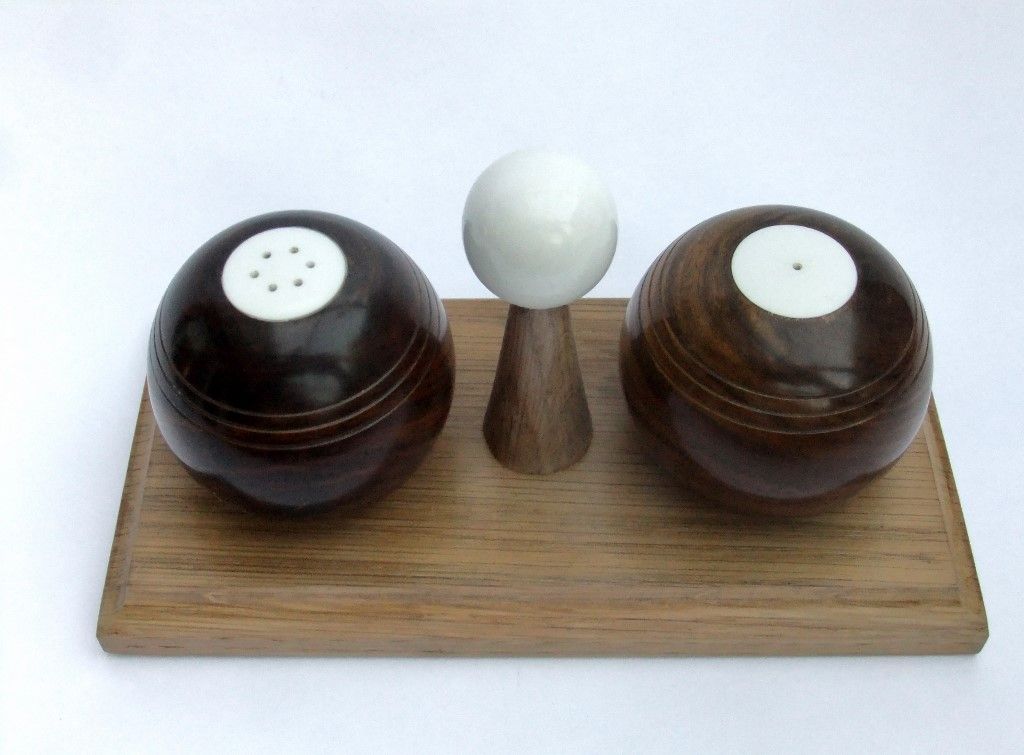

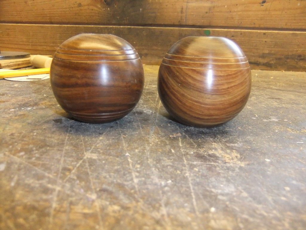

                                    Posted by Nigel Graham 2 on 08/04/2021 16:43:45:
                                    Lignum Vitae was often used in large steam-ships as a bearing-liner for the propeller shafts, lubricated by the water, so it ought have a goodly long life in well-pump valves. As others say though, even if you could obtain any, you've still the problem of having the balls turned to a suitable sphericity and finish – a problem with turning them from any material.
                                    Not as difficult as it sounds the two pots are from LV and turned to a couple of spheres getting it right just takes a little time and the use of a template.
