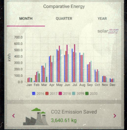

                      Our builder demanded another few hundred quid for software he was advised to install at the last minute. Apparently if you don't have the s/ware which shows how much each panel is generating then in the event of fall-off in generated power, it costs a substantial amount to find which of the panels is faulty. At least that's what all the new house purchasers were told.
                      Depending on your location and therefore amoount of "dust" in the atmosphere, you will probably need to have the panels cleaned annually. Rain doesn't seem to be very effective. Our window cleaner does ours – for an extra fee of course !
                      I'm surprised you were in net profit over the winter quarter. On the principle that all women have faulty thermostats, the heating in our abode is such that we (i.e. me) are net payers by a considerable margin during the winter months and also we have a big air-source heat pump supposedly reducing our power from the grid.
                      An awful image as it has been scanned from the phone but the aforementioned s/w is "SolarEdge".

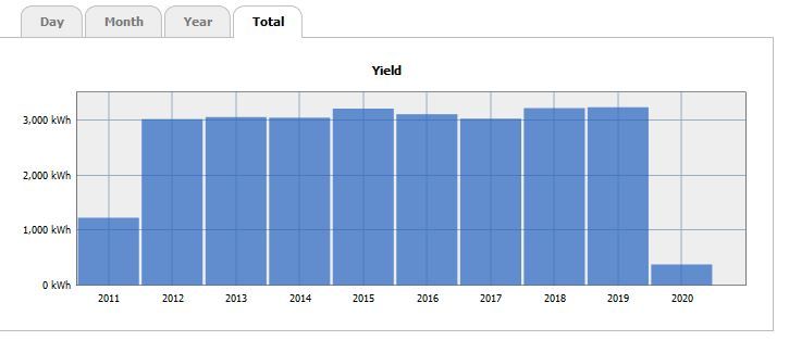

                                    The chart above shows the output from my 3kW system located in North Derbyshire. The interesting thing is how consistent the output is over the years. The supplier said it would take about eight and a half years to recover the costs and I've done it in eight. I've got a solar boost unit on my wish list, interesting to read comments about it. Not so sure about needing to clean the panels, unless you can do it for nothing. I doubt you would recover the costs if you had to pay someone to do it.
