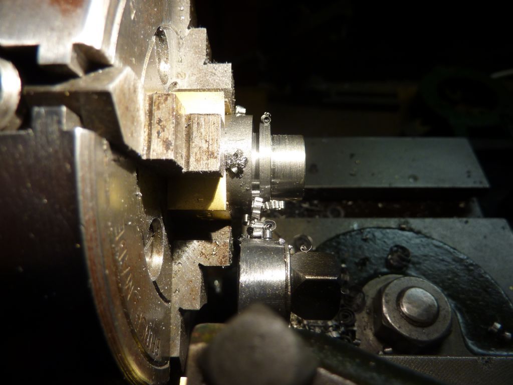

      Bought this from RDG at the Midlands show last October
      I've used it several times and have not so far had good results, usually ending up with a slightly domed end to either the job or the remaining bar. I've trawled the threads on here and tried all sorts of ways to improve matters.

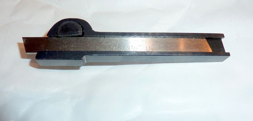

      I was thinking about buying another blade so last night I fetched the blade and holder out to measure it…
      … and found that the thick edge of the blade was at the bottom.
      So with mine the writing on the blade needs to be upside down. I havent tried it again but I'm hoping for better results when I do.
      I can't remember if the blade was already in the holder when I bought it but if yours isn't performing then it might be worth a quick look.
      I guess one could argue that in an inverted toolpost the writing would be the right way up. I'm not sure I'd be thinking like that even if I was using an inverted holder.

                  If it gives any further trouble, check that it's holding the blade in the vertical plane. Not all of those cheap holders do that. I had one that the blade noticeably leaned to one side, so of course it never worked properly.

                      It looks as though there is a cutting edge at the rear of that cutter? Turned around would it not need the writing the correct way up? Even if the writing was then not visible.🙂
                      #486711
                      HOWARDT
                        @howardt
                        I use a similar tapered blade in a home made holder. The thick side is the cutting edge, which ever way the part is rotating. Blade should be held so that the side tapers are clear of the part groove produced. Mine does tend to cut with a dome face unless I cut a groove with a double cut to widen the groove, I accept this as the blade is quite thin and only 10mm high. This is on a mini lathe also.
                        #486724
                        Andy Carlson
                          @andycarlson18141
                          Yes, the acute angle of the parallelogram needs to be the one doing the cutting and it needs to be the fat edge, not the thin one. Having had another play with it I think there is only one correct orientation – writing visible and upside down.

                                        I think the wider edge of the blade should always be on the clamp side of the holder, because the support is sloped to bolster the disengaged (narrow) edge of the blade there. If you use a rear toolpost that whole holder with the blade fitted should be inverted.

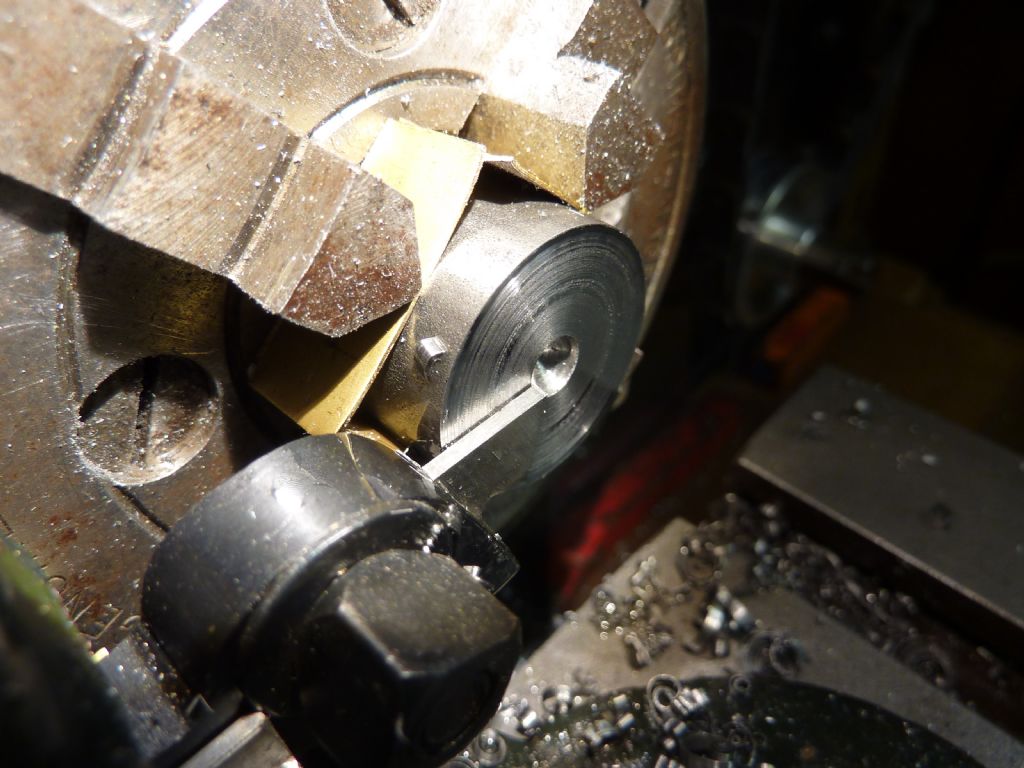

                                                An update… it works a lot better when the blade is the right way up
                                                22mm to 1 inch of EN1A. Setup was very careful, using a square (again) to check the blade was vertical and perpendicular.
                                                Ran into some chatter about half way through. Tried increasing speed from 253 to 456 RPM but that made it unbearable. Went back to 253 and stuffed the tool in harder… chatter gone.
                                                It came out very well, no obvious sign of doming when inspecting the finished cut but for some reason the blade looked like it was veering off to the right during the cut – must have been an optical illusion brought on by numerous prior failures I guess.
