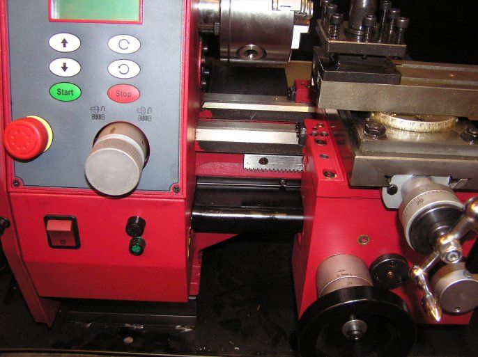

      A second newby question:
      The carriage on my brand new SC4 will not travel all the way toward the headstock but comes to a premature halt with a resounding hollow clunk (see first pic for amount of 'untravelled rack).
      The reason is obvious – the rear left corner of the carriage collides with the 'box' built in to the splash guard to shield the motor(?). Arrowed in second pic.
      There's an obvious fix – thirty seconds with an angle grinder and metal cutting disc would cut out about a 6x6x6mm corner of the box to allow the carriage past. Ah! but what would this surgery do to my warranty I ask myself.
      Any comments/suggestions please.

        Hopper
          @hopper
          I would talk to the guys at ArcEuro about that. If you cut that box open it will let swarf into the motor area inside which probably is not a good thing. You might be bettor off to elongate the cover's mouinting screw holes and slide the whole cover back that 6mm if you can, without opening up gaps for the swarf to go through.

                    Hopper: elongating the holes would be a better way – though funnily enough the whole side of the 'box' facing the chuck – where you'd expect the swarf to be coming from – is completely open (ventilation for motor?) so the cut-a-bit-away solution would make little difference to possible muck on the motor.

                      The guard might have enough internal clearance to just allow it to be moved rearwards the small amount necessary. I'm certain any sensible modifications would be allowed by ARC, they are a very good company. Phone them up and put them in the picture first.

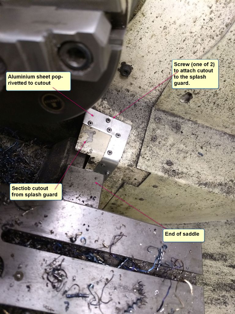

                            I had exactly the same problem with my 12×36 Geared head lathe. I needed to machine a backplate for an ER 30 chuck and the saddle was blocked by the splash guard. It was a big problem to remove the splash guard 'cos the lathe is right up against a pillar. When I eventually removed it I decided that I didn't want to repeat the effort ever again, so I cut a 'trap-door' out of the splash guard and shaped a bit of ally sheet suitable to pop-rivet to the cut-out trapdoor which could then be screwed to the splash guard. I can now easily remove the trap-door f I need to move the saddle close to the headstock.

                              Gary Wooding
                                @garywooding25363
                                Posted by Howard Lewis on 03/08/2020 14:30:05:
                                As long as it does not encourage swarf to go where it it shouldn't, can the splashback be spaced away a little further?
                                In my case, no. The motor is right behind the splash shield. As you can see in the photo, I've already extended the guard away from the bed (to the right in the photo) in order to accommodate the DRO Z-axis.

                                  PROBLEM SOLVED.
                                  First thing this morning a phone call from Ian at ArcEuro saying that he'd seen my post here and would help sort out the problem.
                                  An exchange of photosand some discussion produced a simple solution: as suggested by Hopper above, elongating the fixing holes in the guard with a file provided enough clearance to do the job.
                                  Great thanks to Ian and ArcEuro – it's a real and unusual treat in this day and age to receive such first-class, immediate, helpful and friendly customer service.
