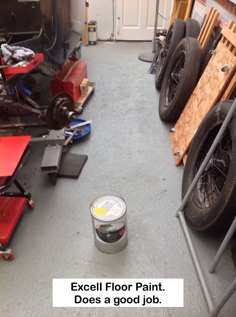

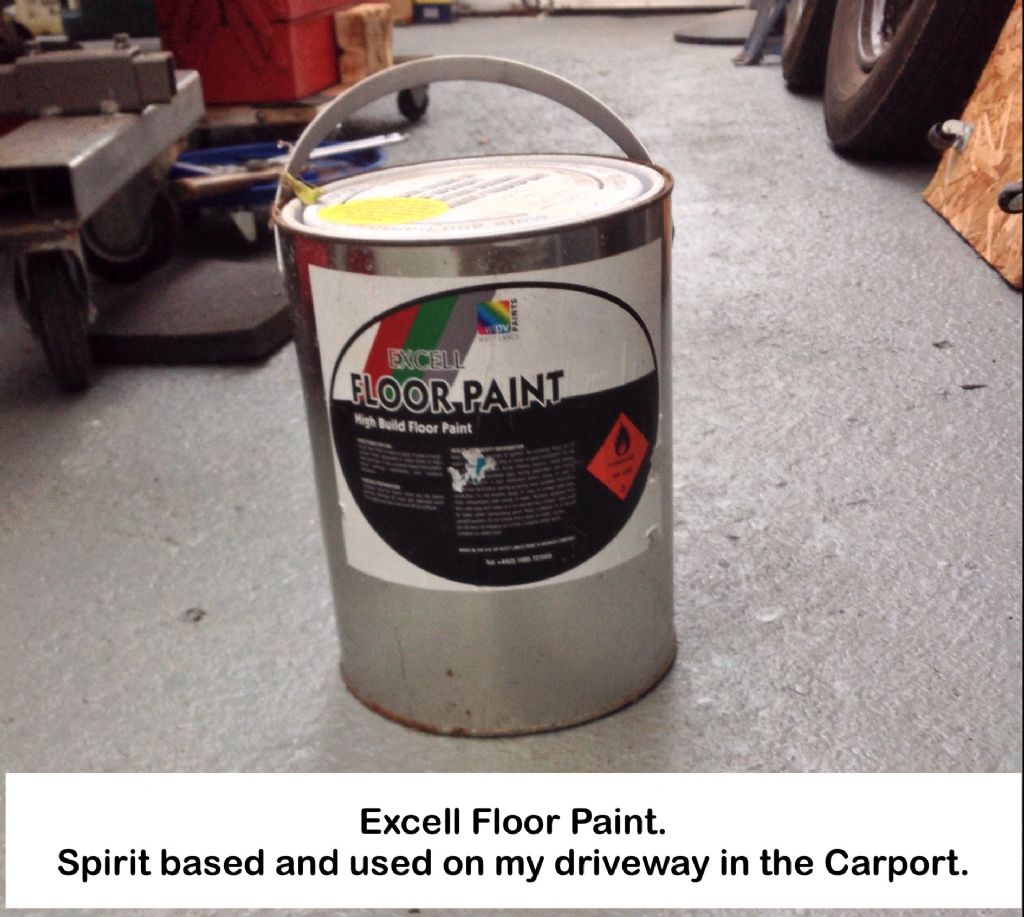

                  Here's what I used in the driveway after finishing the Carport:
                  Concrete Floor Paint
                  Result:
                  Don't remember who I bought it from, but did spend days/weeks researching/searching.
                  The price of 2-pack put me off.
                  This is my hobby, not some of the manufacturing facilities that make me drool.
                  Geoff – No more oil/grease stains and concrete dust.
