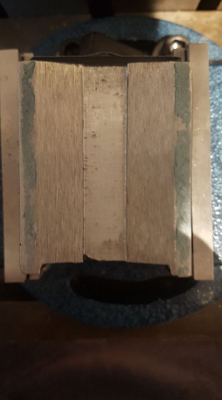

        So I decided to try my hand at scraping, and figured a good first project would be my cheap magbase, which seemed to rock like a rocking chair on two of the corners when placed on the surface plate.
        As I started scraping, what to me looks like a pretty good pattern started appearing, but i cant seem to get rid of the rocking — when i take one pass on the high corners, it simply starts rocking on the other two. I wonder if I'm making a beginner mistake of some sort, or if it's simply the nature of having an extremely small contact area on the magbase?
        #448547
        Mike Poole
          @mikepoole82104
          Although it rocks on two corners only one is high, it may be worth working on one high corner only.

            Are you scraping away all the blue? I think you need to start breaking the blue up into smaller pieces each time. Do a rub on the plate and put up a picture.

              If you have something that is rocking the bluing can be misleading. Imagine trying to blue a convex lens. As you move it it will roll and the blued area will be larger. A better strategy as Mike says would be either work from one corner or try to ascertain where the ridge or high spot is and remove it by rough scraping.

                It is probably better to think of the thing resting on three points, rather than rocking about two …

                  I agree with the suggestions above, but also the small area (I assume 40-50mm square) means you will have to remove very small amounts of material.
                  Watch you don't end up with the classic 'dining table to coffee table conversion'.

                    You don't really need a scraped surface on a mag base. Assuming you are talking about the run of the mill dial indicator stand type with shallow V groove up the middle and thus standing on two narrow edge strips.
                    You might be better off to  tape a sheet of 800 grit wet rub paper on the surface plate and carefully rub the mag base around in a figure 8 pattern to get it flat. Then finish off with some 1200 grit same method.
                    Otherwise, be careful too that your rocking is not due to tiny burrs around the edges of the base surface. Dress with a small fine file or rubbing stone around the edges after scraping. And rub a fine stone over the scraped surface to knock down any burrs thrown up by scraping on the flat surface itself.
                    So you might as well go straight to the wet rub paper method really.

                          Posted by Buffer on 24/01/2020 07:34:12:
                          Rich
                          Here's my rub: 83291438_189347975483943_5830121927670235136_n.jpg
                          Although to me this looks somewhat decent, some of the corners seem to produce a hollow ringing sound when tapped, as if there was some rock to them. at this point, however, I'm starting to feel like this changes depending on the exact position on my (second hand) surface plate, and am starting to wonder if maybe I'm approaching the limits of what my plate can do.

                                  Have you run a 0.001"/0.0015" feeler gauge around the joint when it is on the surface plate ?
                                  The feeler will enter at the gap & show you where you don't want to be acraping – it is easy to rock a part when bluing it & get a false sense of what is touching. My former fitting colleagues used to thump all four corners of (larger) parts when placed on the plate to feel if a corner was high & not resting on the plate, then work the diagonally opposite corners until the part sat flat in contact. Only then would they start to work on getting alignment & when close to alignment start working on getting a good bed. They always checked around the part as they progressed with a thou (0.001&quot feeler gauge ("tester&quot & when getting close would refer to progress on the part as being "tester tight".

                                    Nigel, I dont even own a set of feeler gauges, much less a specialty 1 thou shim stock — i wish, though 😀
                                    Thumping all four corners is what's giving me the idea that something may be wrong — the base is not rocking visually, but thumping corners makes a ringing sound that makes me believe something is off.

                                        I agree with Hopper here – try gently moving your mag base around (in a figure of 8) on a fine grit paper and look for bright spots on the edges where it may have been 'bumped'.

                                                  Well, mystery solved — I properly scrubbed my plate down, got rid of all the little dust particles on it, and suddenly, most of the rocking is gone. Shame on me for not doing that sooner 😀
