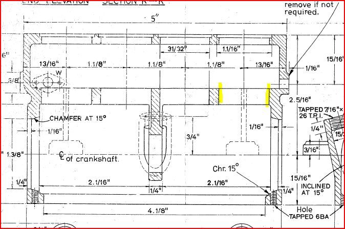

        Gentlemen, I have stumbled into a problem while boring on my micro mill. It has to do with oscillation of the whole mill and appears to get worse the deeper I go.
        Long story short : Dropped a clanger when boring the cylinders of the sealion block eg forgot the layer of aluminium below the head level which forms the water jacket. Turned a centre finder plug. After aligning the bore fixed a longer boring bar to the boring head.
        Now as I bore down into the second layer an osculation sets in (nominal SFM 1200ish) and no amount of speed alteration will cure it.
        I'm guessing it's a combination of boring bar flexing as it is too long and the off set of the boring tool throwing it out of balance too.
        Any work arounds people?

                                              Sounds a lot too thin, assuming your head holds 1/2" tools then either a 1/2" bar with a HSS toolbit at teh end or one that is sold for boring heads with a 1/2" shank and slightly reduced neck dia.
                                              Sketch here to show the job in hand
