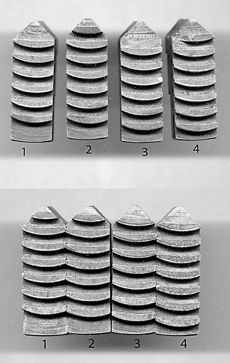

      While looking for something (which, needless to say I didn't find!) I came across a used 4" Burnerd 4-jaw SC chuck which I had forgotten about. It was a show or autojumble purchase in the distant past, and I had presumably been impressed by the fact that it had both sets of jaws. I started to check it out, and changed from the outside jaws, which were in place when I bought it, to the inside jaws and was puzzled to find that they did not meet in the centre. After several attempts I finally persuaded myself that I had not made a mistake inserting them, looked at the teeth and realised that there was a problem! (upper panel in the picture). Obviously these are the set which I would most often need. The cost of new replacements would be rediculous, and the chance of finding a used set of four is in the hen's teeth category. Could I grind off the undamaged first tooth on jaws 2 and 3 and the damaged tooth on jaw 4 and just put up with the resulting loss in maximum capacity? The scroll appears to be OK. The good set are in the lower panel for comparison
      It was definitely a case of caveat emptor – I should have been alerted by the tool marks on the face of the body and the fact that the outside jaws were installed, which are much less likely to be used routinely.

          If you insert each the broken jaws one revolution of the scroll "late", It should work I would hope. Not as robust though and a bit of a faff.
          #477901
          JohnF
            @johnf59703
            Niall exactly right, grind off the tooth on jaw 2 and the remains of the one on jaw 4 also make sure there is no remnants of the broken off jaws on 1 & 3 it should then work OK but as you are aware with reduced capacity.

                  Alternatively you can try reordering the fitting sequence so that from your photo jaws in number sequence go into the chuck in order sequence of:-
                  Jaw No 1 2 3 4
                  Seq No 3 1 4 2
                  I have a similar problem with one of my chucks and have found this works well!

                    Insert number 2, then 4, then 1, then 3. Each in their proper positions, not sequentially. That should do the trick without making two of the jaws weaker.

                          Yes, reordering the sequence works fine and will make the chuck usable for now. I suspect it may no longer be very precise, but I'll strip and clean it and see. Anyway, it's useful to have for quick and dirty jobs. I'll keep my eyes out for a replacement set, but in my experience even a set which is nominally correct can need some fettling to work smoothly. Sets of four are rare.

                              It will be just as precise but just not for use at the largest normal chuck opening, that is all. Being a PB 4 jaw self-centring chuck it is likely quite a good one.
                              I have a 4-jaw self-centring chuck and while it is good for perfectly round workpieces, it is not so good on anything that may not be. Being the diametrically opposite jaws that failed, I might suspect it was tightened, at too-full opening, on a piece of not quite round material.

                                        Just insert the offending jaw one rotation late. Mark it with a black permanent marker as an aide-memoirs . I have 3 sets of soft jaws just like that.

                                            To check the capacity of the chuck, just remove the chuck and lay it on the bench. Remove the jaws and lay them on their sides next to their slots. Line up the teeth on the jaws with the scroll teeth and move them until at least two teeth overlap, not including the missing tooth. That will give a good idea what you can get away with for maximum diameter. Somebody tried to hold something with only one tooth engaged in the scroll and broke it off. It will always be the same jaw as that one is the first to end up with only one engaged. When you see the price of even second hand jaws, a new chuck from ARC gets more attractive.
