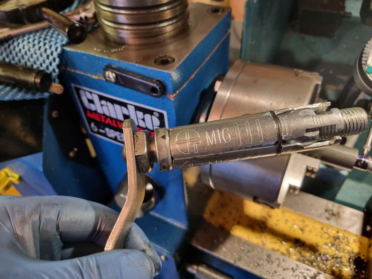

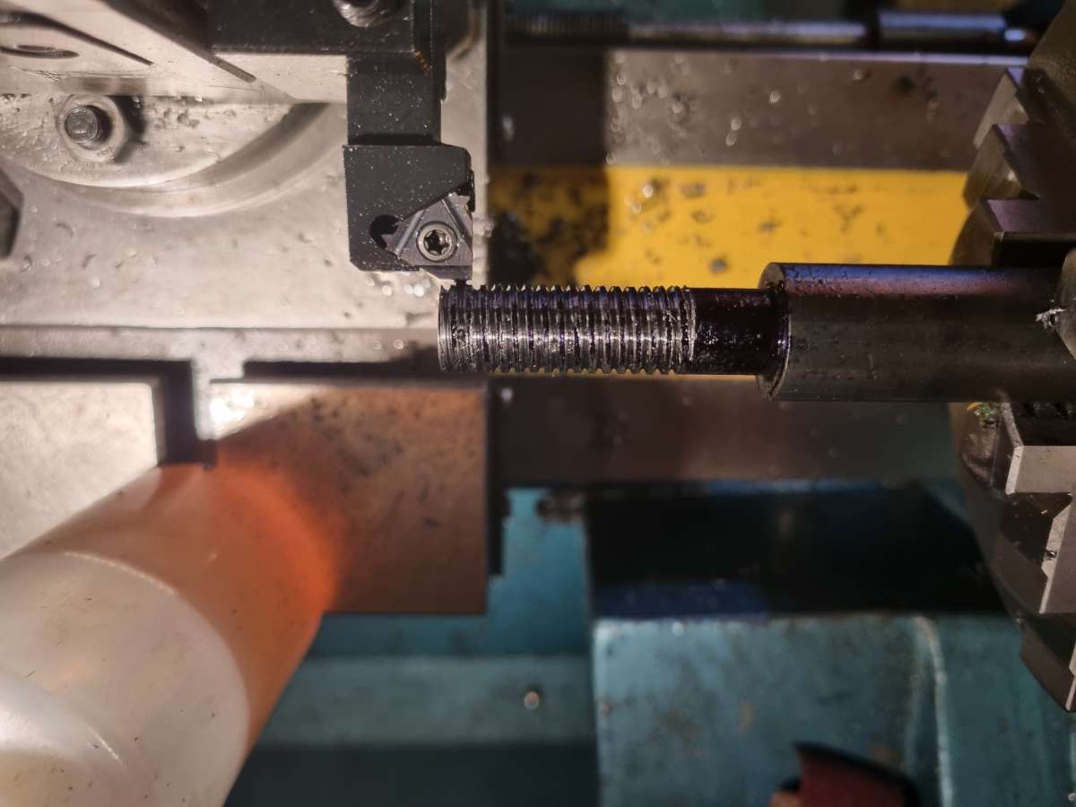

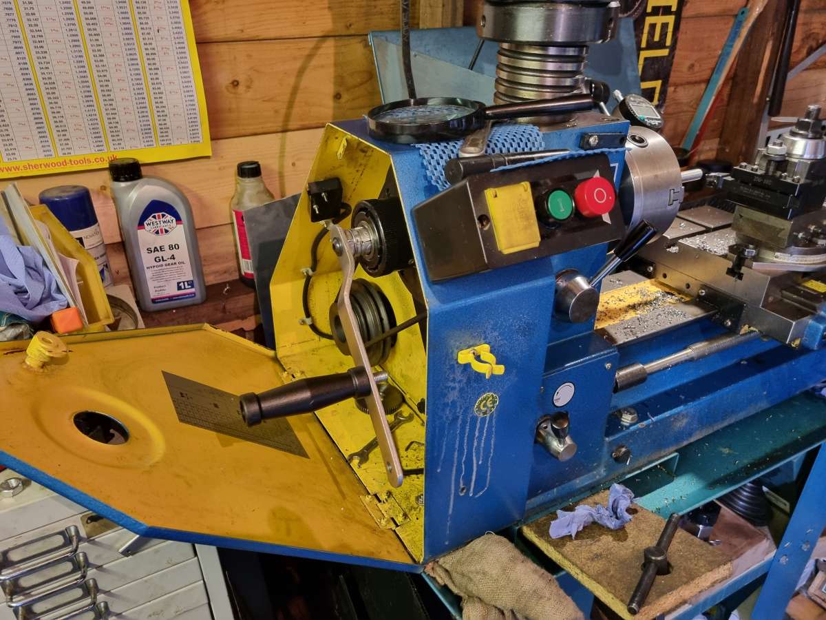

                                I just wanted to provide an update on this.
                                I got the carbide tip as Julie Ann suggested. It worked a treat. Yes, it was overkill for my needs and cost more than I wanted to spend, but I have it now. I got that from shop-apt.co.uk. I am very happy with their (helpful and fast) service.
                                I sorted the handle. I had designed it long ago and bought the parts (simple Rawl Bolt and cheap winch handle). Simple mod of the rawl bolt head to accommodate and fix the winch slot (with M8 pan head from Kays – they’re always helpful). Slight mod to relocate the handle – to avoid having to fully open the cover.
                                Selecting the gears was a palaver. I think John H may have commented on this in another old thread. Wire routing is blocking access to the gears. The Manual drawing/charts are confusing for gear lettering/position. But the gear combination info is correct, so I got there in the end.
                                I turned the material to 1/2″ OD as expected. Threaded by Hand (as advised), all good. My handle worked a treat. But the bolt did not fit. I had to cut deeper to approx 12.5mm before it would fit the job/female (fyi that is also the same OD as the 1/2″ BSW bolt that I had sourced). A doff of my cap to Howard.
                                So the job is done, and I’m happy with the results.
                                Some pics below. Thanks again to everyone who commented.
                                20250411_12222620250411_121908
                                20250408_170841
                                cheers
