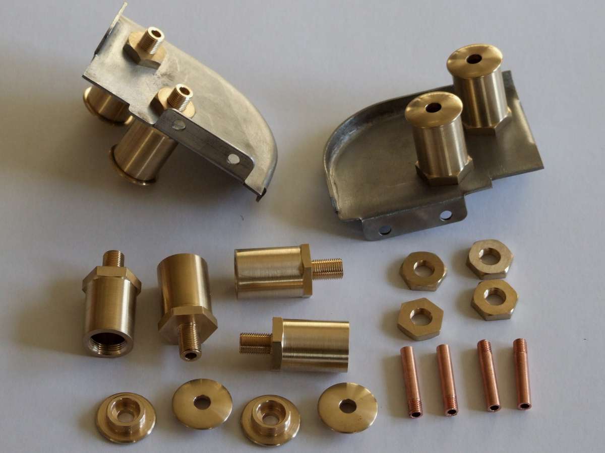

                                        All the external threads shown below were screwcut, 32tpi and 40tpi, both Whitworth form:
                                        2020_11260003
                                        Julie
                                        #790742
                                        Danni Burns
                                          @danniburns84841
                                          Hi Jason
                                          I will use that die down whatever way I cut it. It would be no hassle to grind a 55-degree tool, but I’d also like to get some good use out of that Tool.
                                          I need to do some M15x1 external threads for a couple of indexing Plunger’s (designed by Mr. Bernard Towers). I have a die for that also, so it will be interesting to see how that goes.
                                          Julie – Thanks again. I saw the APT site  – It’s around £10 for 1 tip (£4 each + P&P + VAT). I bought one for the heck of it and also got a 16ER AG55 Tip (also £4 + vat) for any other Imp threads.
                                          Those are some lovely looking parts there. Clearly, you’re making a Gin Still.

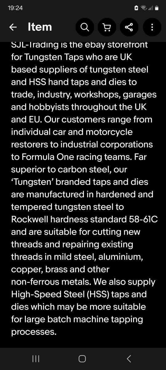

                                                  Like Clive I question if you have looked up the right one. Unless you are running the die very fast in a machine then for hand tapping carbon steel will be fine.  Noel.
                                                  #790825
                                                  Danni Burns
                                                    @danniburns84841
                                                    Hi Clive.
                                                    Yes you’re right. Applologies for the incoreect comparison.
                                                    It says Tungsten as opposed to CS or HSS.
