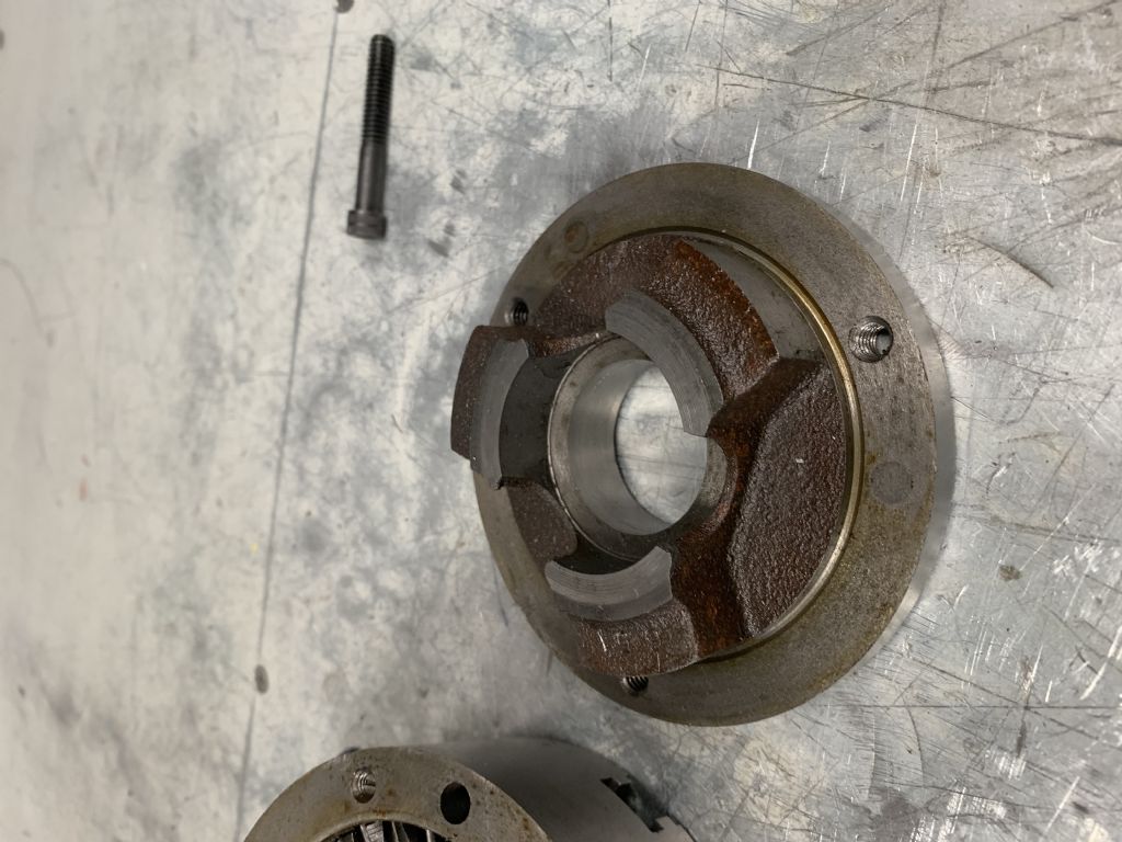

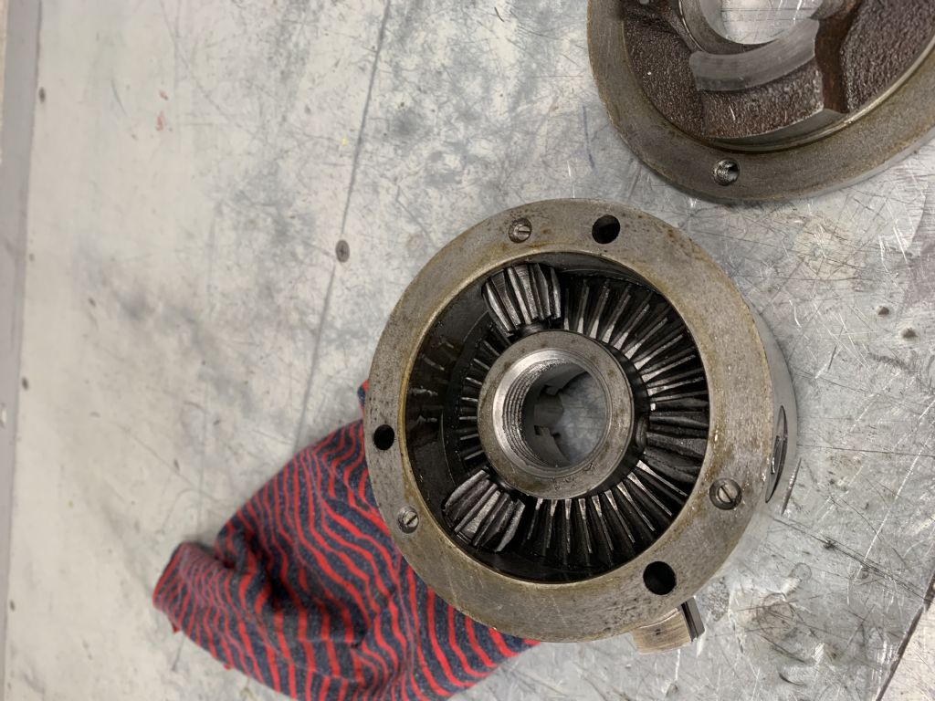

      I am in need of a new chuck for my myford ml10 lathe. Being relatively new to machining, I haven’t needed to outfit an aftermarket chuck to my lathe.
      I was looking at purchasing this unit from amazon **LINK**
      That being said, do I have to machine a backplate from scratch, or are they available to purchase? Which steps do I need to follow, to do this properly?
      Could I reuse the backing plate which came off of the old burnard 100 mm chuck… or is it specific to burnerd?

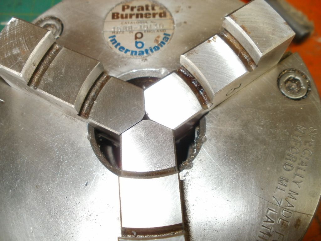

            Hi Jeremy
            Your current chuck looks from the pictures to be an internally threaded chuck made specifically for the Myford 7and 10 lathes, so if you had to replace the chuck for a different backplate mounted type you would need to purchase a backplate from one of the suppliers. These are obtainable part machined with the spindle thread and register already done. If you look on the Lathes uk website there is a section on fitting chucks which explains very well.
            Internally threaded chucks with integral backplates for Myfordsare available from places such as Rotagrip, who are a chuck specialists.
            I would seek advice from the ML10 users on this forum before trying a 125mm chuck on your lathe, might be a bit big and heavy for the spindle and would increase the overhang from the bearings.
            But first I would agree with Speedy builder5 that your existing chuck is of a good make and are robust, and wonder what the reason for replacing it is. Unless anything is obviously broken or strained (sometimes the scroll can be damaged by careless use) A good clean and lubricate can make a world of difference.

              Jeremy
              Further to my previous reply, just had a look in your album and saw the pictures of the chuck with apparently a jaw missing, is this correct? If this is the case as the chuck you have looks to be in fair condition, it's worth trying a wanted ad on this site and the Homeworkshop site. Rotagrip used to supply spare jaw sets but they were quite expensive, almost the price of a chuck.
              Hope this helps

                        My bernard chuck had one tooth missing on one of the teeth…then another one broke, then another. This is all on the same tooth. Basically I dont want to replace the chuck, but need to due to damage. That, and I am in need of a replacement fairly quick here…go figure!

                          That explains it. Myford integral threaded chucks like you already have are available from the likes of Rotagrip and i believe Chronos list them too, these will fit straight on with no machining.
                          If you don't mind turning the register on a part machined backplate I can recommend the very reasonably priced ones from ARC , very pleased with a chuck I bought from them, they supply backplates too.
                          Choice is dependent on your budget but all the above companies offer a good fast courier delivery.

                            I have a set of OUTSIDE JAWS for sale listed in the classifieds on this site which will fit your Prat Bernerd 1588-10130 3 jaw chuck. Note these are OUTSIDE JAWS but will allow you to still use your chuck.
