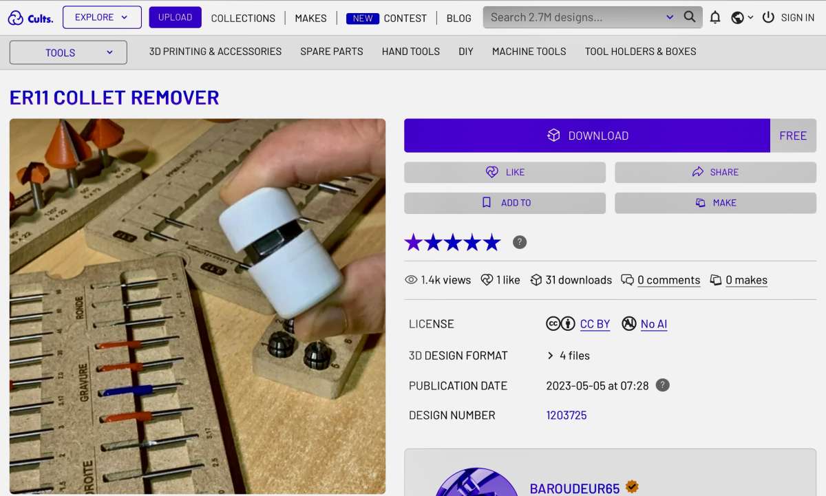

                                Back to the OP, I saw this:
                                https://youtu.be/Gk_412y1CUQ?si=yNOGGQqADaBVfywg
                                #819356
                                Vic
                                  @vic
                                  £300+ For a 3D printer and my problem is solved … 😂
                                    interesting, thanks
                                    clearly it’s not only us who have this problem?
