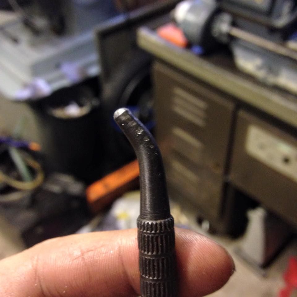

                I remember picking up a centre punch from the car boot tool man for 99p….. I remember thinking how hard could it be to get a centre punch wrong….. I'll chance it for 99p…..
                it lasted 20 seconds, blunt after the first hit, domed after the second and bent on the third…… I was only using a small tapping hammer!!

                  WOW, a lead centre punch !

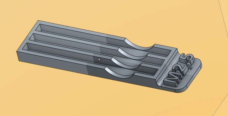

                      Posted by Neil Wyatt on 31/05/2019 10:59:01:…Fortunately I finally remembered where my M2.5 taps and die are (Q – why aren't they with all my other taps? A-I was planning to make a box for them)
                      Neil, time to 3D print some like these…. smiley
                      tap boxm2.5.jpgOriginals are on Onshape at Tap boxes
