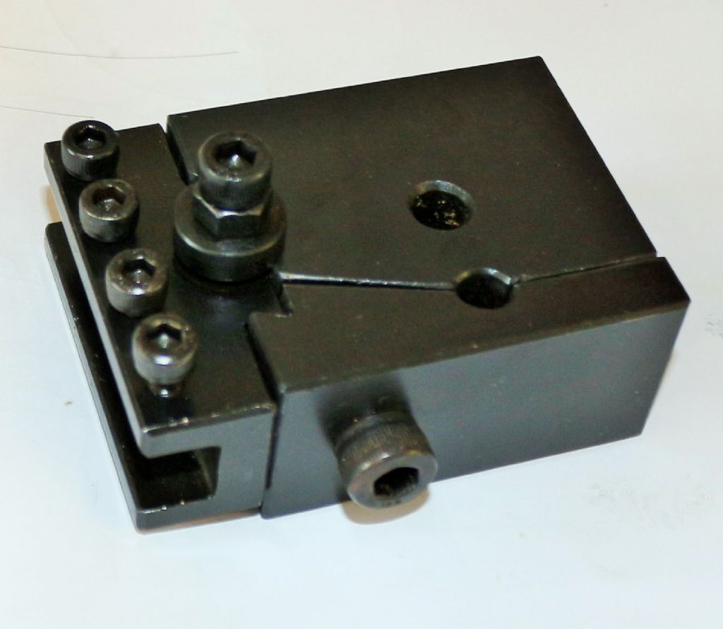

      Some time ago at a ME exhibition I bought one of these quick change toolposts. I knew that it would not fit my Myford Super 7 but I thought it would be relatively easy to modify by opening out the central hole.
      I am just a bit puzzled by the other hole. I find that the dovetail slot clamp twists significantly when it is loose. Is there supposed to be a dowel in this 'split' hole to prevent the clamp from twisting excessively in use or is the clamp fine as it is?

          At first I thought the hole was for stress relief but on looking more closely is it for a pivot?

            I also thought it might simply be to lose a possible sharp corner and or help with the manufacturing process.
            I will open up the hole and have a go at using it. The twisting might be reduced when the whole block is clamped onto the top slide. I just wondered whether something had fallen out of the box.

              There should be a dowel of some sort and the clamp pivots on it.

                You might consider turning it upside down. If you think of the direction of forces when facing and most cutting it is currently against the add on piece and the screw thread.

                  Bazyle, do you mean that the horizontal cap screw should face away from the operator rather than towards the operator?

                    It's definitely missing a dowel, I have one I bought at one of the shows maybe twenty years ago. Came with one holder and I bought two extra. When I got home all three holders must of been machined in different centuries! One fitted, one fitted almost sort of and one didn't fit at all! Tossed the lot in a box under the bench and for all I know they are still there!

                                That style of tool post doesn't necessarily need a dowel in the hole.
                                Accepting that the clamping geometry is inherently unsound the system can either be made to pivot or come up tight when the flat surfaces parallel to the opposite side of the post come almost into full contact when locked.
                                In the first case a dowel in the hole provides a pivot point.
                                In the second case its important that there be no corner to pivot of at the junction of the two faces hence the hole. Considering the action of a system with a separating spring under the locking screw its clear that as the lock is tightened up the virtual equivalent of a pivot point slides along the flat faces as the angle reduces. Theoretically, for best performance, the virtual pivot should disappear into the dowel hole before full lock is achieved.
                                It is perhaps instructive to consider the exact angles of the dovetails and accuracy thereof needed for theoretically proper operation of either version. They are clearly required to be different.

                                  I opened the central hole up to fit the Myford Super 7 toolpost stud and tried the 'system' as it is (without a pivot pin). It seems to work quite well so far.
