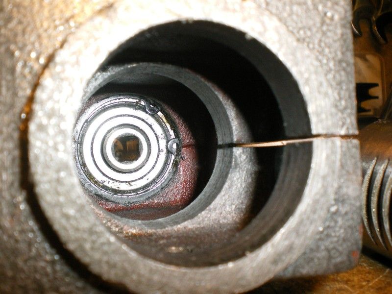

      Evening all I'm new to this site as I have a problem.
      Does anyone have a drill press and know the ins and outs with them?
      I have a wee B&Q powerbase one and lately when I have it running its been vibtating badly. I have worked out that this is due tothe front pulleys that turn the chuck, is liftingon the square drive shaft. I push it back down with some force and all is well for a few minutes then it lifts again.
      There is a set screw to hold the pulley to the inner sleeve that sits on the square drive shaft but I don't see any screw to bite the drive shaft..
      Any ideas?
      Many thanks in advance.

              I understand the square rod drives the chuck is meant to slide up and down inside the pulley now, but why would the front pulley lift up? It lifts a good 40mm or so while the machine is running

                    Yep the grub screw is there and tight to the inner sleeve which is lined up to the flat spot. However that inner sleeve is what is sliding up

                        Crikey. That short shaft should not come out of the bearing.
                        Here is a picture of the assembly from underneath (the quill assembly has been removed). This picture is a shot of the underside of the top bearing.
                        The shaft may need to be modified and then pressed in again so it it a tight fit. It has to transfer a lot of torque. Some of the more knowledgeable chaps will provide solutions.

                          Afraid I can't help with direct experience but I found a manual on the Grizzly Tools website which may give you some ideas **LINK** . On page 28 of the document 34 in the Adobe reader shows an exploded diagram. It seems to show some internal and external retaining clips.

                            Just guessing but I think the grub screw in the pulley transmit the torque into square tube then into the spindle. I think the pulley should be a press fit in the bearings, a bit of low strength loctite should hold it in place. Can't find the fingers crossed icon.

                              Thanks Michael. That makes more sense than the conclusion I came to. It's worth trying the simple loctite solution first. I just had a walk round to the shops, and was thinking, there and back, about how easy it would be to make another shaft so that it was a tighter fit.

                                  The best thing to stick it together would be Bearing Grade Loctite(can't remember the number), with that the bearing can be removed with a normal bearing puller, it will also fill quite a big gap. I used it on the top bearing of my Vertical Milling machine's top bearing, after it spun in it's housing.

                                      641 is probably the most suitable grade.
