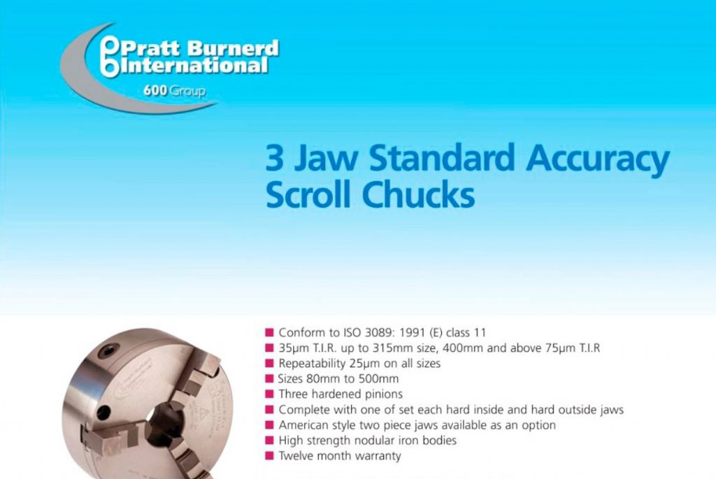

                  My PB didn't meet this TIR

                    For what it’s worth:
                    The current edition is BS ISO 3089:2005
                    from which we learn that
                    • This British Standard reproduces verbatim ISO 3089:2005 and implements it as the UK national standard. It supersedes BS 1983-2:1994 which is withdrawn.
                    • This third edition cancels and replaces the second edition (ISO 3089:1991), which has been technically revised. In particular, the tables and figures have been modified.
                    • Unlike the previous edition, this International Standard specifies only one accuracy class.
                    Hopefully, the BSI will not object to my quoting those three brief statements by way of reference.
