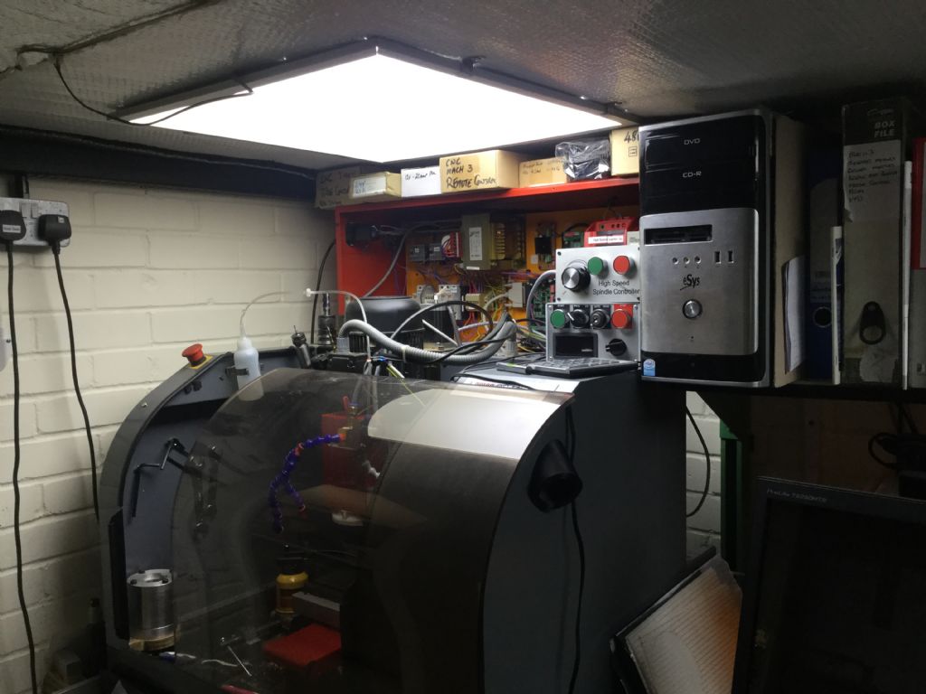

      I need to change the lights in my workshop and was going to go for the tube replacement type, but then noticed the dimensions on batten LEDs giving the thickness as only 1".
      My ceilings are quite low so, as they say,"every little helps".
      I've ordered a single replacement batten light to see what the effect is but wondered if there are any rules for positioning lights near machines to get the ideal illumination.
      My existing lights are 5 ft but 4 ft LEDs seem to be a better price, especially for the half dozen or so that I would need.

              in my cellar workshop with restricted ceiling height I mounted several 600×600 panels (each 30W-40W max) close to the ceiling – they replaced a number of spot lamps so stuck the drivers into to hole where the 50W lamp used to be – get much more uniform illumination – have a couple of small spots on stalks for use on mill + lathe

                    I too like the flat panels , the back of the Garage is only 6ft high and these put plenty of light over the machine and bench.

                            I would say vertically above a lathe spindle otherwise further away risks the tip of the tool being shadowed by the job and closer to the front will get a shadow from your head when you look closer.

                                  I’ve adopted an arrangement where I have general illumination from strips and extra lights both sides of each machine. Works for me as I’m not generally working more than one machine at a time. All going LED.
