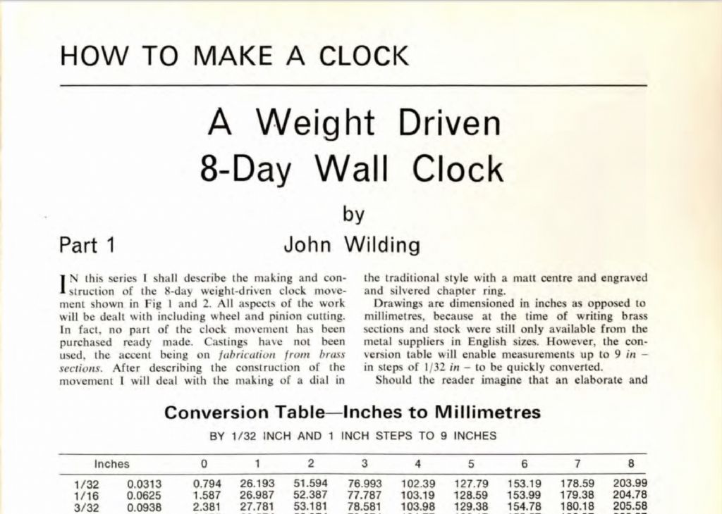

                  I admit that I was surprised by the mention of 3/32” blue pivot steel, for I have only ever purchased this material in Metric sizes … So I went back to John Widing’s series, which commenced March 1972 in the Horological Journal.
                  Sure enough : He mentions using either blue pivot steel, or silver steel, for the arbors … and, perhaps more significantly, makes a point of explaining that he has dimensioned the project in ‘English sizes’ for convenience of obtaining materials.
                  I’m not sure if the introductory note made it into the book, so I am repeating it here:
                  Like other contributors; I would use blue pivot steel in Metric sizes, and adjust to suit.
