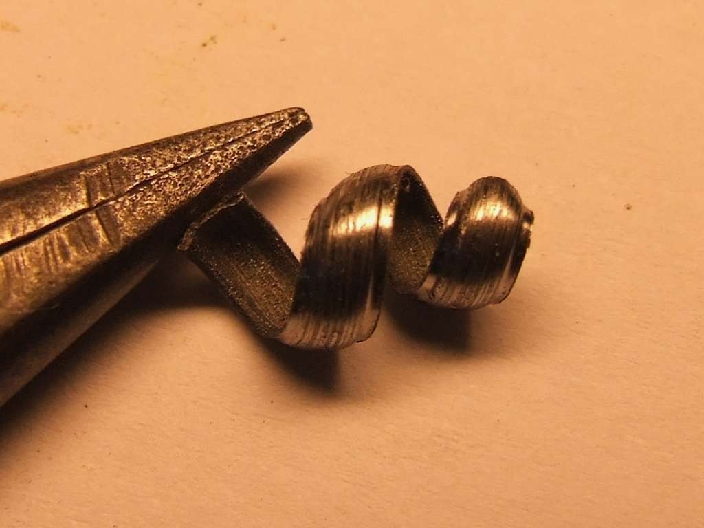

                                        Just about all the GTN type inserts which are the most common will put a curl in teh swarf so it becomes narrower than width of the cut.
                                        #836195
                                        Julie Ann
                                          @julieann
                                          Like this, although a bit more than just a curl:

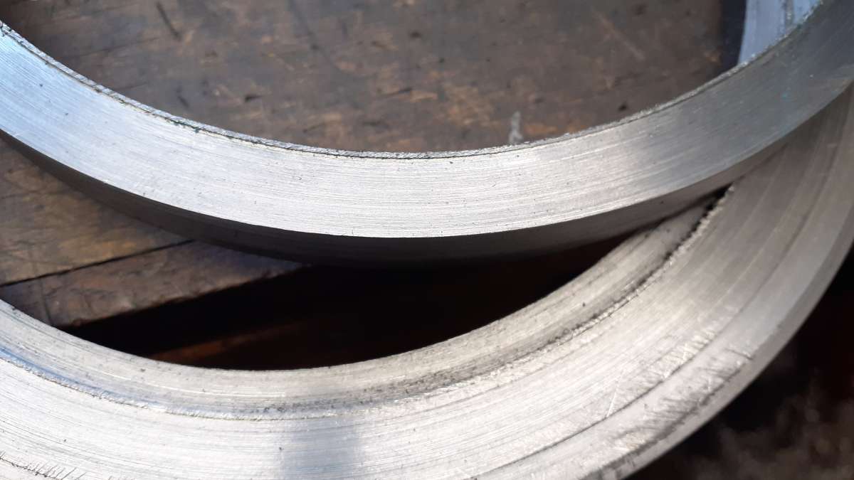

                                            An example here 200mm diameter thick wall steel tube cut with a 1.2mm x 6mm HSS blade as it was the best compromise between depth and not getting chatter/stalling had I used a wider insert that would also have got the depth I needed

                                            On smaller diameter work I could use my GTN-2 insert at 2.2mm wide or my 3/32″ wide HSS as the cutting speed on the smaller diameter won’t give the lathe problems. But if I were making a lot of small brass fittings why waste more than twice the amount of expensive brass when a narrower cut would do so I would opt for the 1mm insert.
                                            This smaller 75mm dia piece of cast iron allowed a wider insert to be used as the motor was able to run faster and therefore more in it’s “happy band”. Neither of the narrower tools would have reached.
