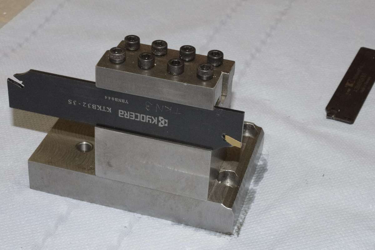

              Having a rear inverted parting off tool in a suitably stiff mount and rear locking for the saddle (carriage) helps greatly with the stiffness, particularly as theordinary toolpost and compound are eliminated. Gravity helps with swarf removal and the screw threaded spindle is still running forwards. Any hole in the workpiece makes the depth of cut less and the stickout of the parting off tool should be the minimum to achieve the thickness to be cut.
              When I made a solid block for industrial blades, 26 and 32mm to fit the Smart & Brown model A at the museum, it was bolted directly to the cross slide with 4x 8mm SHCS after first removing the cross slide to make sure the threaded holes did not get in the way of anything. The photo shows a 32mm x 3mm Kyocera blade fitted, the top half can be turned round to hold 26mm blades from 1.6, 2, and 3mm widths.
