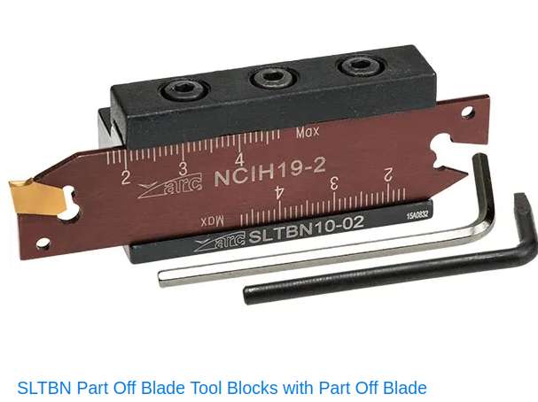

                    A parting tool won’t go beyond it’s reach, which is generally quite small.  This carbide insert blade, photo pinched from ArcEuro of one in it’s holder, suggests it can do something over a 40mm deep cut, making Ø75mm possible at the extreme end:
                    partingblade
                    Alas, how far the blade will reach, probably isn’t the limiting factor.  That’s the rigidity of the whole set-up: blade, holder, toolpost, crosslide, and the lathe itself!  Big lathes are better than small ones for parting-off because they have more beef.  In this context a Myford S7 is a small lathe, best considered ‘bendy’.
                    Substituting a Gibraltar rear tool-post will help, even more so if the lathe can run safely in reverse with the cutter upside down, not an option with screw-on chucks.
                    I’d saw it and then face-off.
                    Clever chaps have noticed the rod might be quite short:  is that so?  I’d still cut it in my band-saw but holding it in a clamp fixture I made for cutting short lengths.   The clamp is an example of a workshop problem solved by making a jig or tool that enables an otherwise awkward cut to be made.

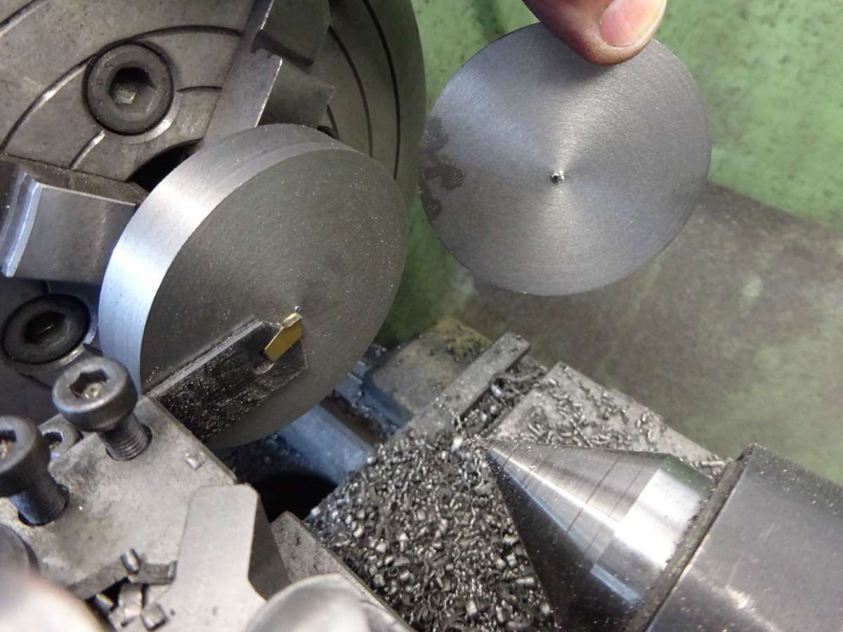

                        Dave a rear toolpost with the tool inverted doe snot need the spindle reversing so no problem with a screw on chuck.
                        Hacksaw will get it cut without parting, just do a bit at a time while working on something else. A piece of angle iron in the bandsaw and the work clamped to that will support it and is what I often do for short lengths, saw cuts through teh vertical leg of the angle.
                        If using the type of parting tool Dave shows then start with a small amount of stick out and cut to that depth say 20mm then extend it in 10mm increments. Works OK for me, this is 70mm iron
                        DSC02442
                        If the lathe is weak or under powered then using a narrower parting tool will put less load on it, this is a bit of 115mm thick wall steel tube being parted with a 1.5mm imported parting tool and holder
                        20240629_094155

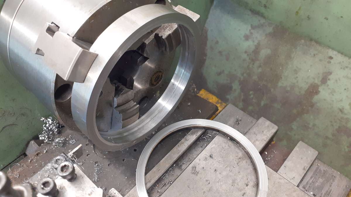

                        Chris Crew
                          @chriscrew66644
                          You may be pushing a Myford S7 a little further than it might want to go. I have a Myford and wouldn’t part with it, if you pardon the pun, for all the tea in China but it is quite a ‘flimsy’ machine when compared to an industrial or training lathe. I have parted mild steel and brass up to about 25mm (1″) in the Myford with very little problem but anything larger than that is done on my Colchester Student in which I have successfully parted 125mm (5″) noggins of mild steel to make backplates for the Myford. I held the material in the 4-jaw rather than the SC 3-Jaw because I believe it has a more secure grip. Whether this would be possible in stainless, I have my doubts although I have had very little experience with this type of material. My ‘secret’, if it is a secret, to successful parting in mild steel is copious amounts of suds applied to an inverted parting tool held in a robust rear tool-post. Being a little behind the times I use traditional Eclipse HSS parting blades which are easily sharpened and can be extended outwards as a deep cut progresses when held in J&S type holders. I use a cheap soluble oil from the local oil and grease merchant diluted about 12-15 : 1 pumped copiously into the groove but there may be special products available especially suited to stainless steel.

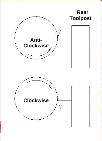

                            “Doe snot” surely wins typo of the year.  Available from all purveyors of fine tools I’m sure!
                            True a lathe does not have to be run in reverse to part off with a rear toolpost, but there is advantage of doing so.
                            My previous post misled, and hope this diagram makes what I meant to say clear:
                            rearparting
                            A lathe normally turns the chuck anti-clockwise, in which case a rear parting tool should be inverted – top of diagram.   The advantage of turning the tool over and turning the chuck clockwise (in reverse), is the cutting forces push the tool-post and saddle down on to the bed ways.   The disadvantage of parting with the cutter inverted and the chuck turning normally is that the forces tend to reduce rigidity by lifting the saddle.
                            Here comes a controversy!  There are tabs fitted to the back of the saddle to stop lifting.  But I don’t believe they have a precision function.   They are there to stop the saddle levering off catastrophically if something goes horribly wrong.   Although the bed is provided with a machined edge so that tab clearance remains the same over the saddle’s full range of travel, I’ve never seen a lathe bed that was precision ground in this area to be a slide.  Absence of precision and a way of lubricating the tabs suggests strongly to me that they are not meant to be adjusted to slide tight under the bed.   If I’m right, ‘improving’ this part a lathe is a waste of time!
                            Anyone know for sure?

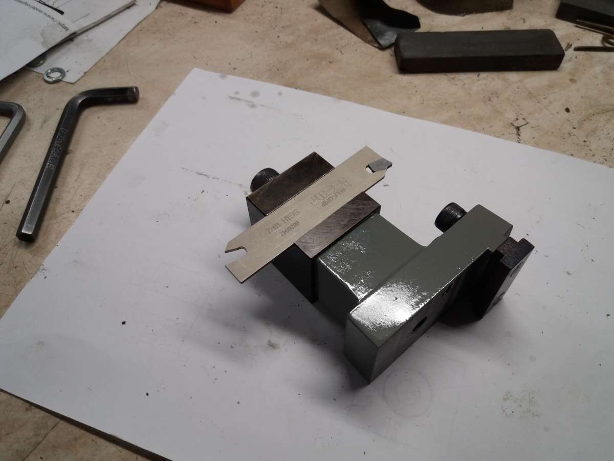

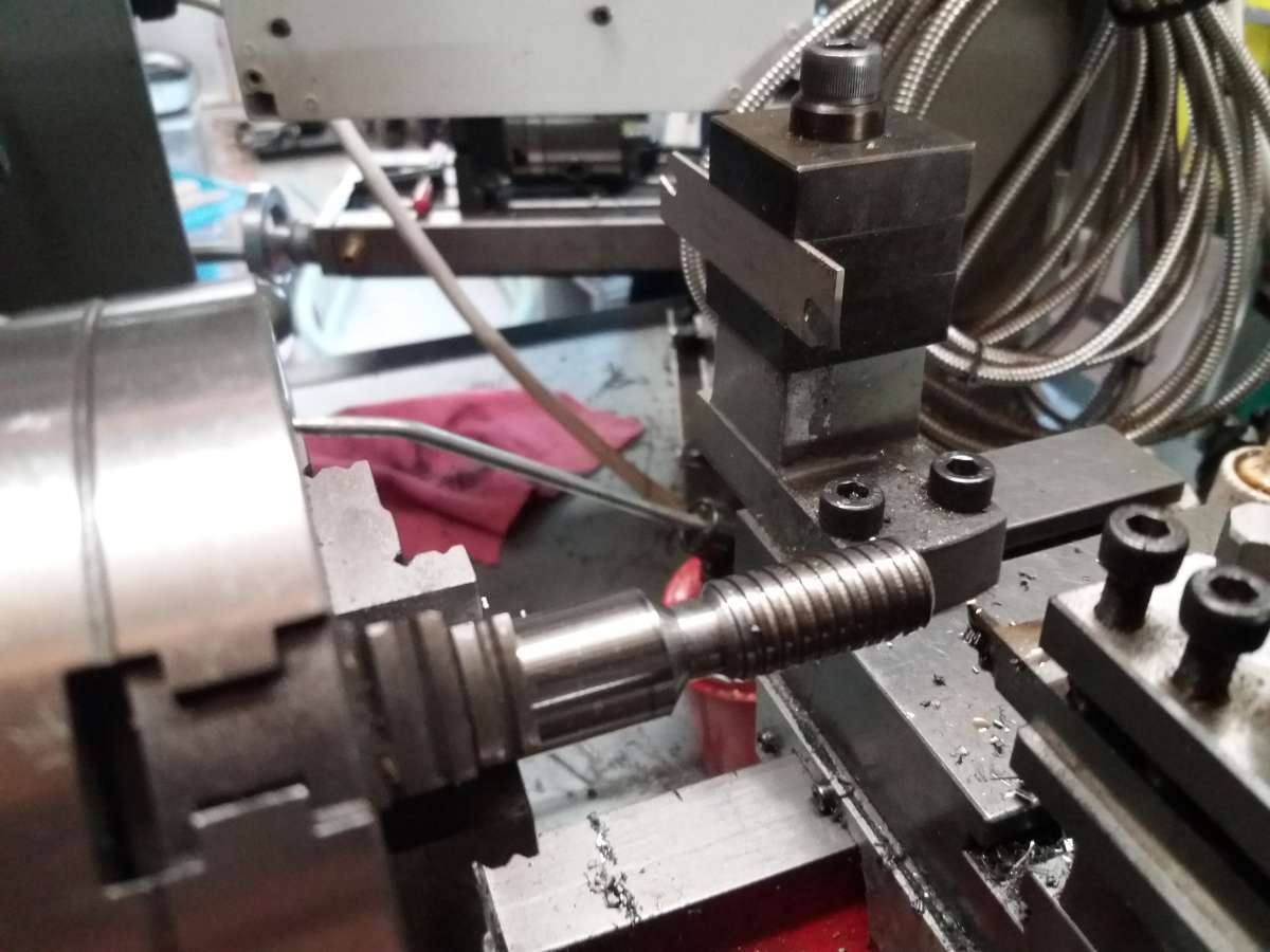

                                            This is my rear toolpost for parting off. Sollid as a rock with the cutting blade inverted it alows me to part off pieces which were imposible before.
                                            20190316_164659
                                            20190518_090018
                                            David
