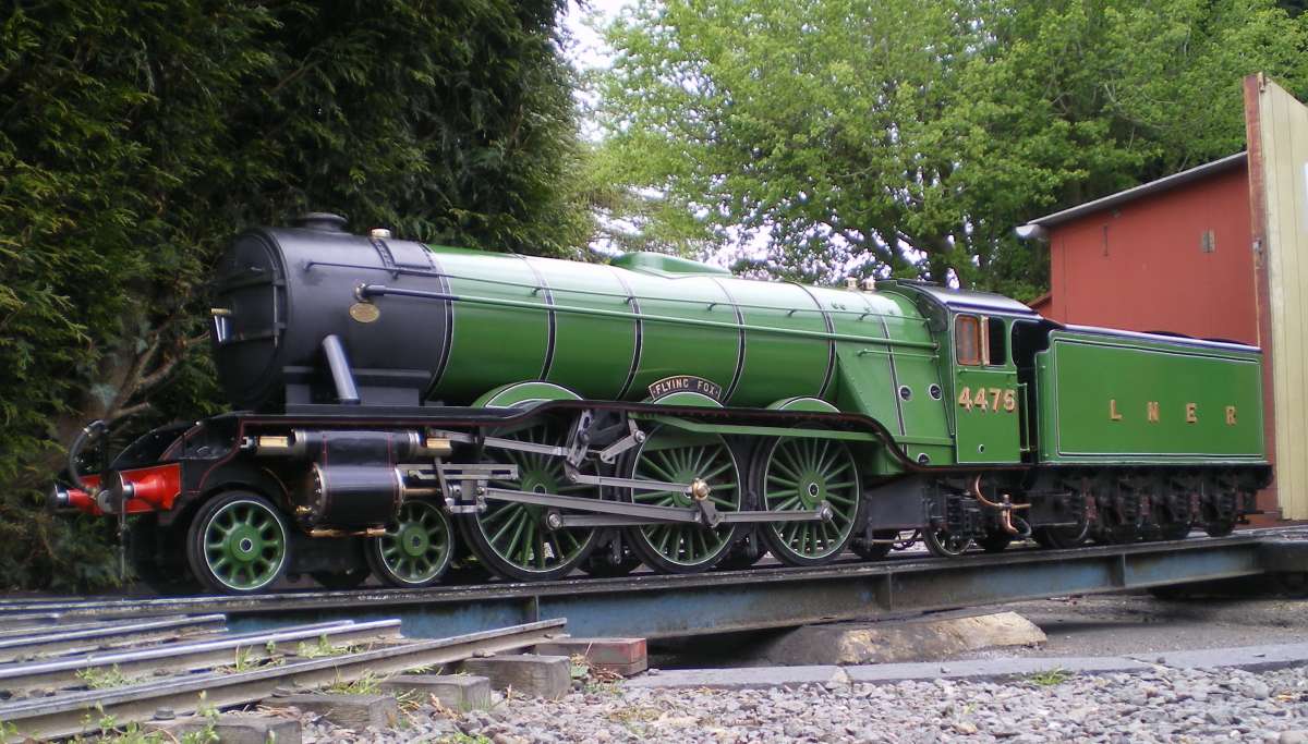

                  Greetings, rub down well, use acid etch primer, rub down, perhaps a second coat, rub down, clean, spray, low pressure “touch up gun”, gravity feed, warm, at least 18 degrees, light coat, do the inaccessible bits first with a heavier coat, leave at least 7 days, rub down, clean, another even coat, do not touch for 7 days, examine, touch up or recoat if required.

                  cropped1383888853_1043841336753702_6634063203774909452_n
                  #843992
                  Weary
                    @weary
                    Hello Ian,
                    When painting my 5″ gauge loco:
                    Following appropriate surface preparation(s) I used Upol 8 Acid-etch primer from spray cans as the primer.
                    This is also available in tins as a ‘brush-on’ coat as you have expressed a preference for this approach.  The spray appears to coat and adhere to the base surface very well indeed, even the notoriously tricky brass.
                    Note: I have not used Upol 8 primer ‘brush-on’ so cannot comment on application etc.
                    I used Phoenix Precision Paints primer to ‘touch-in’ fasteners etc.  it is ‘good’, but in my experience does not adhere as well as Upol 8 to brass and does not adhere at-all to ‘stainless’.
                    For top-coat I used a number of coats of Phoenix Precision Paints tins with about 10% thinners added brushed-on with soft broad sable brushes and rubbed-down extremely lightly between coats.  The (semi-matt light green) surface looks good to my eye with no visible brush-marks and no-one has ever commented adversely.
                    Note: I used semi-matt (‘eggshell’) finishes and have not used gloss at all so cannot comment on that finish.
                    Phoenix Precision Paints can supply their colours in spray-cans – I have never used so cannot comment.
                    For filler I used J-B Weld and car-body filler.  Note:  The J-B Weld reacted with the Upol 8 acid etch primer and needed a sequence of the very lightest of coats, drying between each application, to remain stable and not ‘show-through’ nor need additional ‘rubbing-down’.
                    Regards,
                    Phil
