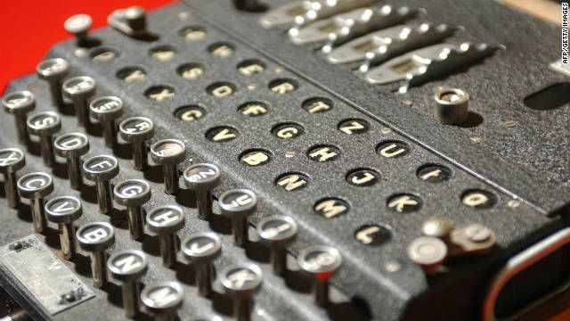

      On some wartime and some post war equipment there was a rough black coating. I don't think it was a paint, possibly some kind of powder coating.
      I recently saw it again on an Enigma machine, and it reminded me old equipment I used to have and how durable it was.
      Does anyone know what the coating was?

          Probably oven baked paint did it have a crackled finish ?
               I think it was called Stove Enamel

            If it's a crackle finish then contact an MG restoration site. This finish was common on MG dashboards and is still available as a spray from a can. It needs to be applied fairly thickly.

                Not sure I would call it cracked, more like lumpy powder coat

                  Some sort of japanning?

                        I've always known it as "wrinkle finish paint". I recently used it on a headphone amplifier:

                          I concur it is a form of black crackle paint. I have a 10" Vertex rotary table finished in this stuff. It is a real bugger to brush swarf off.

                              Thanks that looks like the right stuff
