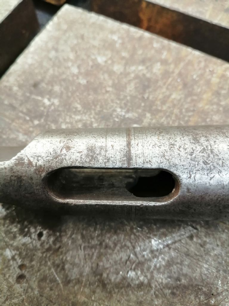

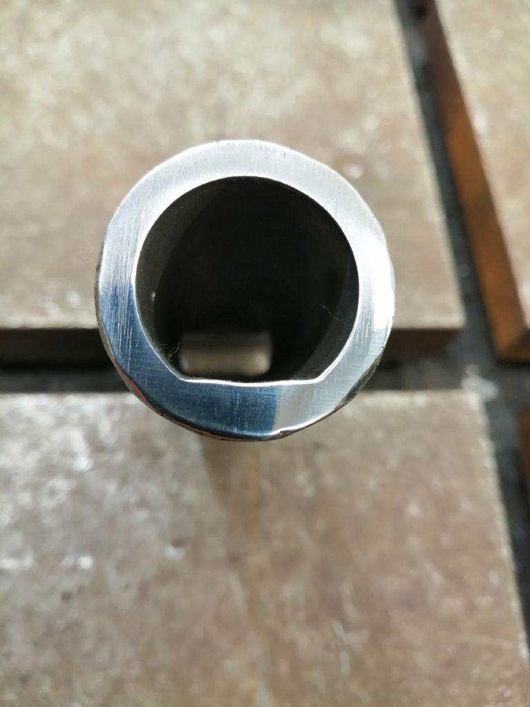

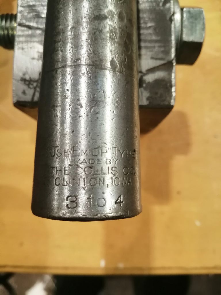

      sleeve 1.jpgHi people,
      I was sorting through some taper shank drills and sleeves in a workshop that i help to maintain. I found them in an old filling cabinet in the corner of the works.
      There were some good drills in the assortment, some up to 2" in diameter and either Dormer or Presto so worth a few quid.
      Then i came across the sleeve as pictured. At first i thought it was full of crud but it actually has a flat section inside the taper.
      I have never seen that before and so i thought i would share it with you clever people.
      So, is it a drill sleeve or something else.

          Can’t provide an answer, but iv’e also got one floating about in my drill drawer.
          #444676
          old mart
            @oldmart
            Its made in Iowa, so it could be anything. I notice the name is "use em up", I wonder if it is designed to salvage scrap MT3 tapers by grinding a flat on them? It could be worth asking on The home shop machinist forum.

              The clue’s in the name … it allows obsolete Blacksmith’s Drills [‘Armstrong Taper’ I think] to be fitted in a Morse Tapered machine.

                  Plus 1 for this. I think the idea was that it would allow the use of a drill with a broken off tang.

                    Looks like I was wrong blush
                    **LINK**
                    https://www.practicalmachinist.com/vb/antique-machinery-and-history/morse-taper-flat-side-114089/
                    Should have paid more attention to the legend ‘3 to 4’

                      Careful! Some Iowegians get testy over stuff tile that. If it came from Iowa it was probably made by Collis. They were called Use EM Up sleeves. When the tang twisted off a drill or the taper got too messed up to hold in its socket you could grind a flat on the side of the drill shank until it fit in the Use EM UP socket. I am 82 and have only seen maybe 6. Not common anymore.

                        Having sorted out what it is the next question must be how did they make a sufficiently accurate D section taper back in those days?
                        Obviously you can't ream it to size and broaching sounds difficult. I'd cut the side off a proper taper and weld or silver solder the flat on but thats very home shop guy.

                          ..Broached? ..is there a wedge-slot at the back? ..it looks like one of those processes that sprang from their gun industry..

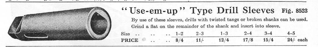

                            From old Buck and Hickman catalogue:
                            I'm afraid this doesn't answer Clive Foster's interesting question.
                            The reference to "Use-em-up" Type suggests that this was a generic item; in a perfect world such things would not be necessary!

                              Hi DiogenesII, how indeed were they made. I am back at the works tomorrow and will see if there is a wedge slot at the back.

                                I would bet on there being a slot in the back, why, because there is light showing in the photograph.wink 2
                                Incidentally, the tang on Morse tapers is not intended to provide drive torque, that's what the taper is for.
                                I would be interested to find out how that tapered hole with a flat was produced, magic maybe.laugh

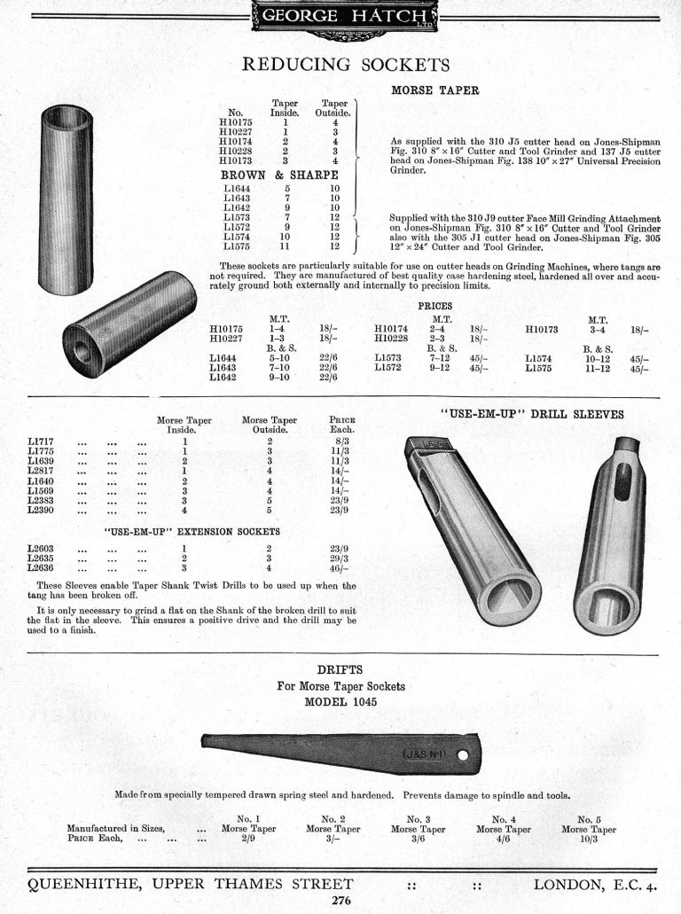

                                  Hi, yet another catalogue entry below, this is a 1963 edition.

                                    Hi, probably a forgery forged and then ground to size.

                                      I still cannot see how that hole was produced, grinding would not do it as there are no rads on the interface between the taper and the flat.

                                        I think Nick has it.. Hot forging in a die using a mandrel of the correct shape?

                                            Yes, I cannot see any alternative to the hot forging of the bore, followed by conventional turning and grinding of the outside. It probably doesn't matter if the taper is not perfect, after all it is going to house damaged tapers anyway.
                                            The slot would probably have to be extra long if some tangs were missing.

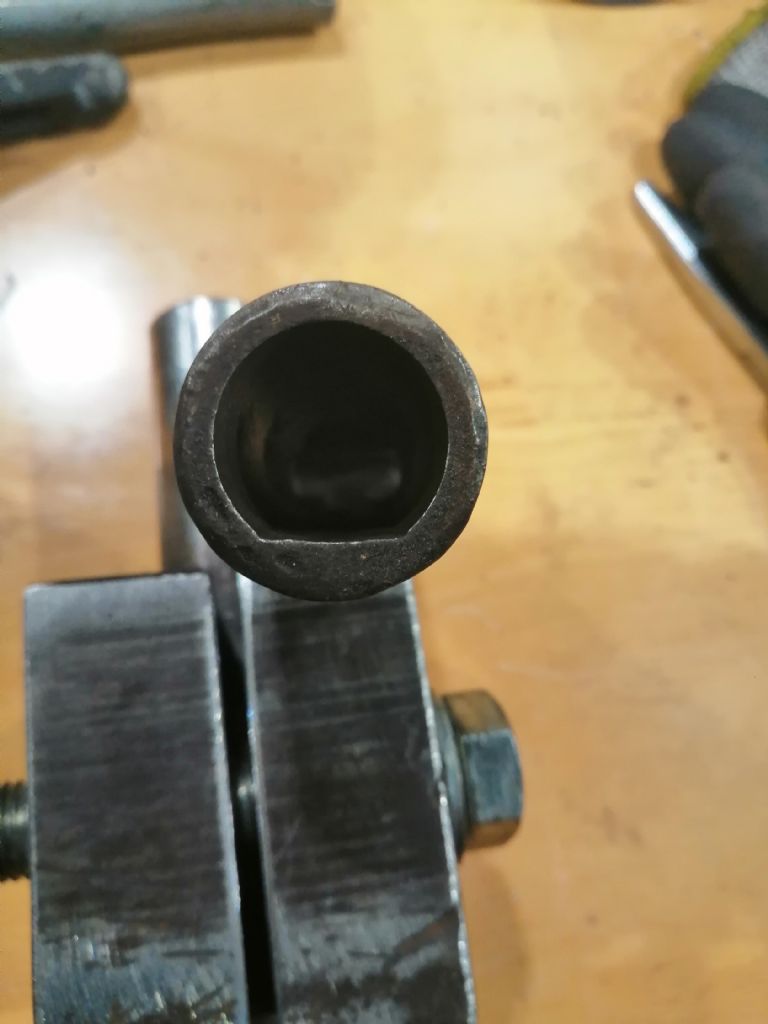

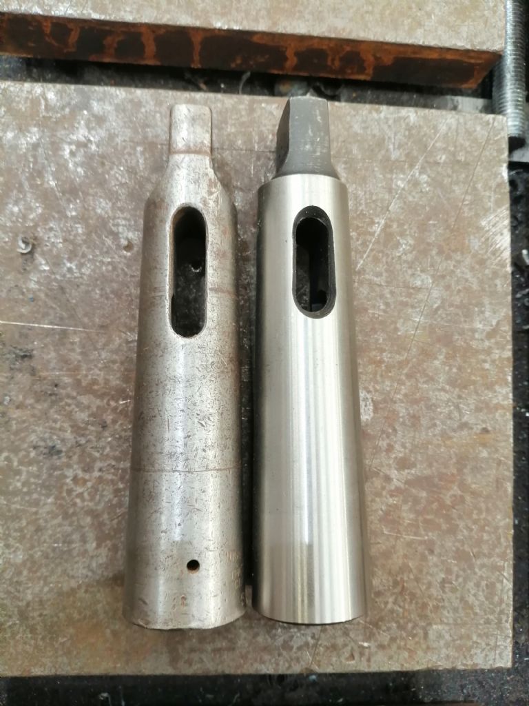

                                              008.jpg007.jpgA few new photo's of the sleeve to have a look at. I did polish the end to see if there was a join between the internal diameter and the flat section but there is nothing obvious.
                                              The drift slot is also longer than a standard sleeve's slot.
                                              Note the hole in the side, most odd.

                                                The little hole is a mystery. I had not thought of the possibility of a flat sided piece fitted in the bore. Certainly not brazed or silver soldered as that would show up after you polished the end. I recon that we will never know the full story unless a NOS one turns up for close study.
