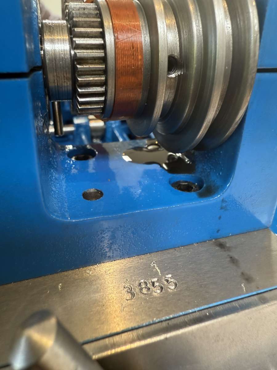

        > The amount of oil it leaking is a joke
        If it really is that bad I would bite the bullet and check the bearing. I have a Cowells lathe and using lots of oil is a signal that the bearing is slack.

          On nappa Said:
          Guy this can not be normal.
          The amount of oil it leaking is a joke it spraying oil all over the place.
          I have used it once faced of 1 ring shank 5mm wide and took off 1mm.
          The left cup remains full, I have had to fill the cap 4 times do to that amount of work above.
          IMG_5957
          It looks suspiciously like a “Friday afternoon” fitting-job to me.
          The Cowells reputation was made on better than that ^^^
          Edit: __ You might find some comfort here:
          https://watchmaking.weebly.com/lathe-maintenance.html
          #816901
          cogdobbler
            @cogdobbler
            As it is a new lathe, it may need setting up correctly. Some adjustment of the bearing may be required. You should seek advice from Cowells.

                  The most important sentence there is “I emailed Cowells and got a very prompt support reply from Colin.”
                  The lathes come with a 5 year warranty. I’m sure they will be happy to help get a new machine set up and running right. For the 3,900 pricetag, one would expect so.

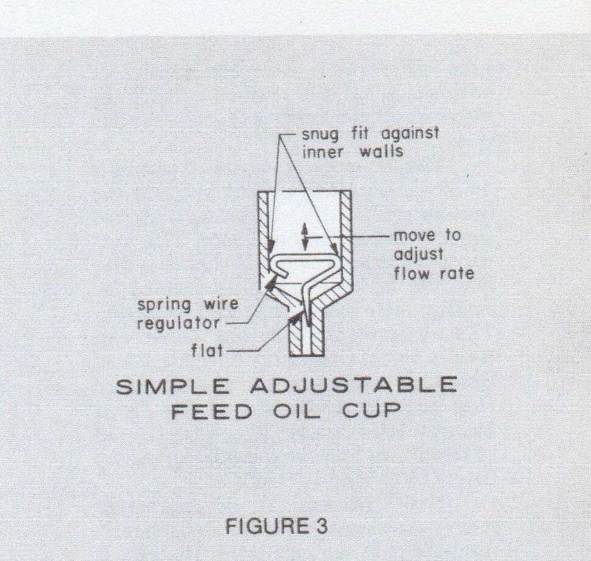

                    A more acceptable solution in my book would be to moderate the flow of oil.
                    Variable Oil Feed
                    I claim no originality for this design as it belongs to J R Senft and it was brought to my attention recently by John Slater. Given the simplicity of this design it can me bade in a few moments and flow of oil regulated to match the demand. Once fitted and set it can be forgot about.
                    Regards
                    Gray,
                    #816920
                      That’s very neat, Gray … Thanks for sharing it.
