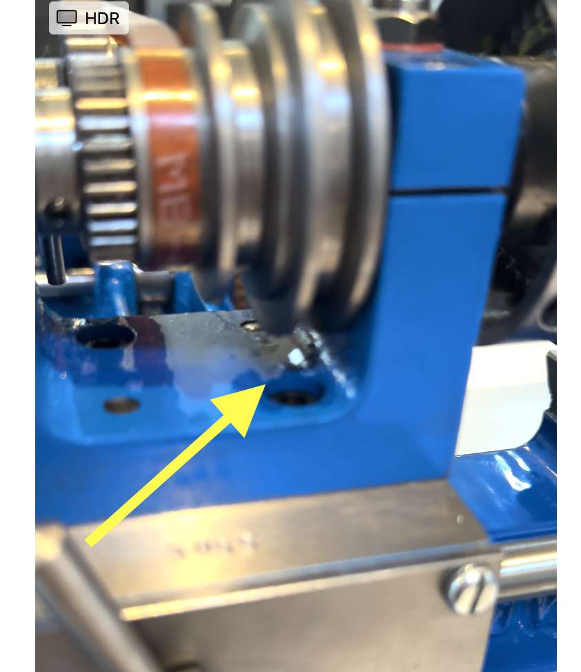

      Hi all, i’m new on here and new to making stuff on a lathe.
      I have just got myself new Cowells ME lathe. I have a question is it meant to continuly leak oil here?
      I have wiped it 3 times and rand it 3 times not longer the 30 sec each time.
      thanks all
      Screenshot 2025-09-19 at 18.40.06
      #816676
      John Haine
        @johnhaine32865
        Yes, probably. A/k/a total loss lubrication

            Yes it’s normal. Slightly annoying but normal.

                thanks guys you would think after spending 5k you would get bearings.
                      There’s method in the madness!  Imperfect bearings cause vibration and spoil the finish whereas it’s easy to make smooth plain bearings.   The main disadvantages are the need for messy total loss oiling, speed limitations and gradually wearing out.
                      Took about 5 decades for industry to learn how to make perfect spheres, so even very expensive  lathes tended to avoid ball-bearings.  During WW2 the allies and Nazis both imported high-end bearings from Sweden because only SKF made the really good ones needed for high-performance machines.  In the 50’s other makers cracked it.   Quite recently,  the Chinese Prime Minister remarked that China still couldn’t quite make the precision balls needed for ball-point pens, not cheaply anyway!
                      Today, really good bearings are still seriously expensive.   Not unknown for folk to buy a worn second-hand high-end lathe only to find that a set of specified replacement bearings cost far more than the machine!  Cheaper can be substituted, but the lathe won’t be as good as it should be…
                      Plain bearings are a good answer for the type of work done by a Cowells.

                                In reality, the plain bearing works much better than one might imagine. I too was a bit sceptical after first learning about it. But it’s incredibly rigid and accurate compared to similar lathes with ball bearings. Most watchmakers lathes use a similar arrangement, and they of course need to be super accurate.
                                But the obvious question is, why didn’t Cowells use a felt washer to retain the oil and slow the loss of oil?

                                  Same as a Myford. Oil drips in the top. Oil drips out the bottom. On the Myford you can adjust the drip rate to 1 or 2 drops a minute to minimise the mess. If there is no adjustment on the Cowells, you could try a heavier oil to slow it down.

                                        When you top up the oil how long does it last? If it is all gone over night it MIGHT be that the bearing needs adjusting. Since the lathe is new this seems most unlikely..
                                        If after some while (six months?) you are using a lot of oil then the bearings may need adjusting. Tighten down until you can feel some resistance when you turn the headstock arbor. Then back off until it spins freely. This adjustment is very sensitive – a tiny movement of the screw can make a big difference..After adjusting run the lathe at top speed for a couple of minutes. If it slows or the bearings get hot back off a little.

                                                    nappa
                                                      @nappa
                                                      Guy this can not be normal.
                                                      The amount of oil it leaking is a joke it spraying oil all over the place.
                                                      I have used it once faced of 1 ring shank 5mm wide and took off 1mm.
                                                      The left cup remains full, I have had to fill the cap 4 times do to that amount of work above.
