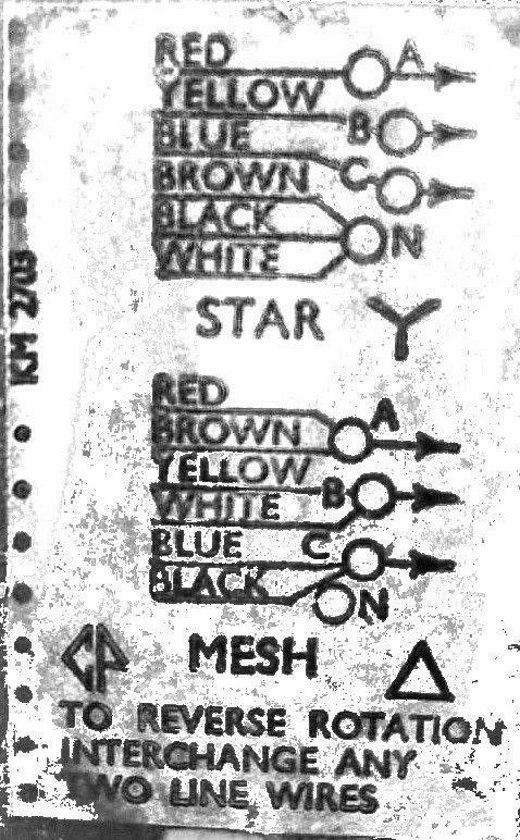

                              #125450
                              Boiler Bri
                                @boilerbri
                                The motor plate looks to state 380/440. Maybe the wire ends are buried in the windings? Are there six wires in the terminal box or three. If only three then a new motor would be easier. Have a look at _ lathes .co.uk . That site may have a full description of the machine.
                                Edited By Boiler Bri on 26/07/2013 07:39:49
                                #125457
                                Robbo
                                  @robbo
                                  Bri,
                                  The data plate gives acceptable voltage ranges for both Star and Delta connections, so it must be a dual voltage motor
                                  Wiring instructions are usually inside the terminal cover – if they are still legible!
                                  Phil
                                  #125460
                                  Lambton
                                    @lambton
                                    Bri,
                                    As several people have told you this is a 370 Watt = ½ HP motor.
                                    The connections need to be as shown to give the correct Delta configuration for 230 volt working. If the motor rotates the wrong way simply inter change any two input wires.
                                    Eric

                                    #125462
                                    Russell Eberhardt
                                      @russelleberhardt48058
                                      First you need to determine if it's a problem with the motor or the converter. Have you been able to try the converter with another motor?
                                      Does the motor turn freely by hand with the belt disconnected when not powered? Try spinning it by hand when powered (carefull of fingers!), it could be a starting problem with the converter.
                                      As has been noted, this motor should be wired in delta for 230 V operation, have you checked that? The motor is unlikely to be faulty but you could check the continuity of each winding (disconnect one if it wired in delta) with your meter.
                                      Please post the results of any tests you do.

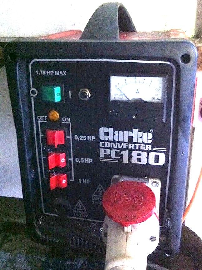

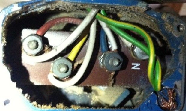

                                          Have some more pictures for you chaps as you can see it's a converter I use and it works ok on the milling machine, do i need to change the wires round on the drill motor to make this work, if the pictures end up side ways again i apologise in advance, they are the right way up in the photo album so it maybe better to looking there.
                                          Al.
                                          #125491
                                          Sub Mandrel
                                            @submandrel
                                            There's a big clue – no black or blue wire and four white ones – it looks like your motor has been rewound… or at least re-wired and the wiring diagram on the plate does not apply any longer.
                                            I could make guesses, but if they are wrong this woudl mean a big bang, so I've deleted them! All i'll say is I think it may be wired as star.
                                            I suggest you need someone who knows what they are doiing to have the motor apart and restore the wiring to its original state.
                                            It should be much less costly than a rewind as alot less work (and copper) involved.

                                              Will have another look tomorrow, the white wires are from the start switch, told you I don't know much about three phase I thought you changed the wires around on the motor it's self.
                                              Al.

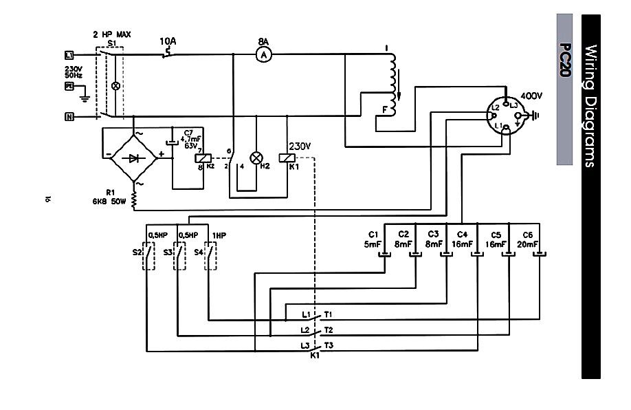

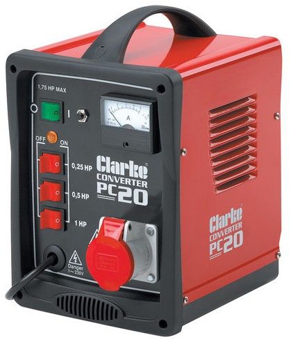

                                                  a search of Clarks own web site for the Clarke PC180 gave no results
                                                  but Machinemart has a link to the manual for the Clark PC 20 . PC 40 and PC60 converters
                                                  all have a autotransformer to step up a single phase 240 V supply to 440V
                                                  to run a 3PH 440V motor
                                                  and have 3 switches to switch in the required capacitors for various motor horse powers
                                                  I'd expect your converter to be very similar to the PC20
                                                  Edited By john swift 1 on 26/07/2013 23:19:43

                                                      @johnswift1
                                                      Hi Alan
                                                      looking at the motor terminals I've just noticed an extra white wire on the "N" terminal
                                                      that looks like you have 7 wires connected to the motor windings and not 6
                                                      and therefor does not match the connections on the lable for the 440V star connections or 240V delta (mesh) options
