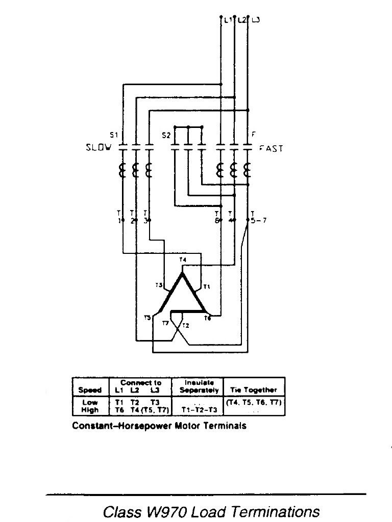

                Hi Alan
                if your converter is like the PC20 you should have 440V between terminals L1 and L3 on the 3 phase socket without a motor connected
                the problem is how your motor windings are now wired , the extra wire on the "N" terminal is unusual
                your motor is 4 pole single speed motor (1425 RPM) and would originally had 6 wire connecting to the windings
                the only diagram I've found with 7 wires is for a two speed motor
                Edited By john swift 1 on 28/07/2013 09:30:43
