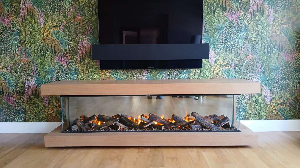

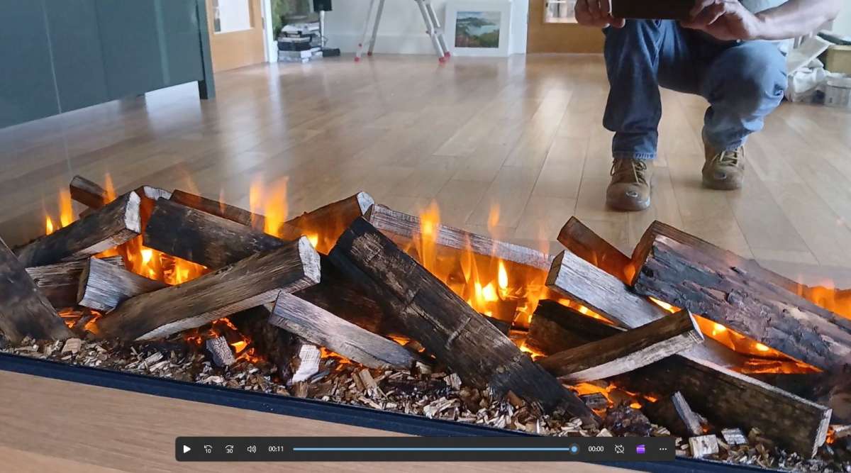

                I’ve been out doing real work, luckily the flames are not real although the LED mirrored screen they are on is very realistic. The oak top and lower surround fitted OK Though a bit warm moving the 1900mm long, 100kg fire about on my own let alone the veneered fireproof MDF.
                20260527_104327
                real flame

                noel shelley
                  @noelshelley55608
                  That’s very neat Jason !  Noel.

                    that fire effect is amazing and I was still lighting the living room wood burner until Saturday but in practice barely look at the flames for more than ten seconds an hour, in 1 second glances to check the fuel state.
