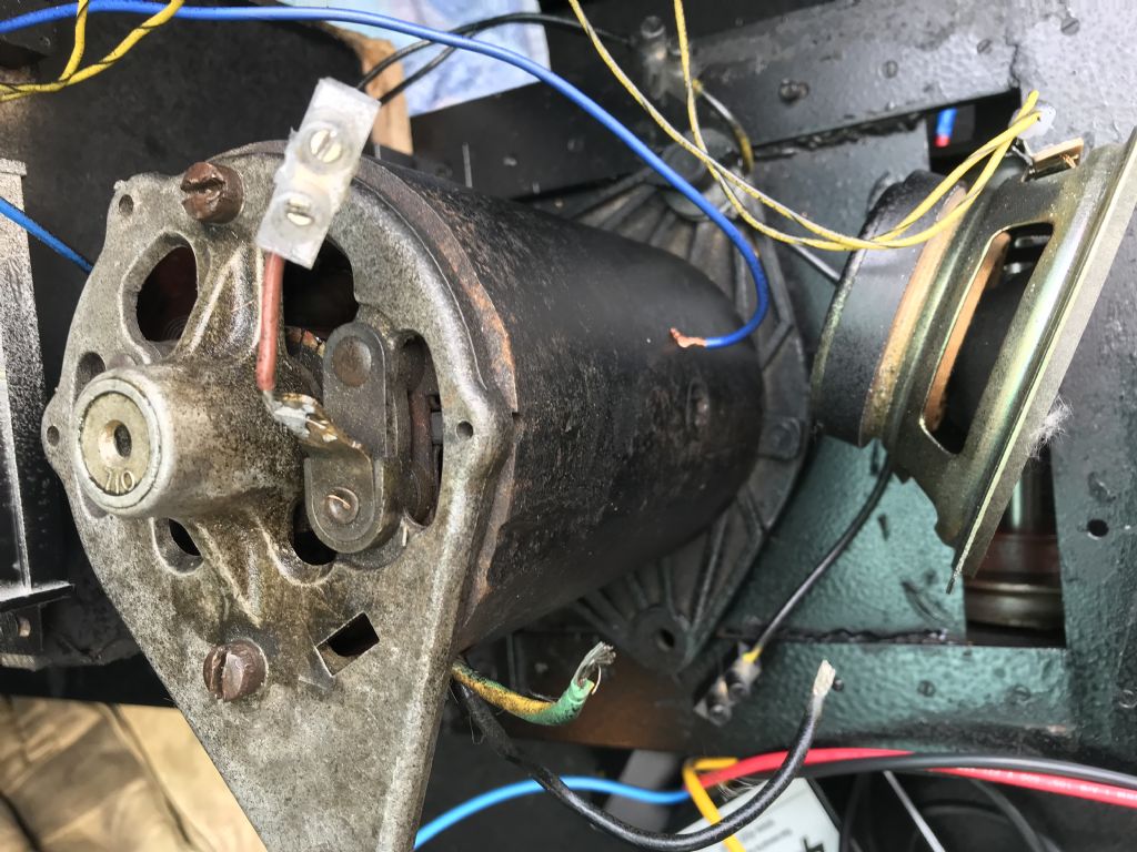

      Hi, I am trying to wire a controller to this motor. The controller as a live and negative outlet wire . But the motor as three wires. Can anyone please let me know which wire connects to which. Thanksf1f905c0-df76-4eb8-aa29-47e10b6b51e7.jpeg

        Andrew Tinsley
          @andrewtinsley63637
          Well for a start, it isn't a motor. It is a 12Volt car dynamo (or possibly 24volts if it is off an old lorry). So none of your standard mains or dc controllers are likely to work.
          In the distant past, I used a dynamo in place of a 12 Volt motor and although it worked, I was a bit dubious as to long term reliability.
          I would recommend that you don't be a cheapskate and get a proper 12 Volt DC motor. There are plenty around, you just need to know what you are looking for.

            Andy Carruthers
              @andycarruthers33275
              Assuming these are the 3 wires:
              Brown – Probably +12v
              Black – Probably 0v
              Yellow / Green – Earth
              Measure resistance between Brown and Black, should be a few (tens?) ohms
              Assuming low – but NOT zero – resistance, try putting a car battery across Brown and Black, just touch the terminals and see if the motor twitches in the right direction, if not, reverse the wires and retry

              Howard Lewis
                @howardlewis46836
                Looks like a Lucas C40 Dynamo. This is a shunt wound machine, where the supply to the field windings is used to control the output.
                This would not be really suitable for traction purposes.
                A Series wound motor would be needed, to obtain the torque needed for starting.
                Howard
                #427419
                  A dynamo that's had a few adventures by the look of it!
                  It's possible it's a positive earth dynamo, ie the + and – are reversed, but assuming it's negative earth:
                  The Brown Wire is on the D Terminal, this is the main Plus winding.
                  Judging by it's length, and contrary to Andy's suggestion, I suspect the Green/Yellow wire once connected to the F terminal,. This is missing from the rectangular hole just below D.
                  F is the Field connection used to magnetise the dynamo; it's normally connected to a Regulator which alters the field current as necessary to maintain a steady 12V out whatever rpm the engine is turning.
                  I've never tried running a dynamo as a motor but guess the F wire and D terminal should both be connected to +12V from the battery. The dynamo might motor without energising the field, but at low power.
                  Three wires is a bit odd because dynamos are normally earthed by bolting the metal case to the chassis. I guess someone has bodged this example in the past and the black wire is earth, ie to be connected to -12V from the battery.
                  Do you have a multimeter? A cheap one would soon remove all doubt.

                    Nick Clarke 3
                      @nickclarke3
                      Older 3 brush dynamos can be converted into motors quite easily. As has already been pointed out this id a Lucas 2 brush dynamo which cannot be used as a motor without major changes, and even then they are not very good as motors.
                      As the dynamo appears to be in a loco chassis – Has it run in the past or is it a new installation? If a new installation I would not start with trying to use this dynamo as a motor. If it has run successfully in the past to bring three wires out (+the body as earth, which could be either positive or negative) you need to know exactly what was done to the device, up to possibly a full rewind and separate excitation of the field coils, before you can attempt to find the correct connections.
                      Alternately try a few different ones and be prepared for it to do nothing, burn out the device or controller, cause a fire or work – those are the options.

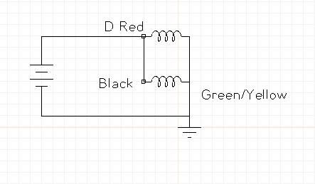

                          Posted by terry callaghan on 04/09/2019 17:08:58:
                          Hi, yes I do have a multi meter. There are two of these dynamos wired so that one works forward and the other for reverse. I only wish to wire up one dynamo. So Dave if I am reading you correctly.both brown and green/yellow wires to positive and black to earth.
                          Yes, I think this is it.
                          But check with a multimeter in case I'm wrong and Andy is right.
                          It might be this:
                          Measure ohms from Red to Black and then Green/Yellow to Black. If I'm right, resistance Red to Black will only be the value of the main winding, and Green to Black will only be value of the Field coil. If wrong, and green is earth and black the field, then the resistance will be that of both coils in series, which checking the other combinations should reveal is higher than two lower readings. Sorry if that's clear as mud!
                          Edited By SillyOldDuffer on 04/09/2019 18:18:25

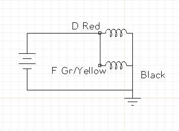

                            Robert Atkinson 2
                              @robertatkinson2
                              We need more measurements than that
                              in addition to the two readings you have can you do
                              Black to Brown
                              Case "ground" to Green / Yellow
                              If there is a reading between case and Green / Yellow also measure case to brown and case to black.
                              The machine probably originally a dynamo may have been modiifed in the past, we can't be sure.
                              Basically here are two ways to wire the basic motor windings- series or parallel (Shunt) as you only have 3 wires it appears that only parallel is possible unless there is also connection to the case (as there would have been in the original dynamo).
                              The other thing to sort ou is the direction of running, if you reverse ONE of the windings the motor will run the other way.
                              There is an extra decision which is where to connect the speed controller. while it may seem opvious to connect it to both field and armature, there is no reasion why it should not be connected to just one with the other connected to the supply all the time the motor is running.
                              If you want to try different combinations without fireworks get a couple of 55W headlight bulbs and put one in series with two of the (positive) motor connections. This will limit the current to safe levels. The motor shaft will have to be disconnecte from any load of course.

                                    Hi Robert, here are further readings.
                                    Black to brown. 3.9
                                    ground to green/brown. Ol
                                    case to black. 1.3
                                    case to brown. Ol.
                                    thanks, michael

                                            Hi Michael,
                                            I'm just on my way out and haven't had time to think over breakfast, but can you clarify what's meant by:
                                            ground to green/brown – is that a typo for "case to green/yellow"?
                                            And
                                            Ol. (is that zero ohms?)
                                            For the avoidance of doubt would you do the full set of measurements
                                            Black to Green/Yellow,
                                            Black to Brown,
                                            Black to Case,
                                            Gr/Yell to Brown,
                                            Gr Yell to Case,
                                            Brown to Case,
                                            Got a few busy days ahead but should be able to look at the results this evening.
