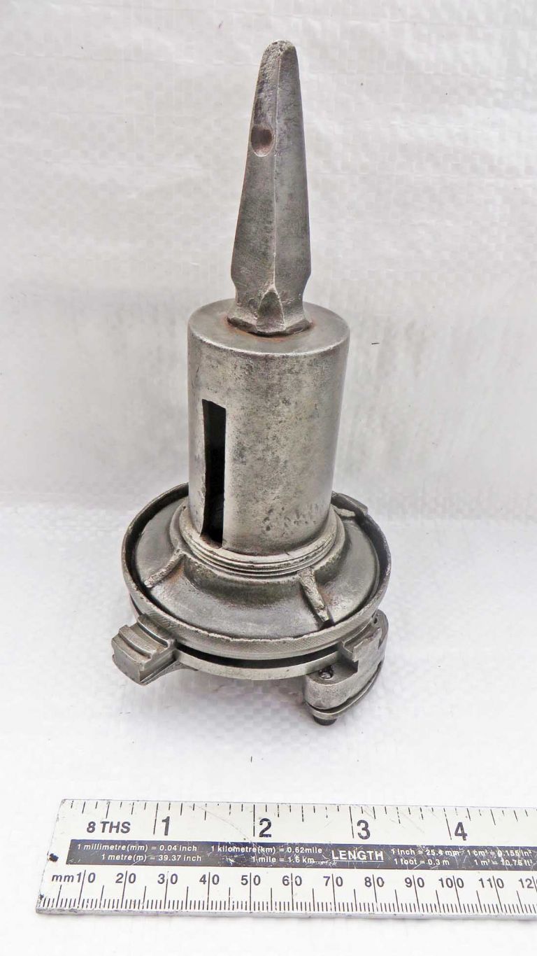

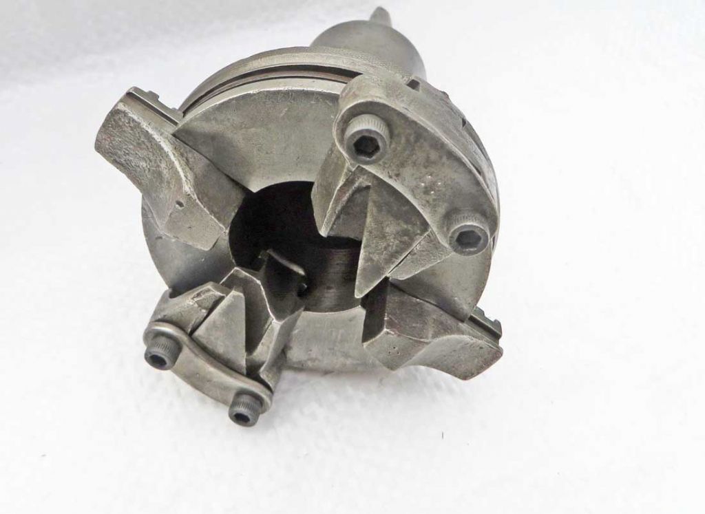

      Hi All,
      I am not often stuck with woodwork tools but bought this in an auction box of tools with just a bad photo to go on.
      I thought it was a a chair makers spindle rounder by SWAN of the USA but it isn't!
      I cannot work out what it is for, can anyone shed any light please, there are no apparent makers marks?
      Cheers, Martin

          Carpenter myself but never seen anything like that. The fact it has a tang may be suggests it’s use is via a Carpenters brace and possibly used to lock onto some form of spindel for further grip/torque? Keen to know myself.

            External threading tool?
            #531036
              Dowel Cutter?
              #531038
              MichaelR
                @michaelr
                Could be a tool for forming tenons on dowel spindles, does it have cutting blades ?
                Michael

                  This says it's a tennon cutter
                  #531040
                    This also has it as a Swan hollow auger for cutting tennons
                    More swans

                      Hi Jason,
                      You have cracked it.
                      Michael.
                      #531047
                        Not sure if I have because Martin says it is not one of those?

                              Hi Jason,
                              You have it just right!
                              I have never seen one of these and it did not click in my brain that it is for round parallel sided tenons.
                              The "normal" Swan cutters make different sizes of conical ends on spindles, they come in set sizes and rarely in adjustable form a bit like the one shown.
                              They are almost always clearly marked SWAN USA but not this one unless it is somewhere when I take it apart?

                                It is a tenon making tool for use mainly by wheelwrights to put round tenons on the end of the spokes to go into the felloes
                                Look at this about 10;30 into the video

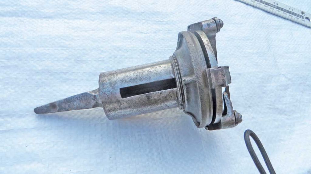

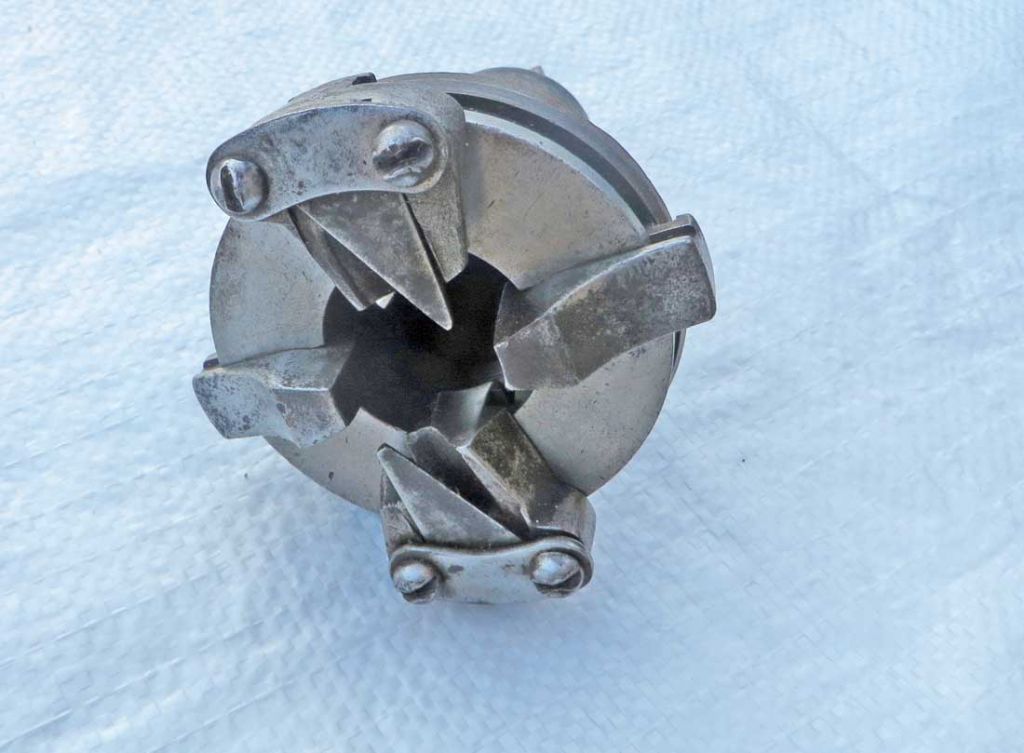

                                      Hi all,
                                      I have dismantled the unit and sharpened the cutters, replaced the very worn cutter locking screws with 3/16W cap screws (kept the originals to go with it!)
                                      The main thread is very fine and required careful removal but after degunking all the rubbish now turns easily and smoothly. The adjustment mechanism is just like that on a scroll chuck, again all crudded up but now free turning.
                                      Absolutely no sign of any makers marks! Just numbering of the scroll parts.
                                      Be interesting to see how it does.
                                      Cheers, Martin
